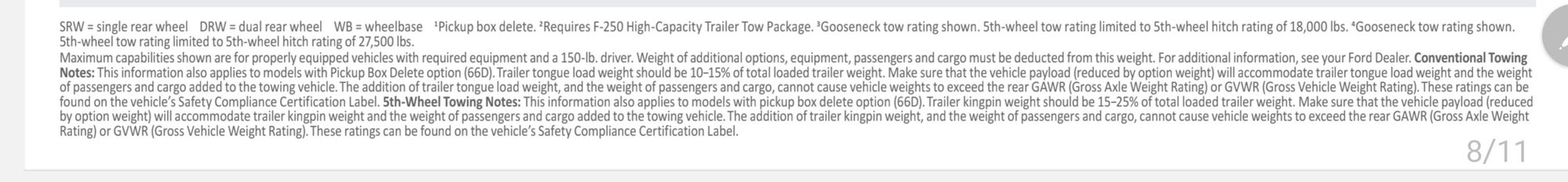

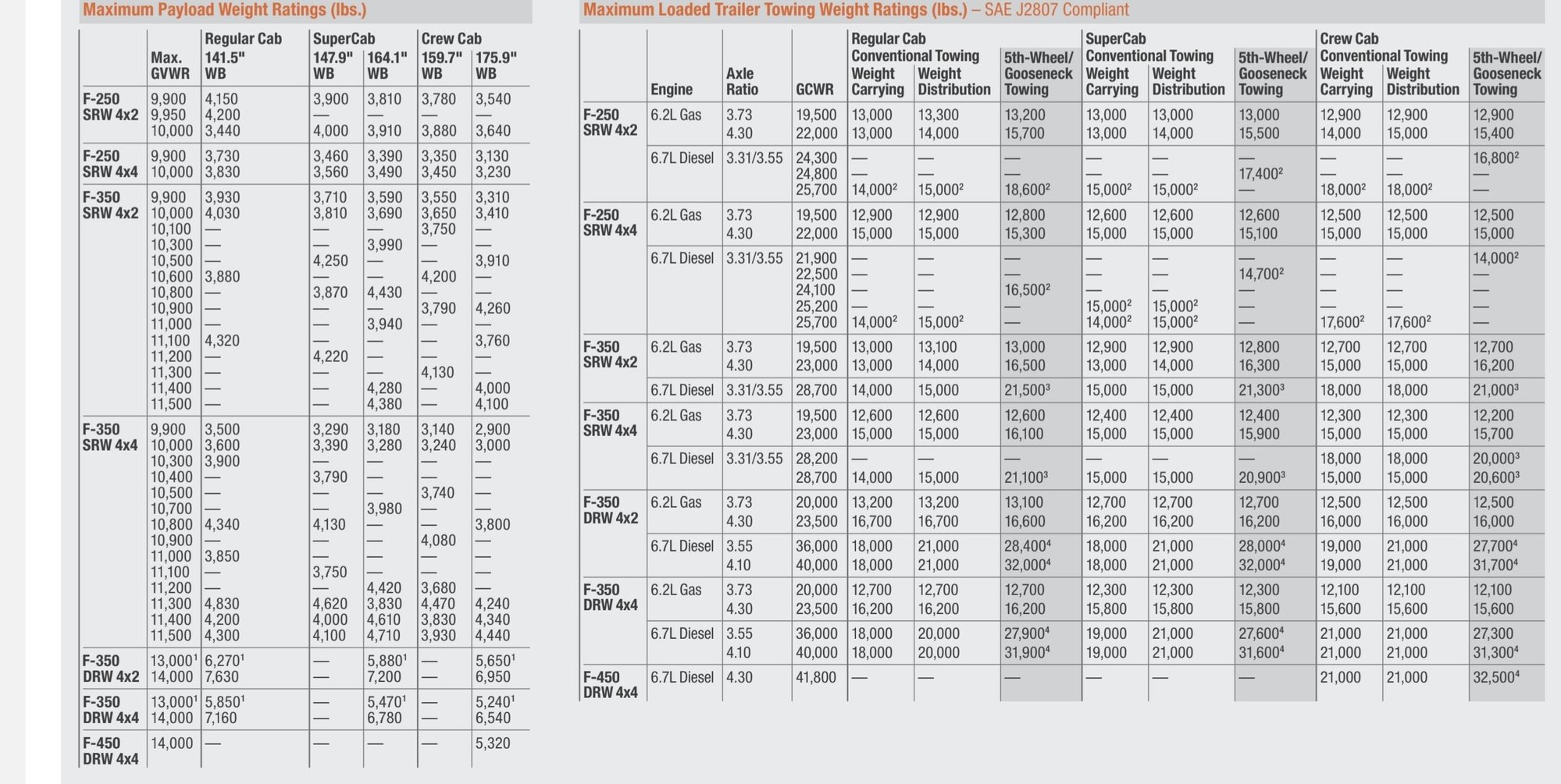

Guess again... from the 2017 Ford brochure.
Read it again, 18K is conventional towing, 5th wheel is 16.8K on a crew cab.
I did..... DID YOU!

OP, what truck do you have? Reg cab?
If so you see the #2 next to the weight in the image I posted. Do you have that package?
