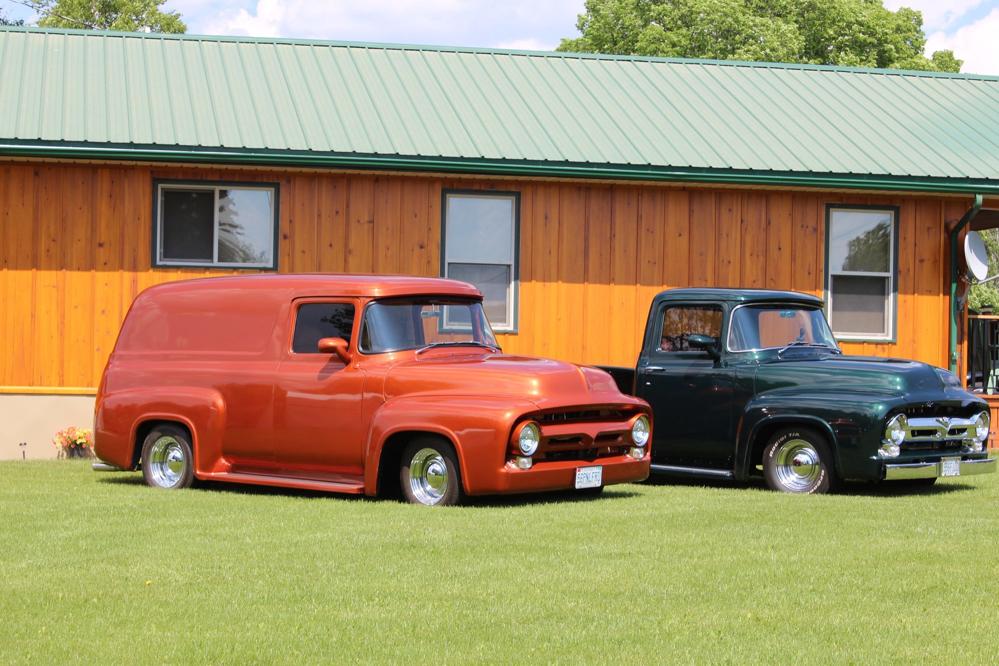

I haven't driven the panel much the last couple years because I'm hoarding new parts for the one I'm building now for lack of space to store them. Took the panel out a couple days ago and carted all the stuff with me...lol

Originally Posted by 67nukeford
I am just in love with both of these, John!!!!
Makes three of us Pat, the wife loves them too...lol

Originally Posted by GLR
That's the trouble I have with my trucks with a cap on the bed. Make great storage areas.
I was going to store the panel in my storage tent over the winter to give me more space to work on the Mercury but chickened out in fear of mice taking residence so on the better days I just back it out depending what I plan to do..one of the reasons this project is taking so long..
