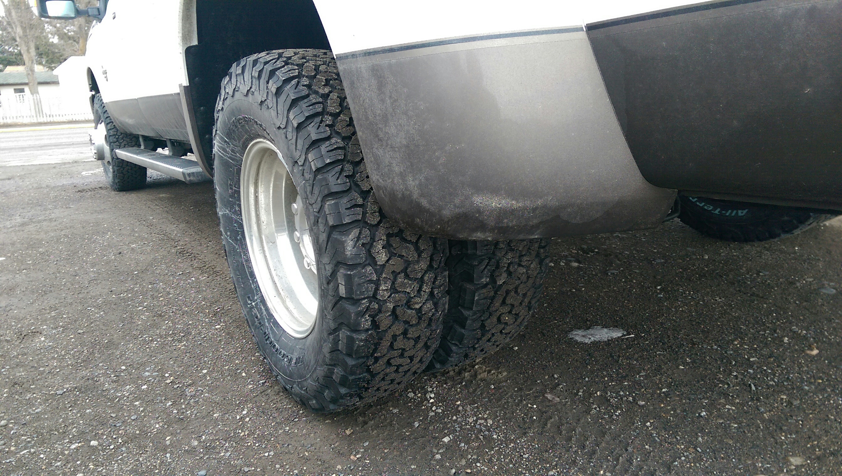

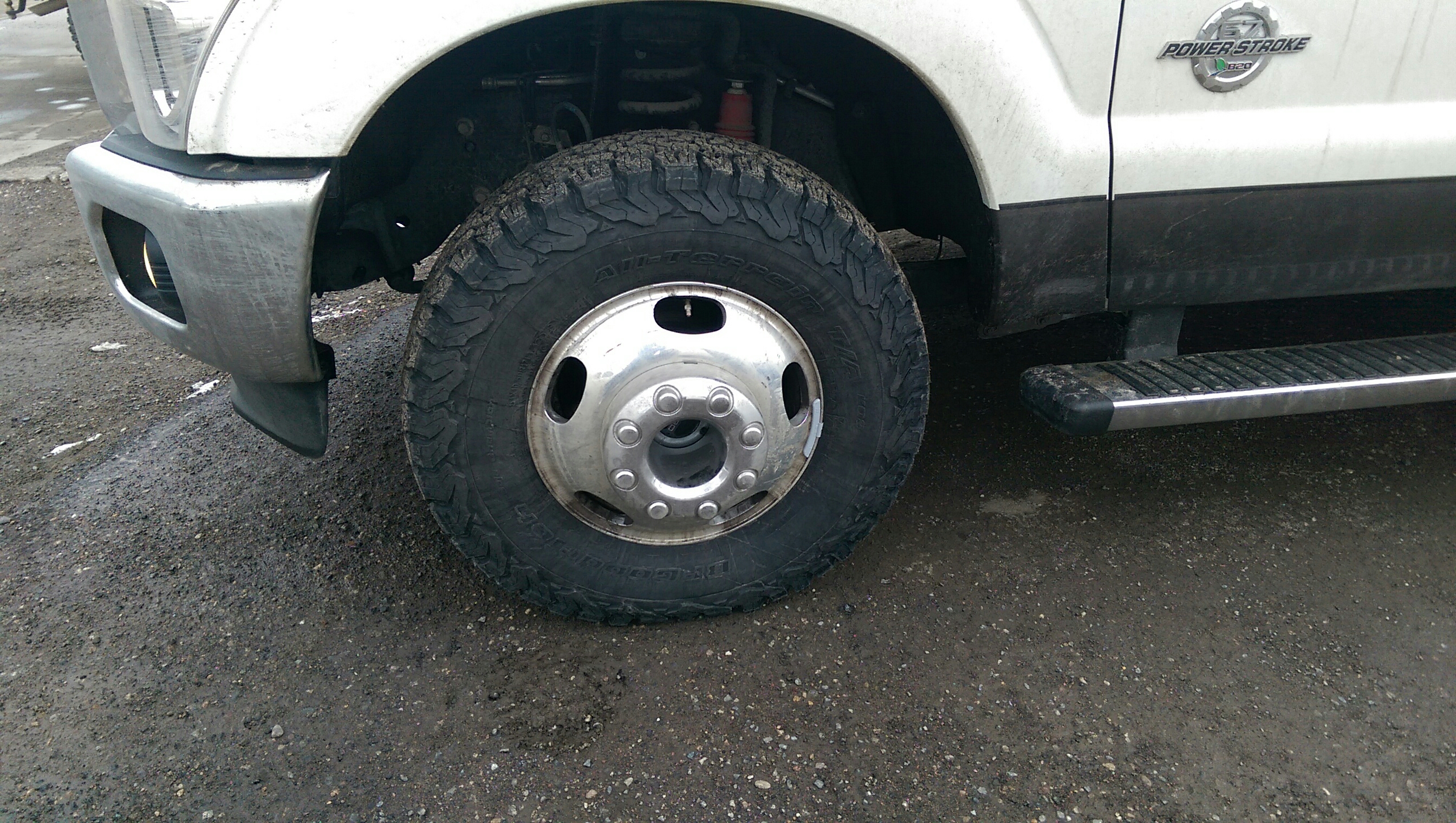

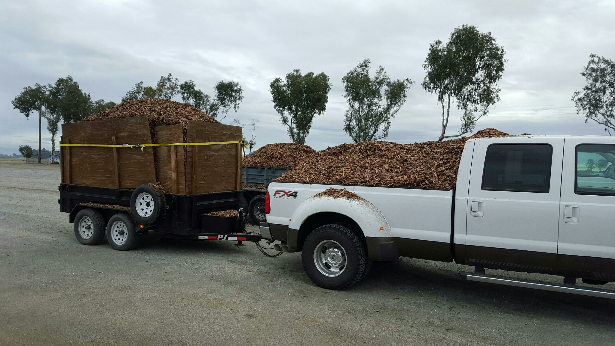

I am running BFG 34*10.5/17. No clearance issues. No spacers.

Hey ZooDad, I'd like to run BFG's on my truck when I wear out the factory rejects that came with my truck. How much clearance do you have between the duallys?
Old Apr 9, 2016 | 08:06 PM
  #1447
ZooDad's Avatar
ZooDad
Retired guy fixn stuff
Joined: Mar 2009
Posts: 3,227
Likes: 1,241
From: East TN
Joe/GA,
As it sits right now. 45# unloaded.
.615". Give or take
When I tow I run 60#. I will measure next time I'm hooked up.
I have considered .500" spacer just to open it but have not had the need. I I/R temp the tires when I tow. No difference from either rear vs front.

My goodness, how did you tarp all those chips? Without a badge in my wallet, any LEO around here would send me walking home if I had an uncovered load like that.
Depending on design, some 1/2" spacers might do more harm than good... since there isn't enough room on the hub land for the (thicker) aluminum wheel and a spacer. The aluminum wheel would be forced outward to "float" over the non machined tapered part of the hub. Since our wheels are hub centric, not lug centric, the outer wheel may not center correctly with the inner wheel.

We tarped it right after the photo.
And yes that's one thing I am looking into "IF" I look more into spacers. But again, I have not had the need.
