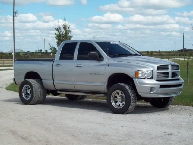

Just looked up the Eagle 058 to see what all the fuse is about them and found this picture. Check out his front wheels they are not the regular wheels you see on the front of a dually.

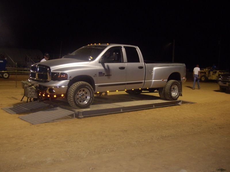

Here is another one

Both pictures are typical of sled pull trucks. The top one started life as a dually and they just unbolted the front spacers to run SRW wheels. The bottom one is just an SRW truck with duals slapped on the back. Not going to carry any weight and most likely only run like that at the track so touching tires is irrelevant.
No issue with running SRW wheels up front except for the fact that you'd need 2 spares...............
