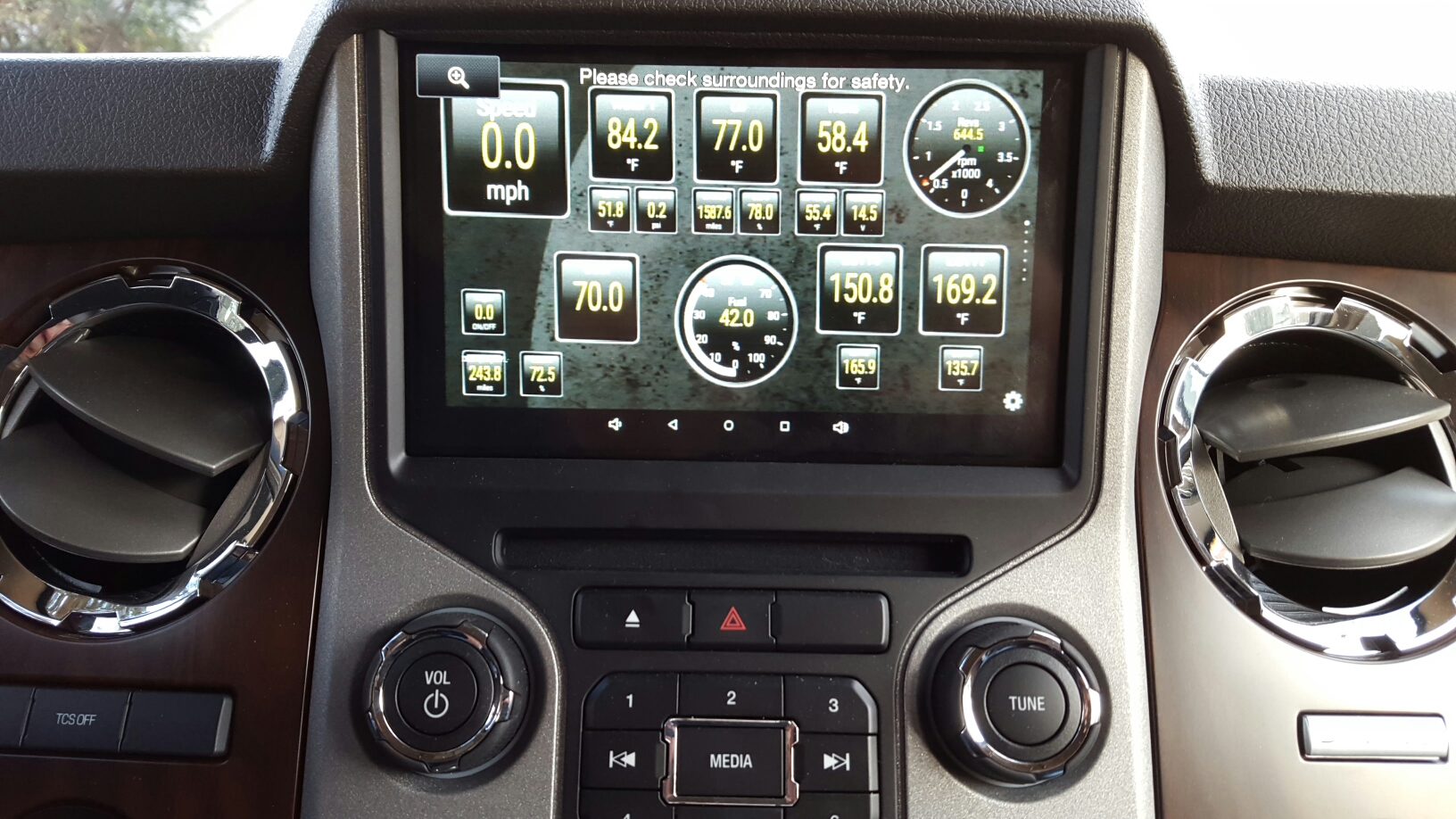

You mean something like this.
Attachment 138578
So what is all involved in making this happen? Which scanner and how did you get this to appear on the truck screen? What was the cost for all the parts and pieces? Does the radio still work while this display is on the center truck screen? Is this a scanner (warranty still in place) or a tuner (never going to visit my dealer again)?
Very cool.

Bruce
OBDLink MX Bluetooth connector. $80 Amazon
Torque Pro Android App. $8 Google store
7" Android tablet $70 Amazon
MyTouch Lockpick Air $429. Oemautopartsco.com or coastal tech
(Looks like they are out of stock)
I wanted stand alone that's why I did not use a phone. I also wanted to be able to stream content that's why I got the air model.
My main purpose for getting the air was for additional cameras, but then found the thread on torpue pro. It's in the 6.7 diesel section.

Ah yes...
How did you manage to make that happen?
Is that the Palmer Engineering Application?
How does that affect your ability to get to other touch functions like NAV, radio etc?

The Lockpick My Touch Air is an interface for the NAV/Radio. Everything still works. You have a remote that activates features of the Lockpick.
The app is Torque Pro through an Android Tablet "Screen Cast" to the Lockpick.
There is a great thread about Torque Pro.
I am putting together a comprehensive post about the total install. Work has been pretty busy as of late. Sheriff One - Down

I'm interested in this as well. Nice!
