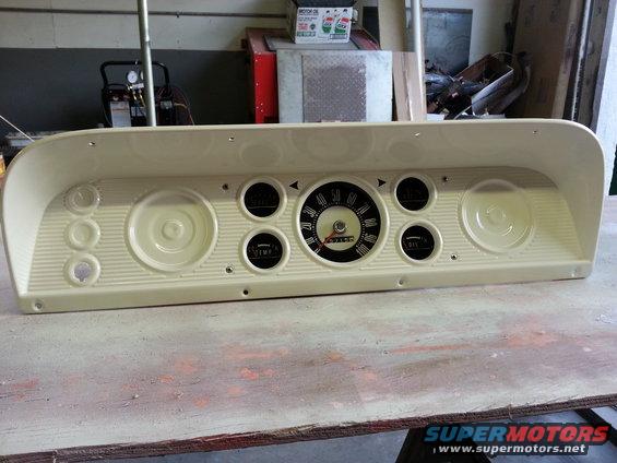

I felt like working on the interior recently and sanded and painted both the door panels (still looking for a set without the chrome and black trim) and one of the F500-F700 instrument clusters that I scored a couple of weeks ago. I took the whole cluster apart and painted the black surround and also painted the needles:

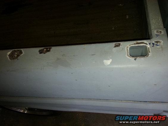

Next on my list was to fill in a bunch of holes in the bed rails from PO's and also to fill in the stake pockets:
