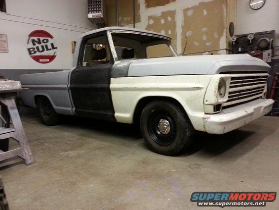

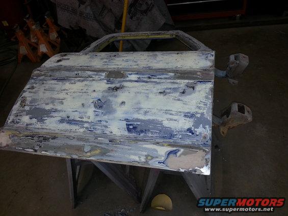

Well, instead of working on the engine/transmission yesterday I decided to do more body work.
I got all of the polyurathane body mounts installed along with all new body mount hardware. I also spent some time lining up the whole front end including, hood, bumpers, fenders and grille. It was quite a chore.
I also started stripping the passenger side door of it's 6 layers of paint. I knew the bottoms of the doors needed some work and the previous owner bondo'd over the trim holes without filling them with weld first.
In preparation for the door stripping, I bought a set of door skins and planned on doing both doors. After looking at it more once the paint was removed, I decided to patch the doors with some sheet metal instead of installing the complete skin. I'll also fill in the trim holes with my Mig welder before laying some Rage Gold over the holes. I'm also going to do a separate write up on how to do this so you can see the process.
After doing the outside of the doors, I'll also strip the paint off of the inside of the doors. I'm not looking forward to doing the jambs.
Pics of the doors after partial stripping and after a final strip and a once over with some 80 grit on the DA sander.

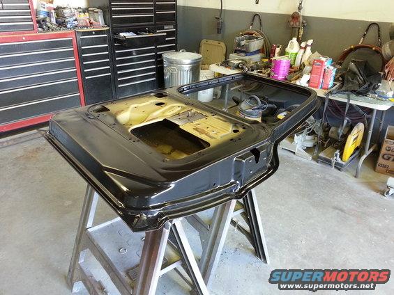

Sometimes it seems like it's a never ending project, but I have to keep motivated and just knock off one task at a time.
I cut out the bondo'd over rust spots on the bottom of the doors (both inside and outside) and welded in new sheet metal. I also filled all of the trim holes with the Mig welder too. The previous owner just filled them with bondo.
Also stripped off the 6 layers of paint from the jambs with Aircraft Paint Remover (what a job - it only takes off one layer at a time). I must say it was a real PITA and very time consuming. I wish there was someone around here that did media blasting.
Gave the door a final sanding with 220, wiped it down with wax and grease remover and shot 2 coats of black epoxy primer on both sides to seal it up.
Mo' betta' pics.....

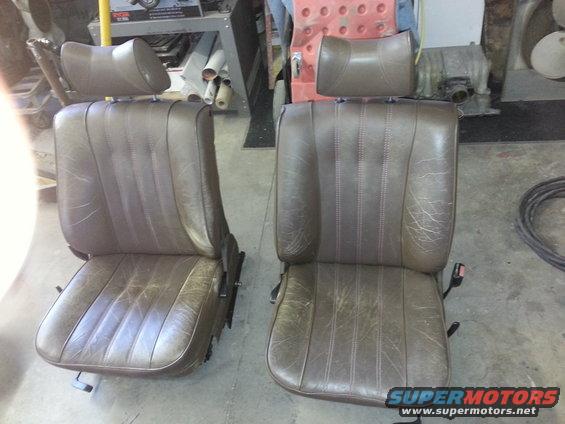

Got some more work done on the truck over the last couple of days and also found a set of nice Buffalo hide leather seats out of an 82 BMW 733 that I think will match nicely with the Wimbledon White paint that I plan on for the truck.
They are worn in and have some cracks and creases and they remind me of bomber jackets.

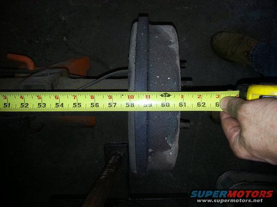

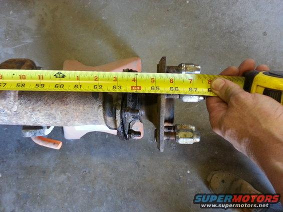

I took out the OEM 9" rear and replaced it yesterday with one from an 80-83 F100. It was not as easy to find as I thought and I had to drive an hour and a half away to get one from someone that had a bunch of Ford parts at his house. I paid a little more than I wanted ($250) but I had no choice if I wanted to move the project forward.
When I got back I stripped off all of the old brake drum parts (I'll be installing Ford Explorer disc brakes) and rolled the rear under the truck to check for fitment.
Notice in the pictures that it has the correct 5 x 4.5" bolt pattern and it's a little over 65" inches wide (which is perfect for the backspacing on the Crown Vic wheels I'm using and matched the WMS - WMS of the Crown Vic front end).
I was pondering what to do about the leaf springs last night as they have a lot of arch to them and would require me to move the perches up pretty high into the bed without using blocks between them and the bottom of where the new spring pads will get welded onto the new rear.
I'm going to look in the junk yards and see if I can find some flatter leaf springs. This will help a lot with the space between them and the bottom of the axle, and I won't have to move the perches up so much.
More pics of the new 9" mocked up. There is only about an inch of clearance between the top of the tube and the frame. A "C" notch is in the plans as well as a custom shock crossmember.
