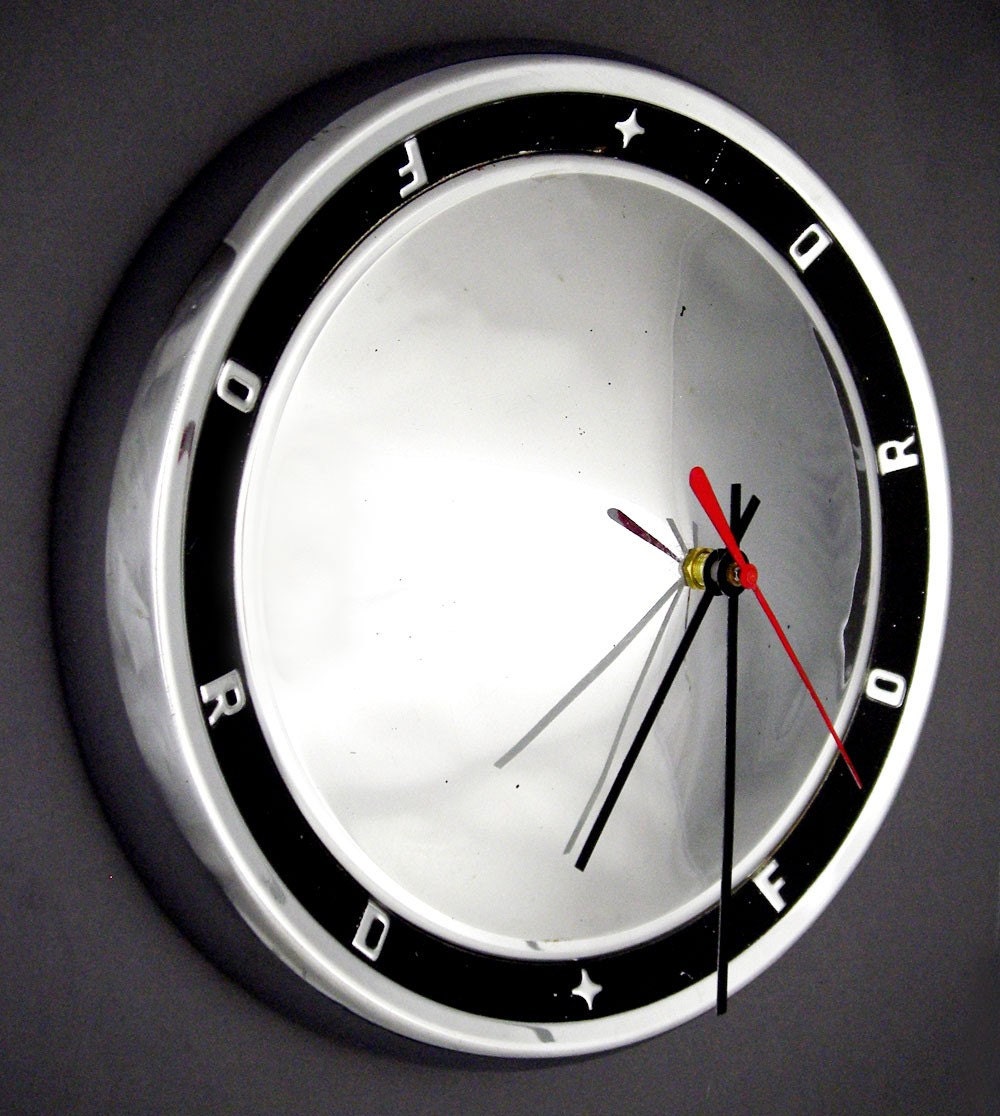

Originally Posted by MIKES 68 F100
I like that but I don't want to mess with my spares.
I should have grabbed those old Dodge and Ford hub caps that I saw in the junk yard last week.
There was one old Dodge one and a couple of mis-matched Ford ones. Maybe I'll go back and grab them.
That clock is a great idea.

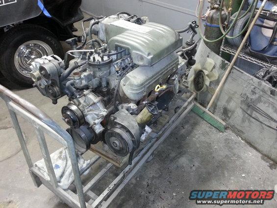

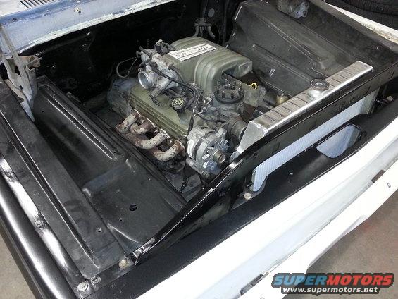

Ok, I've been very busy working on a 56 Olds lately and have not had too much time to work on my own truck.
I did manage to get the engine/transmission laid in place for engine mount mock-up. It's sitting in the chassis really low right now and I plan on leaving it that way. The lower the center of gravity, the better it will handle.
Here are some pics of the engine/trans install:

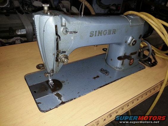

Like I said in an earlier post, I've been thinking about how I'm going to finish the interior and have some ideas.
I've always wanted to try my own upholstery, so I went ahead and found some good ol' sewing machines that should get the job done.
The first is a 1930 Singer 31K20:
The second machine that I acquired is a 1961 Singer 31K5:
These machines do a great job, but the pitch of the stitch was just a little too short and they don't handle a big enough thread weight for my liking. I'm not going to use red thread, it was only used so that you can see it better in the pics:
I finally realized that I would have to spend some coin and get a machine with a walking foot to do the job correctly. I then stumbled upon this Pfaff machine at an estate sale. It was purchased new by a gentleman back in 1963 and used in the basement of his house to do upholstery work. It's one of the BEST machines on the market and got a smoking deal on the machine, table, tons of extra walking feet, thousands of heavy duty needles and supplies. This machine lasted his lifetime and it will most definitely last mine as well.

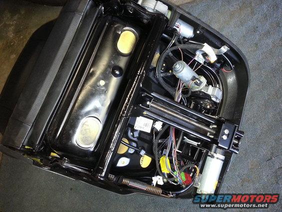

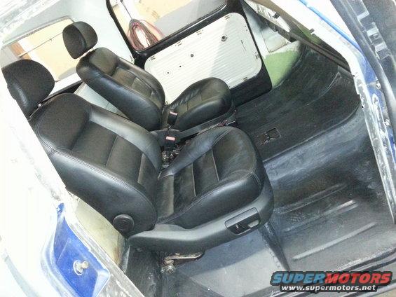

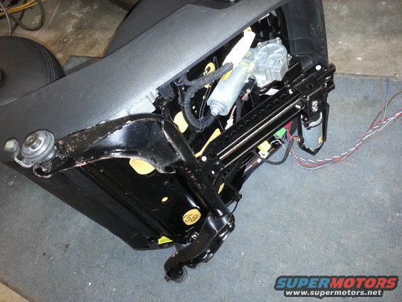

After cleaning out some of the dust in the interior, I took out the BMW seats that I had originally found and did some work on getting the Passat seats ready to install.
The Passat seats are power, heated and leather. I'm going to build a custom center console to incorporate space for a 10" subwoofer, the shifter handle and some cup holders.
I first started out by cutting off the factory slide mounts:
That left me with a nice flat surface and a great place to weld on some new rear mounts:
A light coat of semi-flat black to keep them from rusting for now:
Sitting flat on the floor of the truck:
With the 1980's tilt column and 79 Mustang wheel wired in for mock-up:

Please take and show pics of the mounts!
