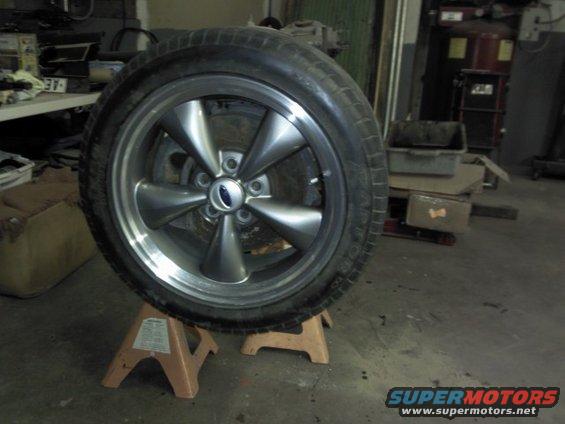

So far I have been gathering parts and re-doing the front suspension.
Here is a list of what I have acquired or installed:
2005 17x8 Mustang Bullit Wheels - $250 off Craigslist
2003 Crown Vic front suspension (with Police Intercepter Package) -$400 pulled at local junk yard
2000 Tremec World Class 5 Speed - $100 off Craigslist (same as 93-94 Cobra)
1991 5.0 HO Engine with 67k miles - $450 complete off Craigslist with computer and harness - (I heard it run first)
1978 F150 Automatic tilt column (not going to use since getting the Tremec) - $20 local pick and pull
NOS inner fenders - found in a barn via Craigslist - $300
OEM rust free fenders from California - $75 each plus shipping
OEM rust free grille from California - $100 plus shipping
OEM rust free radiator support from California - $100 plus shipping
OEM bumpers from a local junk yard - $50 each from local junk yard
OEM rear window from a local junk yard (hated the slider) -$30 local pick and pull
Here are some more pics of the front suspension, wheels and sheet metal installed for mock up:

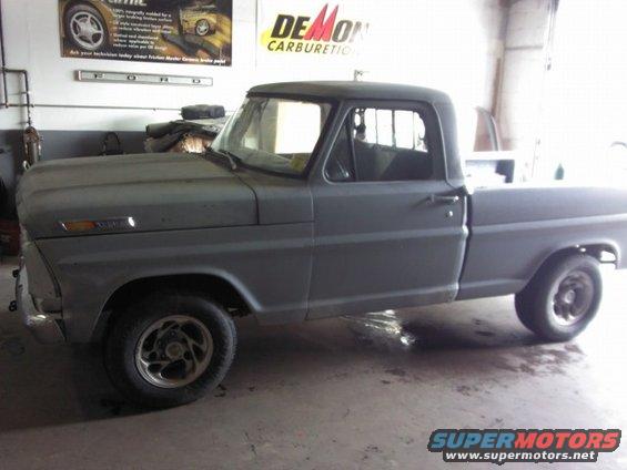

And here is how it sits right now:

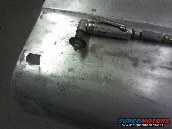

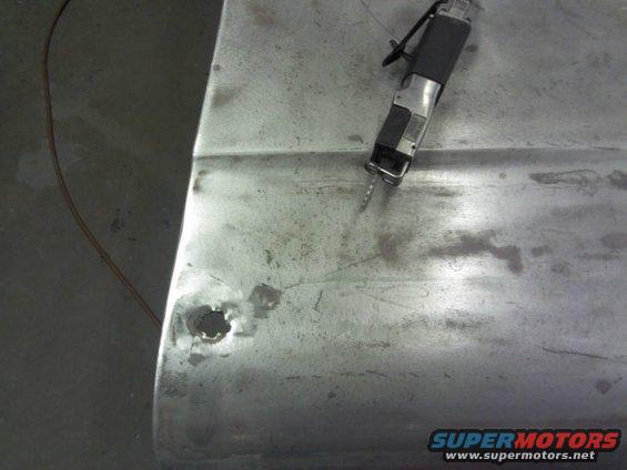

More pics of the hood after stripping off 5 layers of paint, cutting and welding in a patch for a big hole near the back edge that was covered over with bondo.

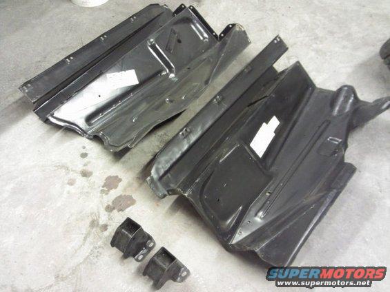

Brand new old stock inner fenders:

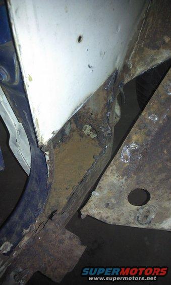

One of the PO's decided to cut the frame. Why? I have no idea. Maybe to get the starter in without removing the Y pipe?
In any case, cut out the old, make a cardboard template, weld in the new:

I'm not sure what rear I'm going to use yet. I'm considering an 8.8 with a disk brake swap. I'll re-drill the axles for the 5 x 4 1/2 bolt pattern and plan on using Exploder rotors and calipers.

Hood side emblems are from a 1968/72. 1967's didn't have yellow reflectors.
Painted grill pictured in post 5 is from a 1968/69 Standard Cab.
1967/72 F100/350: TWO different radiator supports, one was only used with the Super Cooling Radiator...has a larger opening radius.
Old Mar 24, 2013 | 09:12 AM
gangstakr's Avatar
gangstakr
Joined: Dec 2004
Posts: 4,651
Likes: 60
From: Hemet ca.
Also in the second picture, the picture showing the flag on the headliner, it looks like the passenger door has a door lock push/pull type. This wasn't on a 67. The doors could have been swapped. Who knows.
