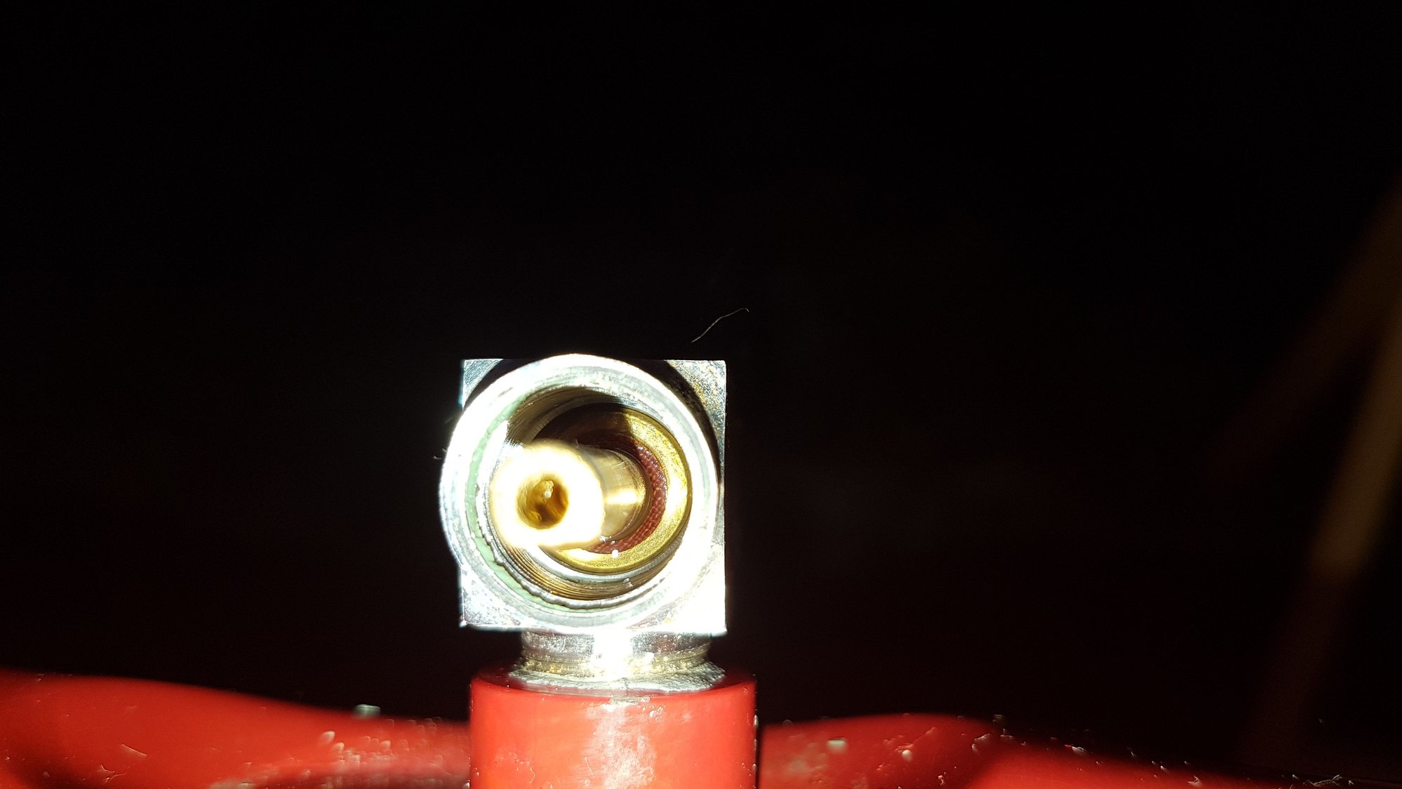

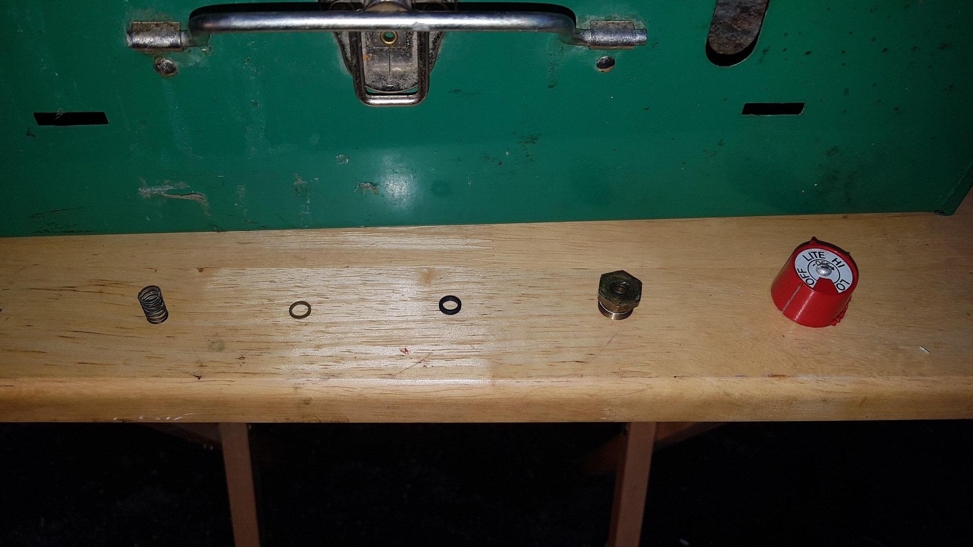

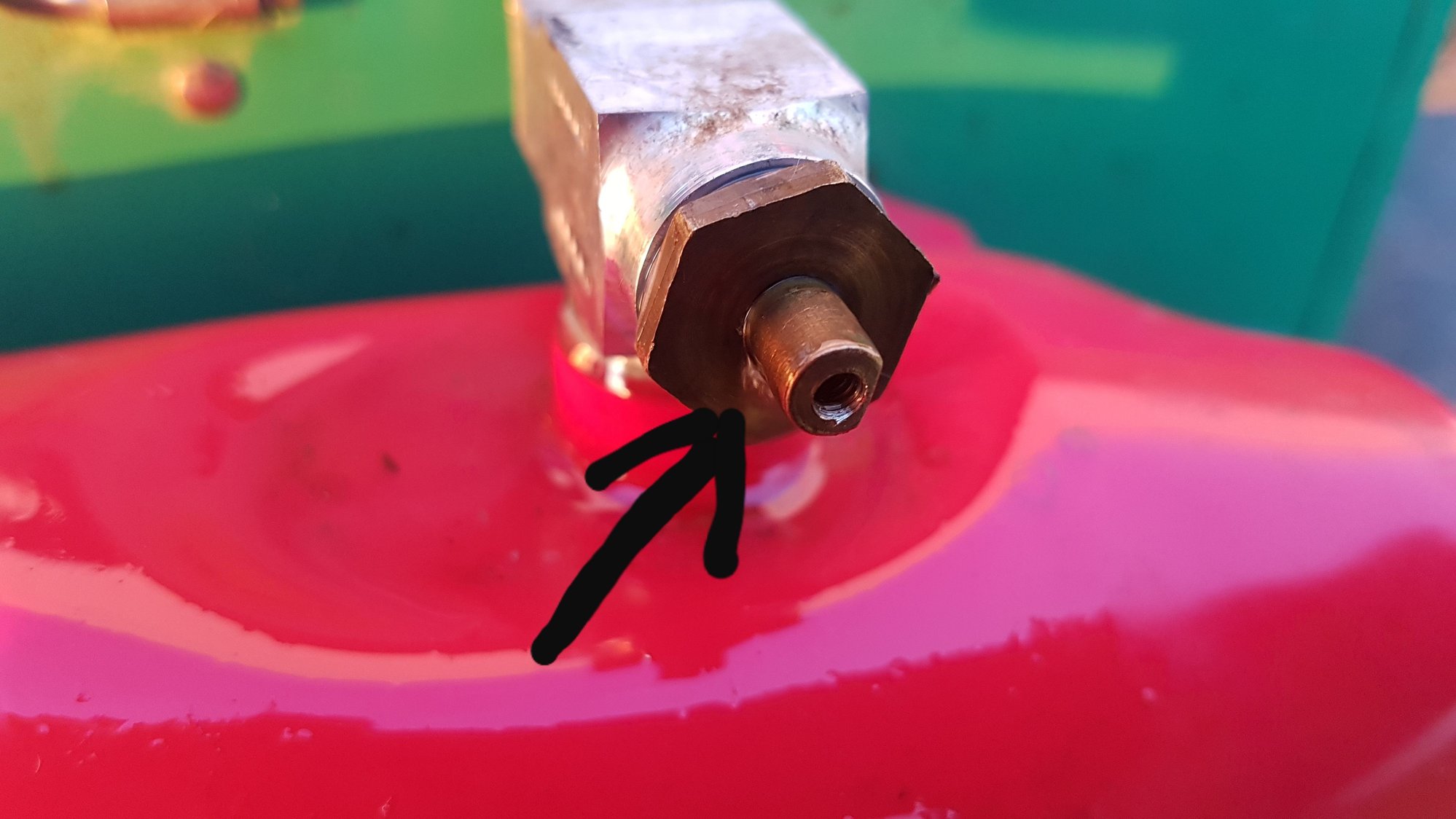

Maybe you guys can help me. I have this old Coleman stove that's not working very well when I pump air into the fuel tank it starts leaking fuel from the regulator ****. I remove the **** and wrapped the brass plug with pipe thread but that didn't do anything so then I remove that brass plug and found in oring. I wrapped that o-ring in pipe thread as well and now it's not leaking anymore but I'd like to get a more permanent fix. I can't tell if there's another seal or o-ring in there

Teflon tape don't really work. There are oring kits.
Sean will be along soon and tell you what/ where to get, he's our resident expert on restoration
Welcome to the coleman pages!

Boy, I don't have one like that. All my stoves have graphite packing around the stem valve to keep the seal. Maybe ask the pro's at Coleman Collectors Forum or Welcome to the International Coleman Collectors Club - International Coleman Collectors Club.
