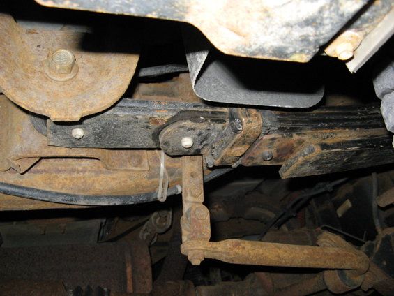

After more reading and thinking...The plan is to do v code fronts, and modded B code rears. I will keep the stock ex block. But had anyone done 3 springs from the old rear packs and transferred them to the B codes. Or done 2 springs and a chunk of the old overload.
I did that with mine. I used "F" codes from a 2005 F-250. The "F" codes have the same weight capacity as "B" codes, just more progressive spring rate.
anyhoo, I removed leafs from the original "G" codes that the Excursion came from, and installed them into my new "F" codes. Gained essentially 3" by doing this. Ride is great as well IMO
I only needed to add 1 leaf per side. I did NOT re-use the slapper bar. It gave me too much height (1" all by itself roughly) that I didn't need.
here is a pic of the leaf I took from the "G" codes. You can see where I had to remove a tiny section of it so it would could be inserted into the "F" codes.
This is not my truck, but it's the guy I got the idea from. You can see the leaf that was shortened...and the slapper bar. He got 4" of height.
with a little ingenuity and a few trial/errors...you too can get whatever height you are after. I've still got my "G" codes leftovers sitting in the garage and I believe I will be shortly going back into the suspension. I've got a serious hankering to upgrade my 35's for 37" rubber and my current 3" setup needs a bit more height
