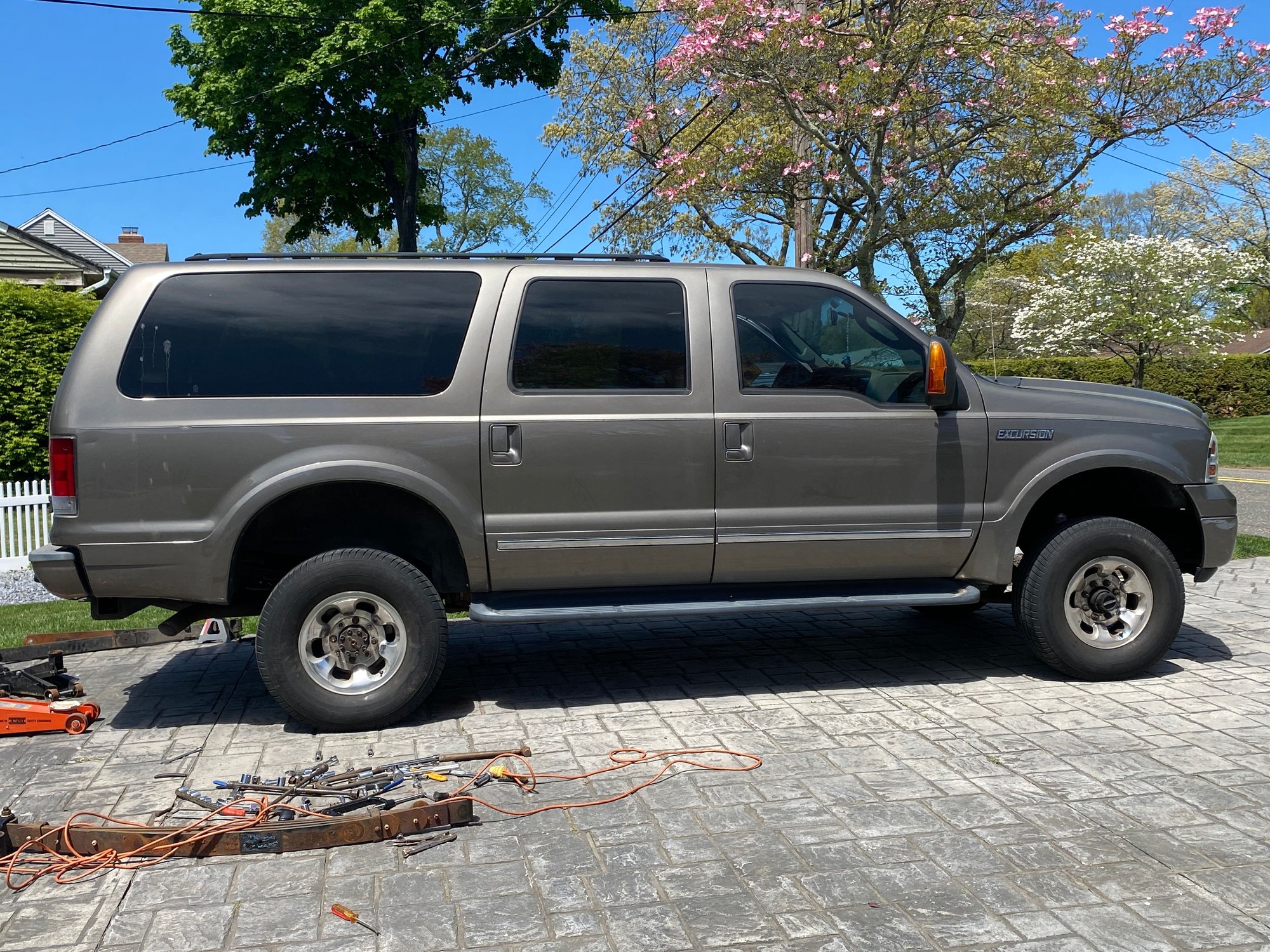

Finished….many thanks to all these threads!
Just finished
Start: 2005 V10 limited bone stock.
Passenger front 23.25
Drivers Front 22
Both Rear: 23.5
Finish:
V code swap in front
Typical modified B spring swap in rear, stock excursion block PLUS I added back in the excursion slapper spring with the bumper on the bottom of the stack. I did this not for function but because I knew I wanted a little more rake.
Final measurements
Front both sides 25.25
Rear both sides 27.25
Rake looks great…not too pronounced but noticeable. Looking forward to seeing with trailer load.
Ride and handling are extraordinarily better and different. Really thrilled with the result and the effort.
Still sitting on 16” wheels/31” tires. Doesn’t even look all that bad. Did land a pair of 2004 HD 18” wheels that I’ll add whenever it needs new rubber
This was after over a year of reading threads all over this forum….what an education. This ended up going perfectly because I had done it in my head 1,000 times after reading all these threads . Huge help here…great resource. Gonna cross post this in a few threads that helped!
