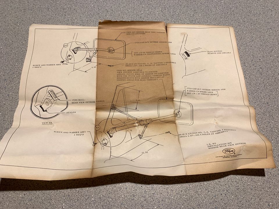

Here's instruction sheet I.S. 813 dated 1962 showing more details of the 5" x 8" telescoping and non-telescoping door slot mirrors.
