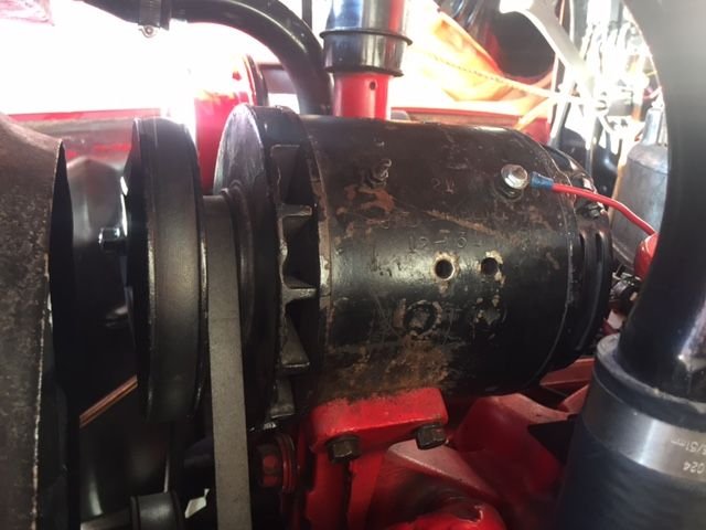

Siren pulley

Possible thought Keith. Could the extra strain from the siren be causing some difficulty ? I know you want to keep it stock, but I put a 65 Amp alternator on mine. No charging issues, Every thing appears to be good at this time

The siren has no current draw from the generator. It runs off a fan belt/pulley on the generator. I can't just put a alternator on unless I used a double pulley system like it currently has to run the siren.

I started looking for a replacement and found something like this:
Powergen 1949-53 Flathead Ford One Wire Alternator, 12 Volt - Free Shipping @ Speedway Motors
They are not cheap either plus I still need to figure out how to add another pulley to keep the siren,
Old Dec 17, 2015 | 08:34 PM

Keith,
I'm not too familiar with the older generators. I haven't worked on one in about 20 years or so.
Can't the double pulley set up be swapped off of the old generator onto the new? or is the shaft not long enough?
Ray had a great idea about searching the higher end cars like the Lincolns, etc
Bobby
