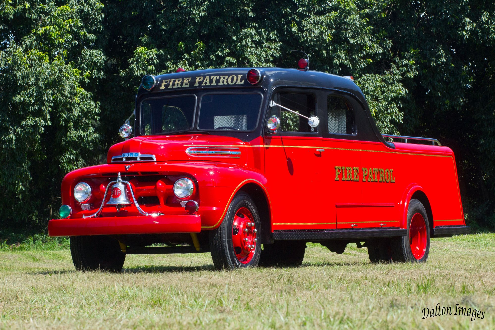

Thought I'd post one of the professional photos on the truck that he has on Facebook

Good progress for you Keith. Good luck with the Buick

Yeah Keith. You need to update your thread more often with pictures. That is such a beautiful truck.

That's a great pic Keith!
