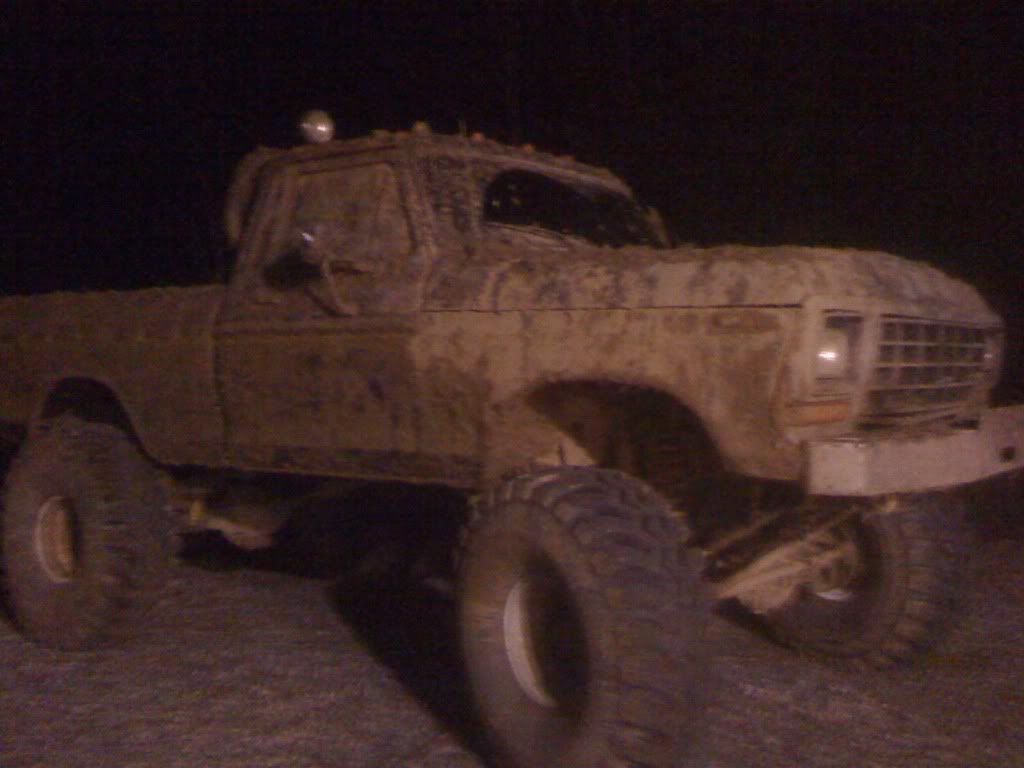

Torque Converter Let Go. Guess Im gonna rebuild with better parts.
But I had some fun first

well that sucks. nothing like having a muddy truck to wrench on. at least you got some fun out of it first to see that all the work you did was worth something. old parts wear out, **** happens. i love that truck.

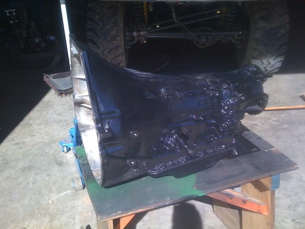

Got my transmission back this weekend.
The torque converter was the main thing that failed. It came apart and filled the tranny with a lot of bad things, which led of course to the front pump failing and the transmission massively overheating.
I had it rebuilt with better clutches and a much better shift kit. I also upgraded the tranny cooler to a ac condenser that originally fit the truck. I don't think over heating should be a problem anymore.
I had a low stall torque converter (1200 or so) built and the guy from bte called me today and told me it was ready to go, so maybe round two on the transmission will be a success this time.
I also twin sticked the np205 while I had it out. I may upload another pic or two later.
