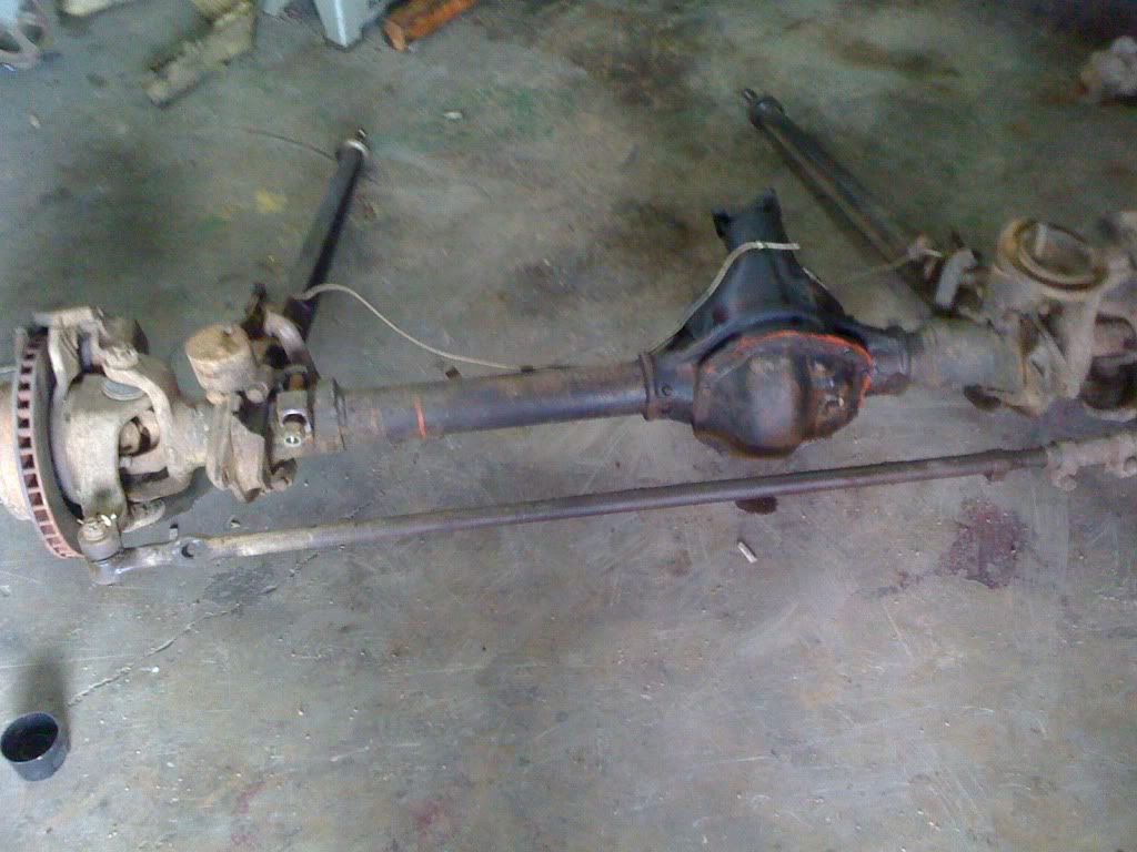

I got some time to work on my truck last weekend. I dropped the front end out, and started taking measurements to see what I need to do to accomodate 44 inch ground hawgs in the front.
Dana 44 front.
For Mississippi, my truck flexes enough so I think I am going to utilize the coil springs I already have because they have a smooth ride. My battle plan is to cut the coil bucket flush with the top of the frame, and then lower the coil bucket straight down until the top of the bucket is level with the top of my frame. Then I will secure it to the part of the bucket that is bolted to the frame. That probably sounds crazy and is hard to follow, but I think once I do it it will make more sense.
I am aware that a lot of folks would simply unbolt the bucket, drop it down, weld a brace to the bottom of the frame, and bolt it up lower, but I thinking the way Im going to try to do it will be net a little more lift and still retain factory strength.

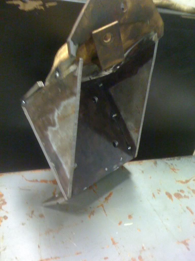

Finally I got a chance to get a little work done. I just invested in some machinery that I got at a local auction, and that has had my upmost attention for the past month or so. Now that I have all of the electrical gremlins and mechanical issues worked out in my shop I can finally get back to work on my dent. (Which ironically is at a friends shop...)
Anyway, today I built a the coil bucket I was talking about earlier. I simply cut of the top part of my old bucket and made a shorter bucket to to weld the top to. This will hopefully yield about 4-5 inches of lift. I only have it spot welded currently and all the points are still sharp, but when I take it over to the shop where my truck and verify it fits, I plan on finishing up the welding and smoothing out the rough edges.

I verified this morning that it does indeed fit, so I am going to build the other coil bucket tonight and finish up the welding, then I will bolt them on to the truck, and bolt my springs to my radius arms, then I plan on letting the jack down and seeing how far my springs squash down. Once I i know that figure, i'll secure my radius arms to my axle and build driveshafts and what not. I haven't quite figured out how I am going to do my steering but I have some ideas.

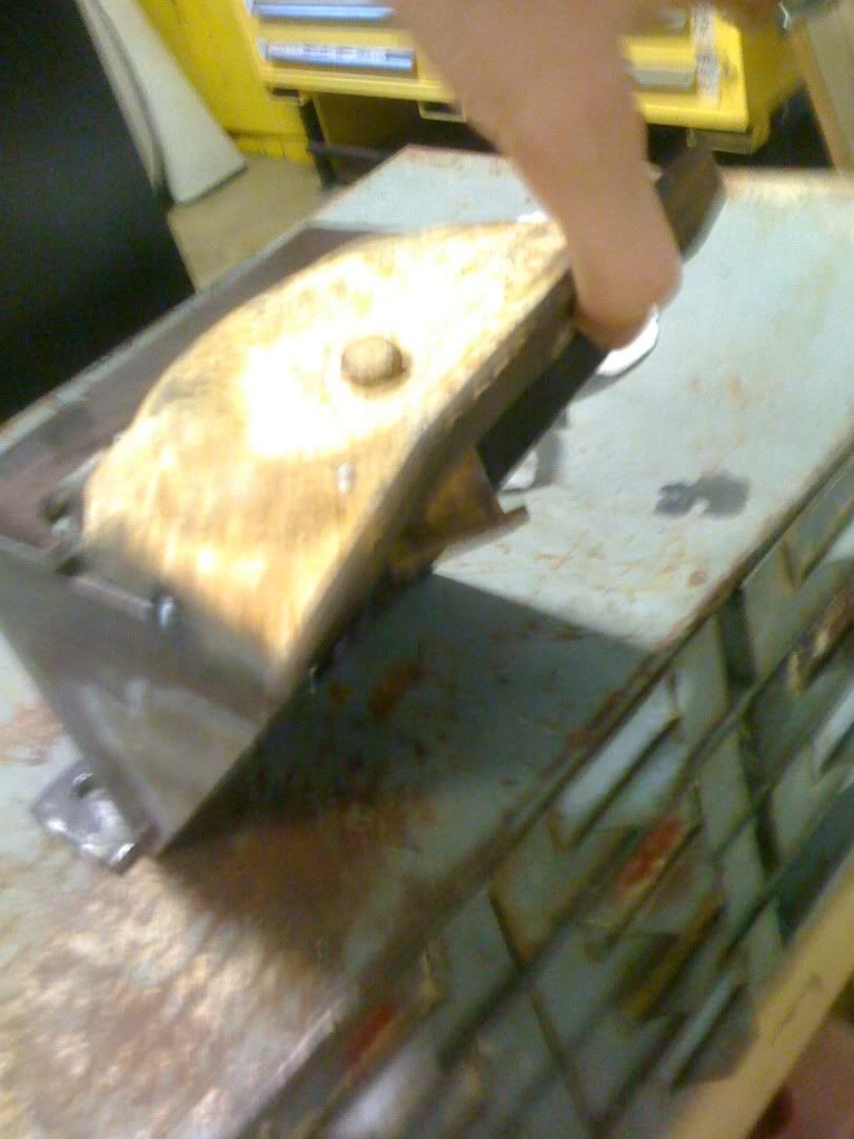

Tonight me and buddy spent time smoothing out all the rough edges, and welding it all together, I think it came out nicely, now to paint it and of course to make the other one.
