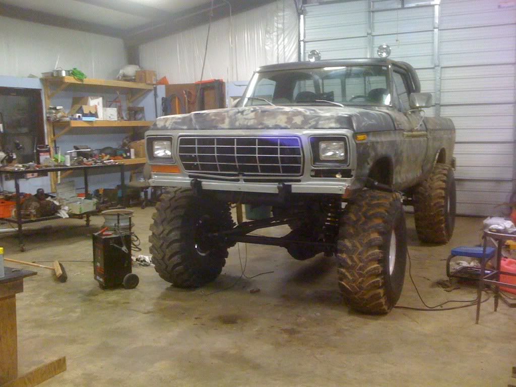

Got the truck where I can drive it around now.
After driving I have to issues with its handling. The power steering seems to be working too good, I figured with bigger tires and bigger axles the steering would be tougher to turn. However its quite the opposite which leads to a lack of road feel. Its also got some bump steer. These problems may be inherent with the modifications, but I think it could be better. Here is what I suspect.
A. The tires were over inflated making it feel a little squirrely and easy to turn.
B. I toed in the tires about a 1/4 of an inch. This may or may not be enough based on the size of the tires.
C. No steering stabilizer. (But it didn't have one before so I dunno about this one (I am definately going to make the upgrade to hydro steering one day but not anytime soon.
*** I can tell you its not the angle of the ball joints, I made dead sure to get those to the proper angle and am very aware of what the wrong angles would do to the handling. It is not this.
So let me know what ya'll think.
Second problem.
I put one ton disc brakes all the way around, they are bled and everything but it takes alot of pedal travel to get them to stop. I still have the stock master cylinder on it and the stock proportioning valve so I think it may have something to do with the volume of brake fluid thats being bushed versus the volume required by the huge calipers. But if ya'll have any other ideas or agree with me, please let me know.
Old Dec 13, 2010 | 12:25 AM
  #89
fatdan460's Avatar
fatdan460
Joined: Oct 2003
Posts: 6,949
From: utica il
A> i forking love this truck
B>steering stabilizers mask the actual problem with a fake solution. they absorb vibrations from **** that is usually an easy fix, but the problem gets ignored or covered up by the stabilizer.
C> check into a 79 f350 4x4 master cylinder or maybe bigger. the larger amount of flow to make the bigger brake components work is taxing the **** out of the 1/2 ton m/c. it will work, but it just doesn't move enough fluid to be adequit.
p.s. i want it.
Old Dec 13, 2010 | 12:33 AM
  #90
thekingofcows's Avatar
thekingofcows
Joined: Oct 2009
Posts: 871
From: New Albany, MS
I Appreciate the compliments.
Yea I have never been particularly fond of stabilizers myself. I haven't never needed one before on the truck. I'm just hoping it may be a simple solution like wheel alignment or over-inflation. But I guess all I can do is try it out and see how it works.
