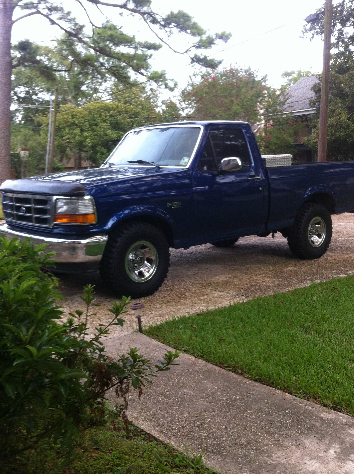

Thank you so much. Y'all are amazing! I love my truck so much and have over $30K invested in her over the past twelve years. She is stock and very clean. I refuse to get a new truck, against everyone else's advice. They just don't understand. It would be such shame to lose her over a $300 part. I'm going to try to post a picture of the lady y'all are trying to help me save. Thank you, again.
At Home
