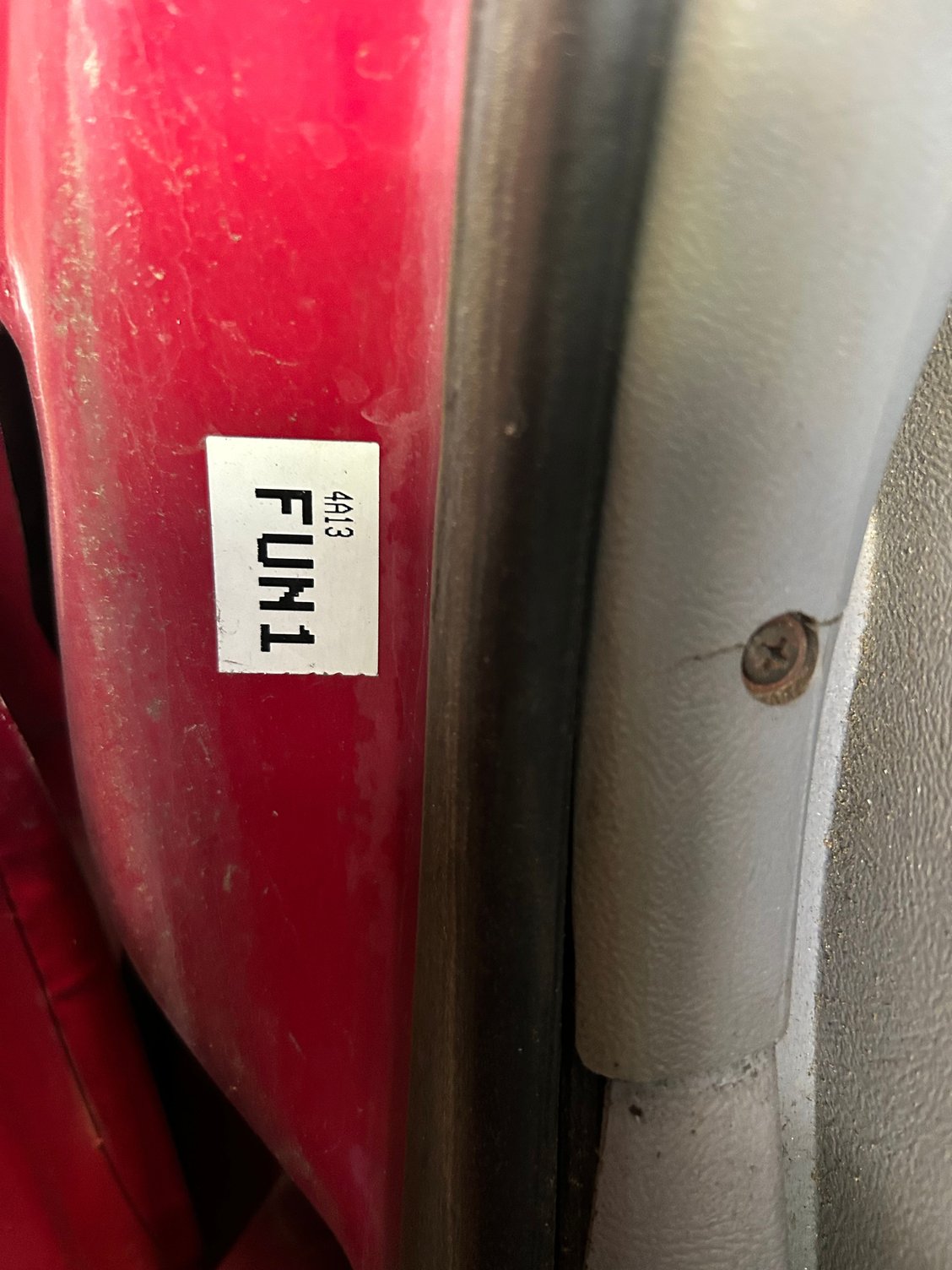

So I got a PCM F4TF-12A650-PA, but it is giving me a code about 4x4 (error 633) but my truck is a 2WD auto transmission. Rebuilt PCM:
I did find this sticker on the door frame of the truck, which seems to be the same engineering number.
Old Sep 2, 2023 | 09:02 PM
  #66
subford's Avatar
subford
Joined: Aug 2005
Posts: 23,668
Likes: 301
From: Easton,Ks
The 4x4 bulb in the cluster may be burned out,replace with a LED or missing.
It may not be seeing 12volts on pin #12 of the PCM.
The 12 volts comes from the cluster 4x4 bulb.
They may have used the same PCM for both 4x4 and 4x2 trucks.
