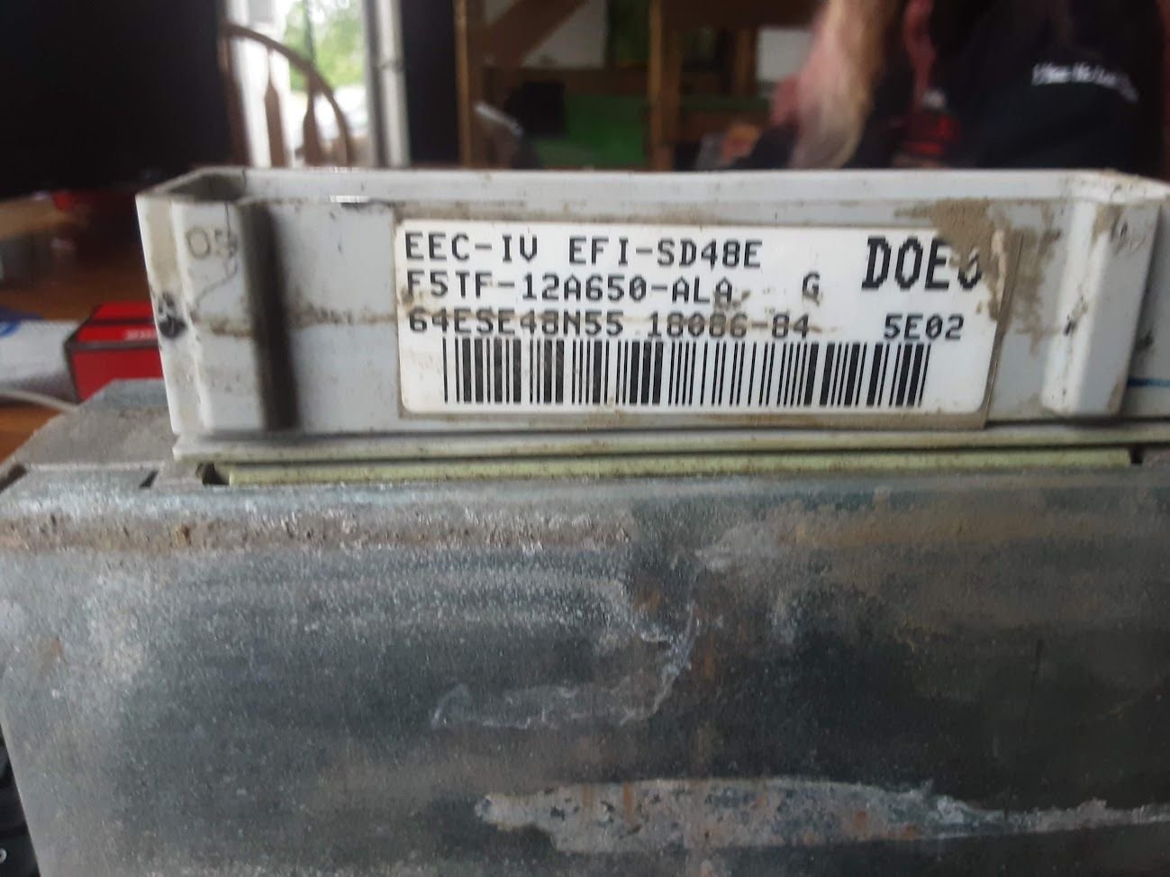

Hello new to the forums as a member but long time info searcher and end up here alot lol I'm coming to the conclusion my ecm is bad been chasing codes I can't erase and driveability issues for the past 3 yrs.
I sent my ecm out to have some traces and caps repaired and 633 code is still in the ecm. Ive tried everything under the sun and done every trouble shooting idea Ive found to no avail so now looking for a reman ecm looking to verify what I have is what I need and what brand of ecm to stick too and best bang for my buck if possible in this day and age.
IDK if this thread is still watched or used by the dates of the latest posts but I hope this gets seen soon tia.

His calibration code and the number on his PCM are a match.
Well, you have a 7.5l 460 engine E4OD, any EEC-IV SD48E hardware will work.
With only that one code, I'd say your EEC is fine.
What drive-ability issues you having?
