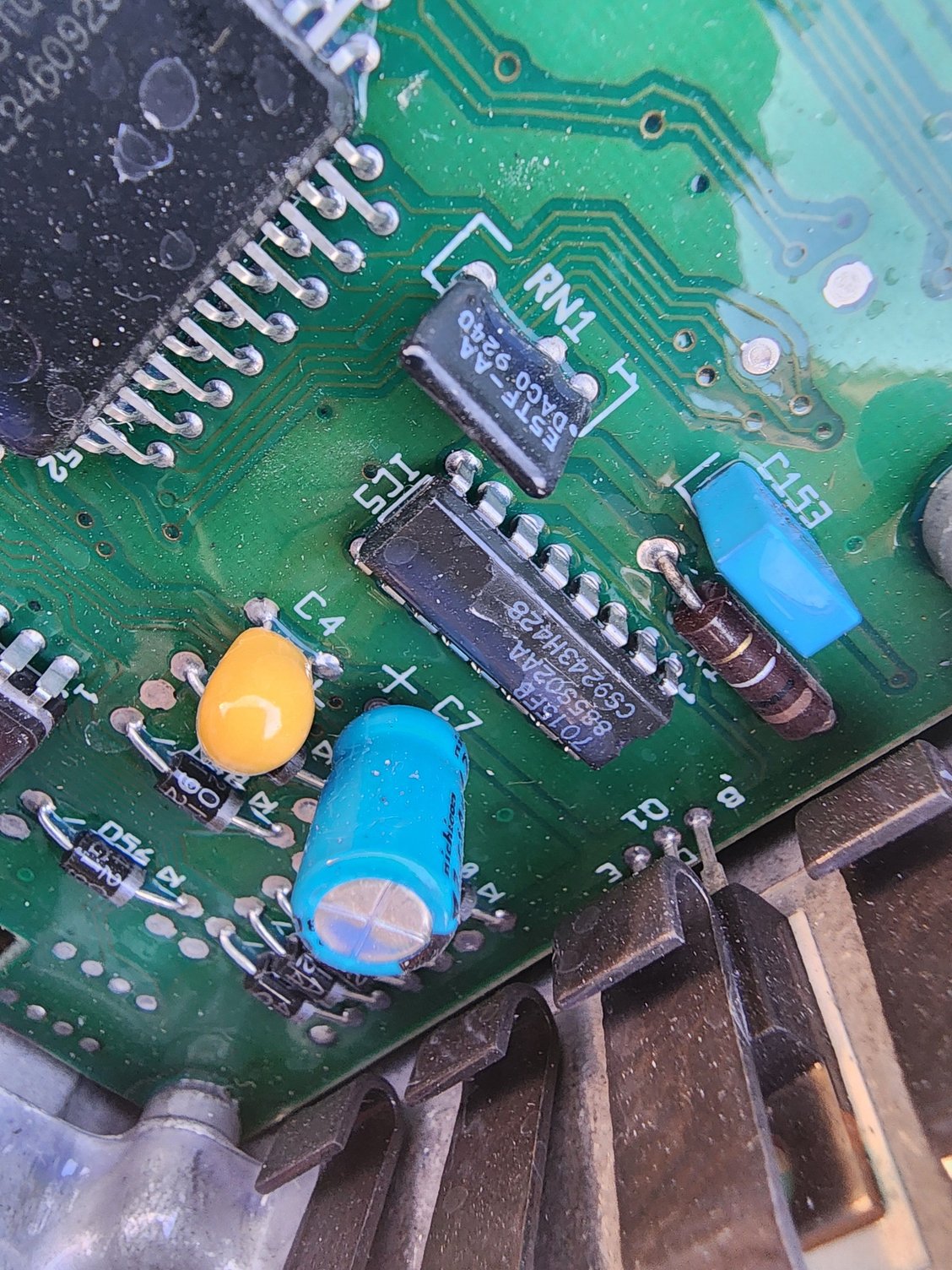

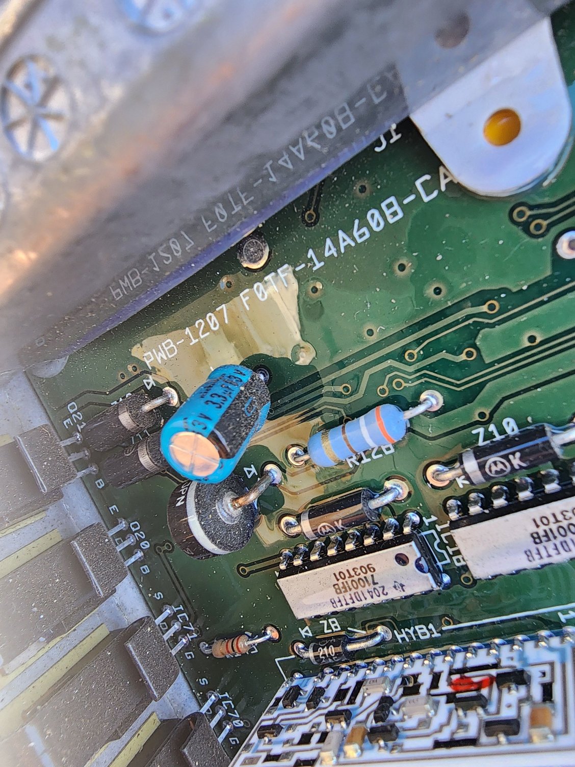

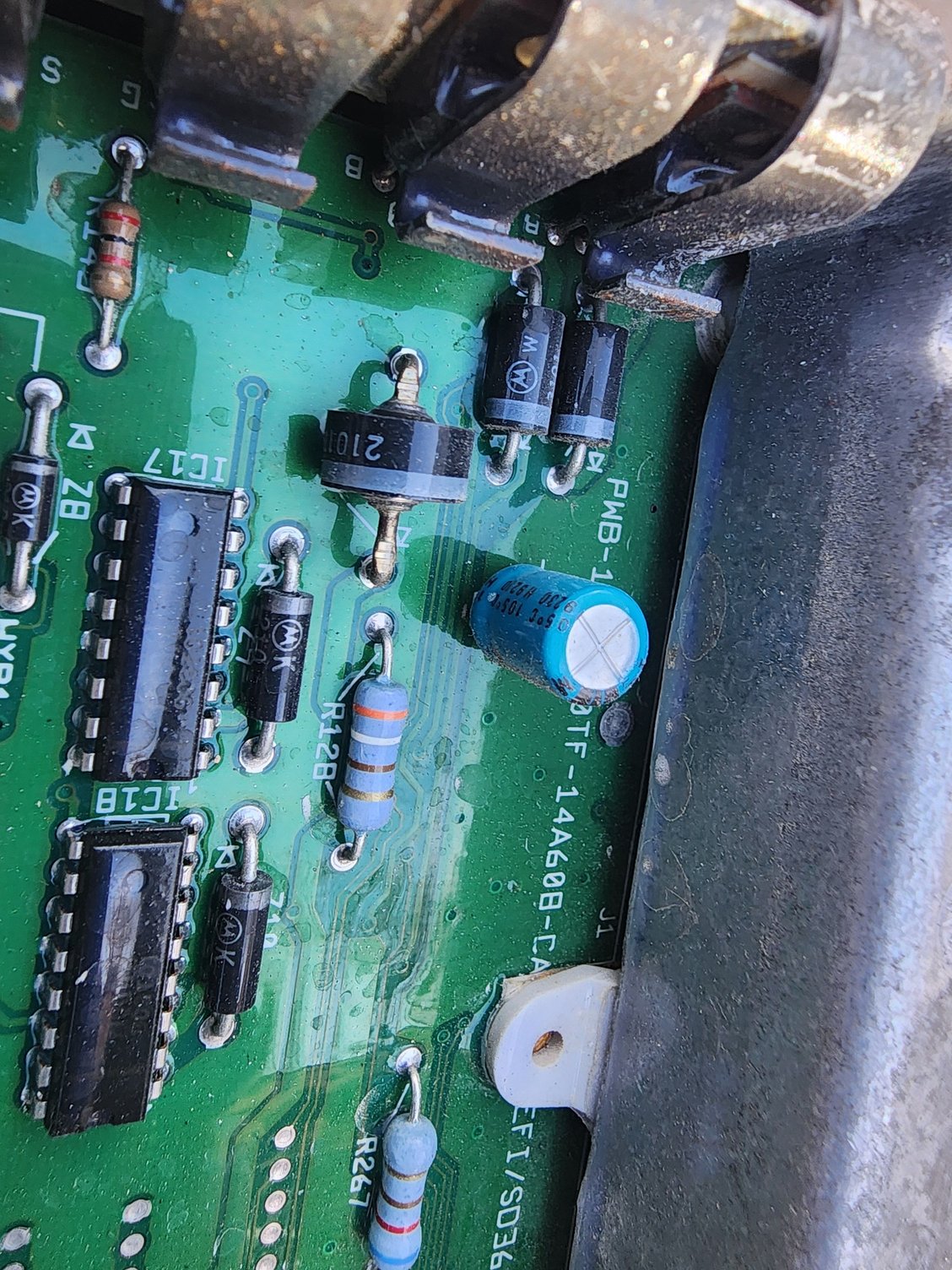

So thanks again subford for the list! Considering that a couple of my parts like the TPS and IDM weren't right, etc,etc. That being said, quick question about my ecm(s). I say ecm(s) because a shop had to replace per insurance.
Backstory...while rolling through a 40 yr storm, I went through an intersection and blazed through about 5ft of water that you couldn't gage due to rain. Immediately truck started to act funny and there were a couple electrical issues. Insurance made me tow it to a shop as to not create more issues or damage. The shop changed some sensors, checked grounds and connections and to no avail, ended up swapping out the ecm. Now mind you, it took about 4 days to get the ecm in, and it was back to running. They asked if I wanted the original back and said yes.
While working on the truck today I pulled out the ecm to check it to make sure it was the right one and to check the inside for issues. Thank god it was the right one, but I realized it wasn't a reman, just used. No biggie, if it works, it works. Opened it up and found no leaks or burns but he board looked old and not very glossy. Got me thinking...I grabbed my original and opened it up too see what happened and WOW! The inside looks way better than the used one. No leaks or burns and the board is pretty glossy! The metal case is even in better shape with no rust, as the used one is rusty in places.
So my question is, is there really nothing wrong with my original ecn, and they couldn't figure it out and just swapped it? I mean it did sit for 4 days and the water that was causing the issue more than likely dissipated and so when they put in the new used ecm....it ran normally? I took some pics of both so you can see. Let me know what you think!
