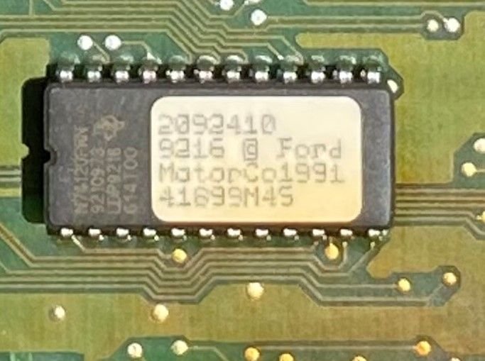

This is the bad item in my PCM … does anyone know how to order a replacement capacitor? I’m not sure which of the circled numbers identify item type. Maybe someone has purchased these and knows where to get them and a replacement part number. The vehicle is a 1992 F150 4.9L with man Tran. Thanks.
Sure.
But I order extras and I had 4 PCM's to put caps in.
Attachment 277829

Again I “Thank You” subford. Your contribution is deeply appreciated.

WOW! No doubt those are bad, Cardone is what most of us have gotten, they are all rebuilt, no news...anywhere, dont pay new price, when you get it, open it and check it, before assuming...or you can send yours off to get fixed. if not driving is option, wasnt for me.

Those caps are like a buck and a quarter each, simple soldering skills, common sense, fix your self.

I purchased the caps from the site subford recommended. The cost was minimal and they arrived quickly. Since I don’t solder well I took my pcm to a cell phone doctor (recommended by the GEEK Squad at Best Buy) who removed the old leaking caps and soldered in my (3) new caps for $49.00. I reinstalled the pcm and and all is running well! Hardest part of it all was removing and reinstalling the pcm - but being patient helped. However, as I was backing out of the garage, I noticed an oil spill near where my passenger side rear tire sat. Now I get to I replace a leaking wheel cylinder. But that’s how the journey unfolds sometimes.
