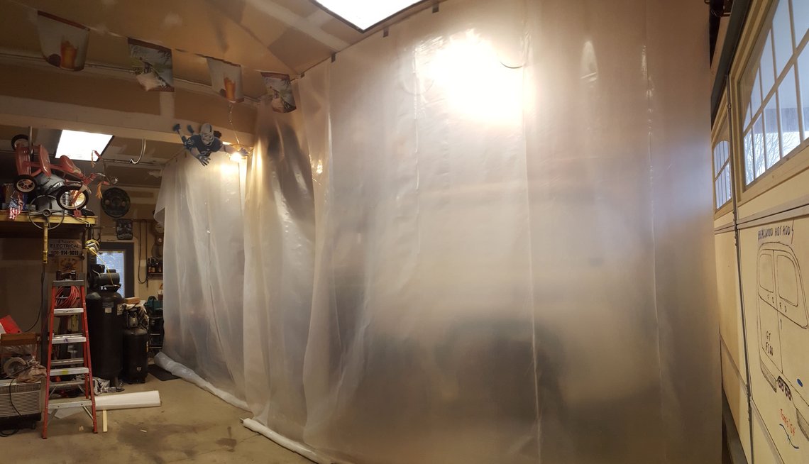

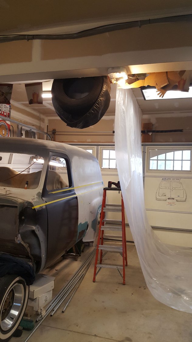

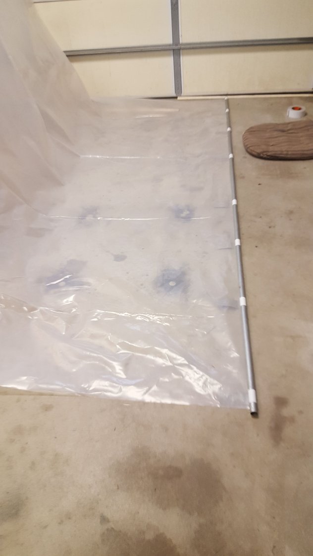

Hi Guys I don't know if anyone is working in a home garage and is tired of the dust from sanding but I had an idea and went with it , I took wood lathe and 6mil polly, and some EMT (electrical conduit) rolled the lathe and the other side rolled the EMT and duct tape to make a tent that rolls up and down to keep the dust and paint fumes down to a minimum

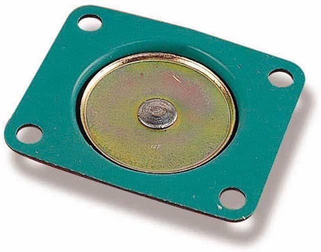

I have been having trouble for some time with a stumble coming off idle, a no-start cold or hot without holding the choke closed and a higher than normal idle like a vacuum leak. I have replaced the head gaskets and the intake gasket, removed & plugged all the vacuum lines at the source and replaced the carb gasket. The Holley 4160 390 cfm 4 bbl carb was new in 2014 and the truck has been driven less that 100 miles since then. Finally on the advice of a friend I started looking at the accelerator pump. The diaphragm seemed to be n tact but ir was hard and did not flex much. I called Holley because I was having trouble finding the right part number to order. They were most helpful and gave me the number for the stock diaphragm (135-5). I had seen on Amazon a green diaphragm that was alcohol resistant. I asked the Holley tech about that as I know most gas contains 10% alcohol these day (written right there on the pump). He immediately gave me the part number 135-10 that he said would work great. And it does. That got rid of all the problems mentioned above. Cold and hot starts are immediate. Hope this helps someone else.
