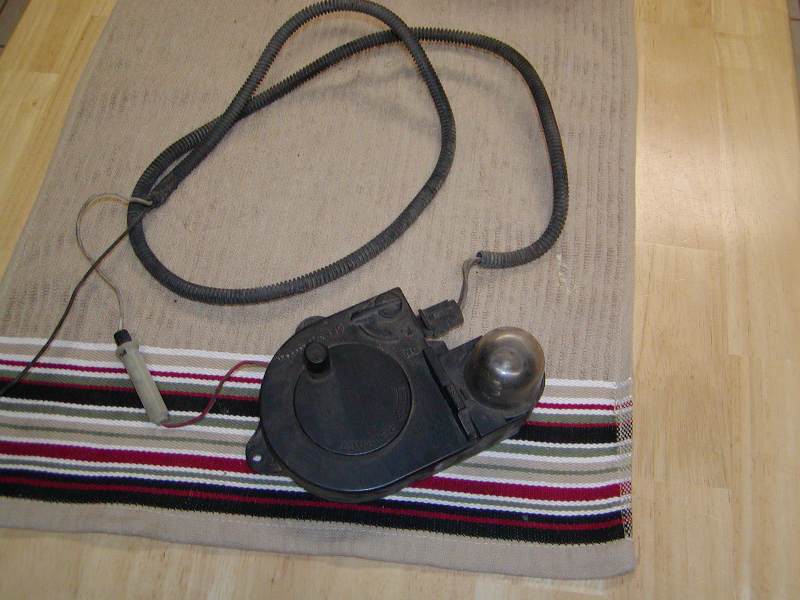

Boneyard work light
Here's a great one! Next time you're at a boneyard, check under the hoods of '88 - on Chev/GMC's. They had an optional underhood light on a reel. This is a total add-on, stand-alone item so you can unscrew 3 screw, and two terminals and have a piece that is ready to hook up to the starter solenoid for power, and screws to the inner fender (or -?-). It is a 12v light on a retractable cord nearly 15 ft long, with an on/off switch built in. Great for changing a tire or any roadside maintenance, even checking the oil. You can turn it on in its anchored (retracted) position to use as an underhood light. They're dirt cheap, too!
