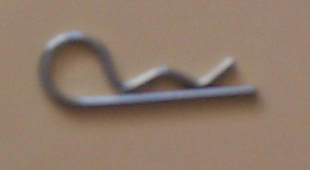

Save some frustration when replacing cotter pins on non-safety things like shifter linkage (i.e., this isn't for ball joints or steering linkage parts). Instead of a cotter pin, use a Hitch Pin. They hold tight but there's no drama removing them like with a bent-up cotter pin. Available at Ace Hardware, True Value, etc. 1/8" is the most common on Bonus Built trucks (column shifter linkage, clutch adjuster pins, etc).

I've used these on carburator linkage too. Work nicely. That clip in the picture looks like the same one I found after a few frosty beverages...
