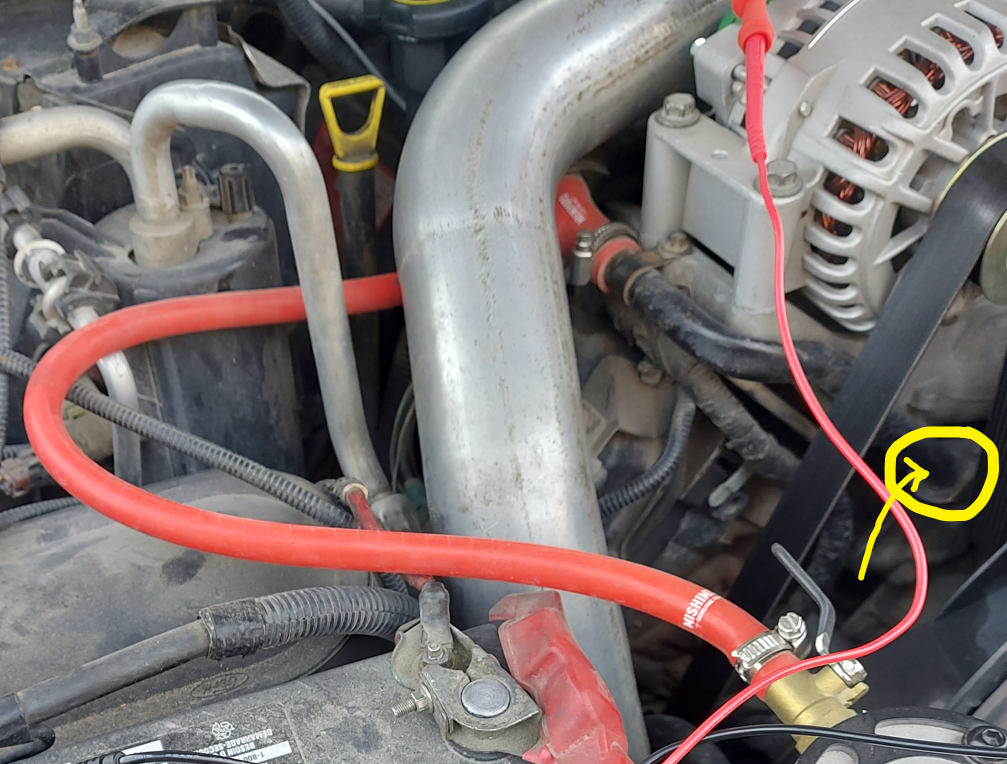

Was just doing a few things outside and noticed a nice puddle of coolant under the truck which has been sitting for a few weeks now. Same thing happened last winter and every time there was a cold snap like -25c or lower it would leak coolant, but it's only -15c so guess it's time to replace whatever seal is worn to crap.
I believe last winter I concluded the leak was coming from the seal on the metal coolant pipe that sits right beside the alternator then flowing down the valley and dripping down the back of the engine. Do I have to replace the whole pipe or can I just buy the seal/gasket or use a high heat gasket maker type stuff?

If there isn't any corrosion in the aluminum bore, I would source an ever so slightly oversized o-ring, lube it up with Sil-Glyde, and pop it back in. If there is corrosion or pitting you could clean it really well, and try gasket maker on the o-ring, or do the Jack mod:

Anyone by chance know the nut type/size holding that snap to connect coolant tube to the block?

If you're talking about the flange head screw that secures the pipe to the front cover, it's most likely an M5. Why, did you lose it?

Huh ok. I thought it was a weird star shape or something

So I checked the front cover discharge pipe yesterday and it was bone dry where it plumbs into the cover yet there's coolant just half an inch away right on the valley so in that location the only other thing that could be leaking coolant would be the front cover correct? The leak starts pretty much at front of the valley on the passenger side and runs the length of engine then drips down the back of the engine. Degas bottle level still looks good, but coolant puddle underneath looks to be 300-500mls worth.
Now if it's the front cover that's leaking could I just get in there and try tightening the bolts and go the RTV route if it still leaks after that?
