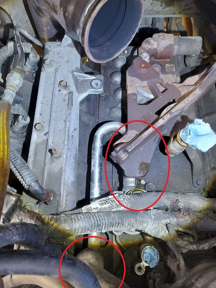

Originally Posted by texastech_diesel
What's the flow route out of the oil cooler with your system?
A j-hook EGR delete would still have the nipple cap seal at the oil cooler base, a hose, and an o-ring in the bottom of the intake manifold.
IPR Research is a solid bar so no hose, but removes the cap and has o-ring seals on both ends.
BPD is either a hose to a j-hook delete or a hose run somewhere.
This is what the delete looks like:

There's no leak coming from the black silicone hose where it meets the J tube and the leak has to be coming from the very front of the engine as the truck is on an incline and there's coolant at the front cover so I'd assume it's that intake doughnut that's leaking, but can't get a good enough look without removing stuff first. I haven't ran the truck in weeks and it's STILL pizzing coolant so I'm going to get the engine up to temp on Saturday and see if the leaking stops and if it does I'll hight idle for 30 minutes or so to burn off the coolant on top of the engine then see if it starts to leak again when cold.

J-Hook delete. Most common leak points are the hose/clamps coming off the oil cooler, and the o-ring on the bolt side that goes into the underside of the intake. If it's not the hose, still might be good to check underneath where it goes up. That's where my leak was. IMO pull it out and check the o-ring anyways as part of loosening the intake and lifting to access the donut.
If it is the egr delete pipe that's leaking it would be the smaller O ring on the right side correct?

Originally Posted by Fuzzpuss
Yes. The other seals the hole in the intake where the exhaust would enter through the cooler.
I went to the dealer looking for that o-ring when the joint leaked, but they said there was no call-out for it. Just like the power steering hose seals.
I checked that J shaped delete tube and it's bone dry on both ends so the leak must be coming from the intake O ring which would make sense seeing as there coolant on the front cover itself. As mentioned earlier the truck is on a slight incline so if the J shaped delete pipe was leaking there wouldn't be any coolant on the front cover.

100% confirmed that it's the intake to front cover seal/doughnut!
I've got the alternator and right side CAC tube off thus far and will pull everything else off the top of the engine so tomorrow I can hopefully replace that seal and put everything back together. Tomorrow has a unheard of high of +4c so I want to get it all said and done by sundown.

Almost looks like someone used our TV instead of the donut, unless I’m miss reading the image.
Looks like the black O ring just chewed up a bit, but could be some RTV perhaps. Called around and I won't be able to get my hands on the part till early next week when it will be back down to -20c so now I'm wondering If I want to try some RTV or something while the weather is nice.
What exactly do I have to remove to be able to lift the intake just enough to get the old seal out and slide a new one in there?
Jack covered that earlier, but if there's RTV in there, I would plan on removing the intake in order to clean it out.
DieseltechRon's oil cooler video covers intake removal if you aren't familiar with the procedure.
