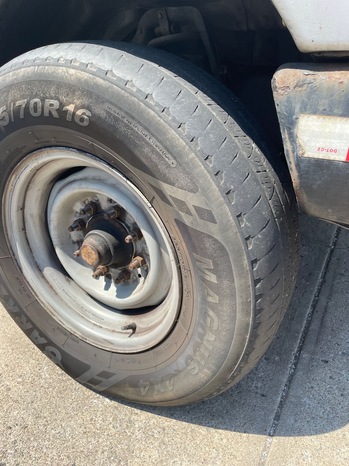

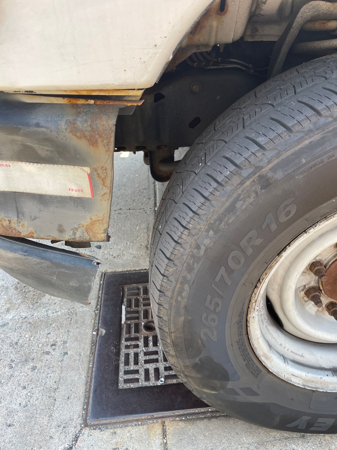

Barkley Magnus 4x4 265/70R16. front right tire(most tread loss as tire pressure will permanently be lower than the other 3)has a slow leak from rubbing against the grill/bumper when making turns
from hitting a ice patch and lost my brakes that ended into hitting a snow bank(at less than 5 mph)
shop that I’m currently getting it fixed at replaced the ball joints/drag link/tie rods that were shot. going to do shocks eventually don’t think that will make a difference. not sure about the push rod/brake booster i’m a newbie

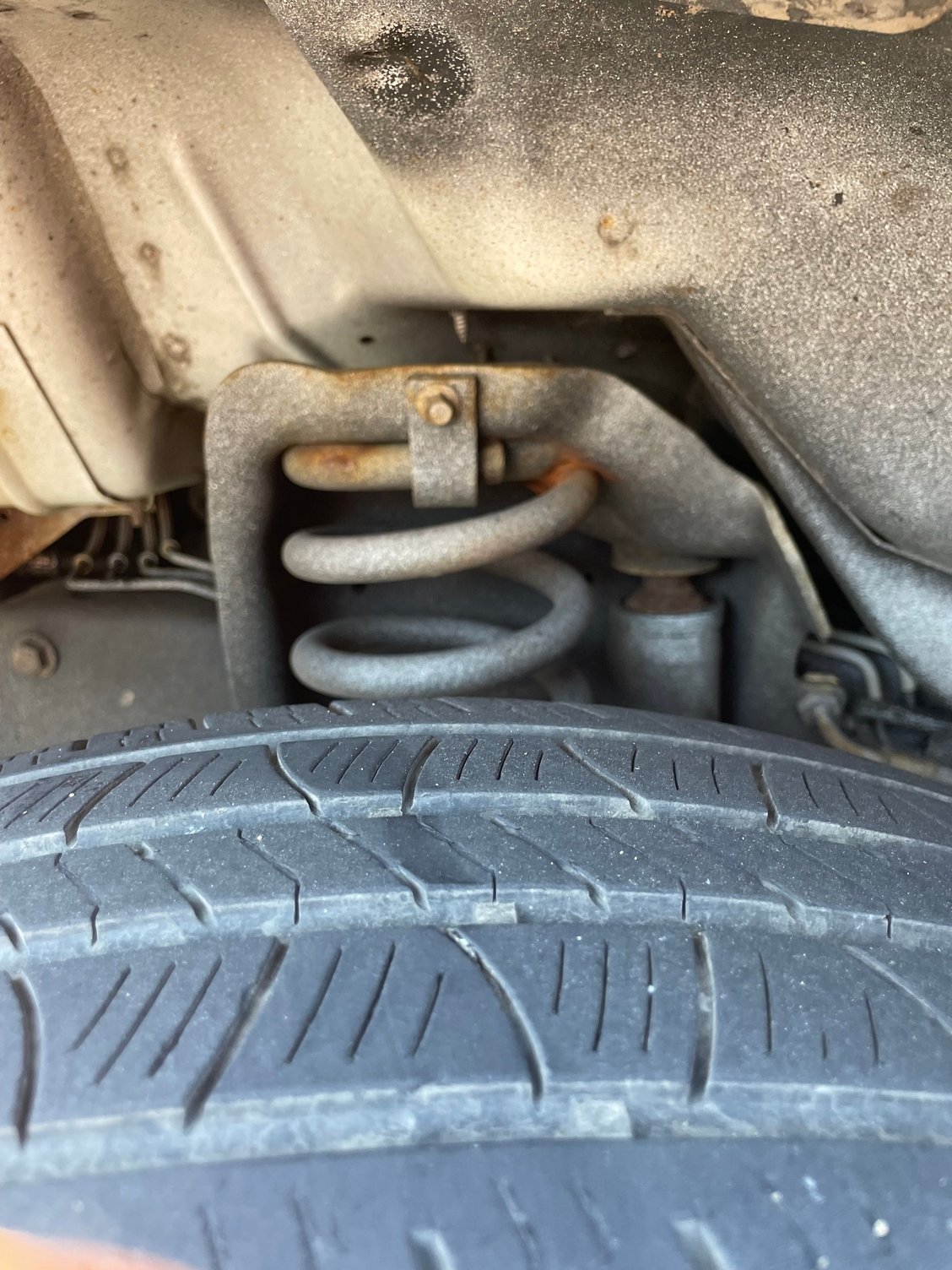

Originally Posted by OCBlue88
Local shop said shocks and springs fine at 260k miles? Hmmmm....
shocks look like that on each corner. would have to get a better pic for the springs. that rust just started(im in the north-east) and it was around 240-245k miles when they checked them(3 months ago) so it could have gotten worse in that time

I'm only going by mileage and assuming the van is on its original suspension. Those things don't last that long. 100k miles on a set of shocks is way overdue. Springs....maybe 150k miles if the van wasn't always loaded down regularly.

Put some different tires on the front and re evaluate dodgeorramit
I see no wheel weights
Are you sure the tires are balanced?
I would assume the alignment is close enough and the parts good, after the front end work
