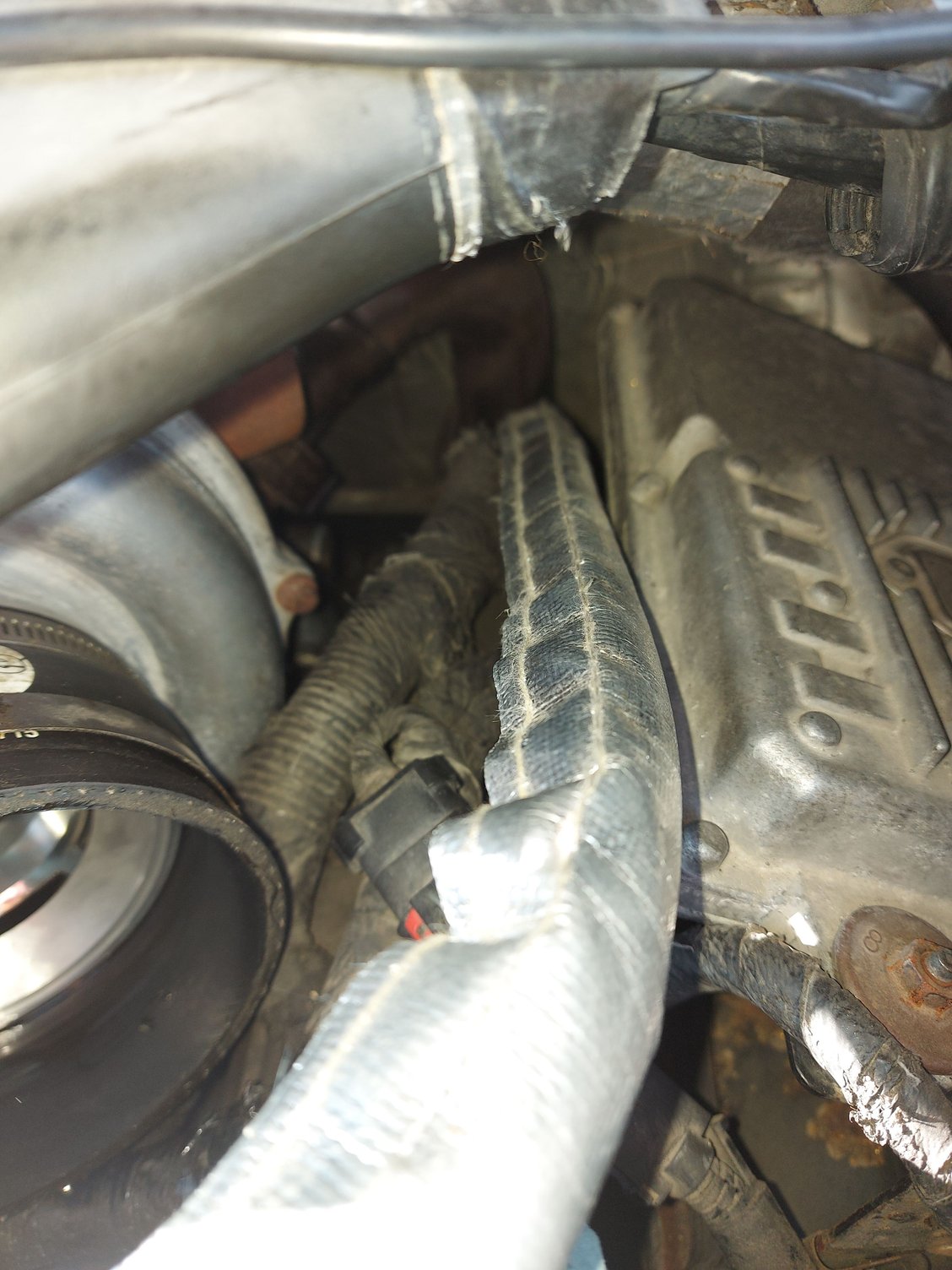

BTW when I did the pressure test I mounted my contraption directly to the turbo so I had to remove the tube with the CCV line and when under pressure there was some air pushing out the CCV tube hole and I'm wondering if I was suppose to have plugged it with something or just let it sit open?
On the last pressure test when the CAC boots were quiet I was able to hear air hissing from the area shown below FWIW:

From: Fort Worth, TX
That happened on the 06 I tested last week, and IIRC on mine the last time I tested it too. It sounds like its coming from the turbo to me. I never did figure it out, but I sprayed soapy water all over the intake and turbo and got no bubbles.
