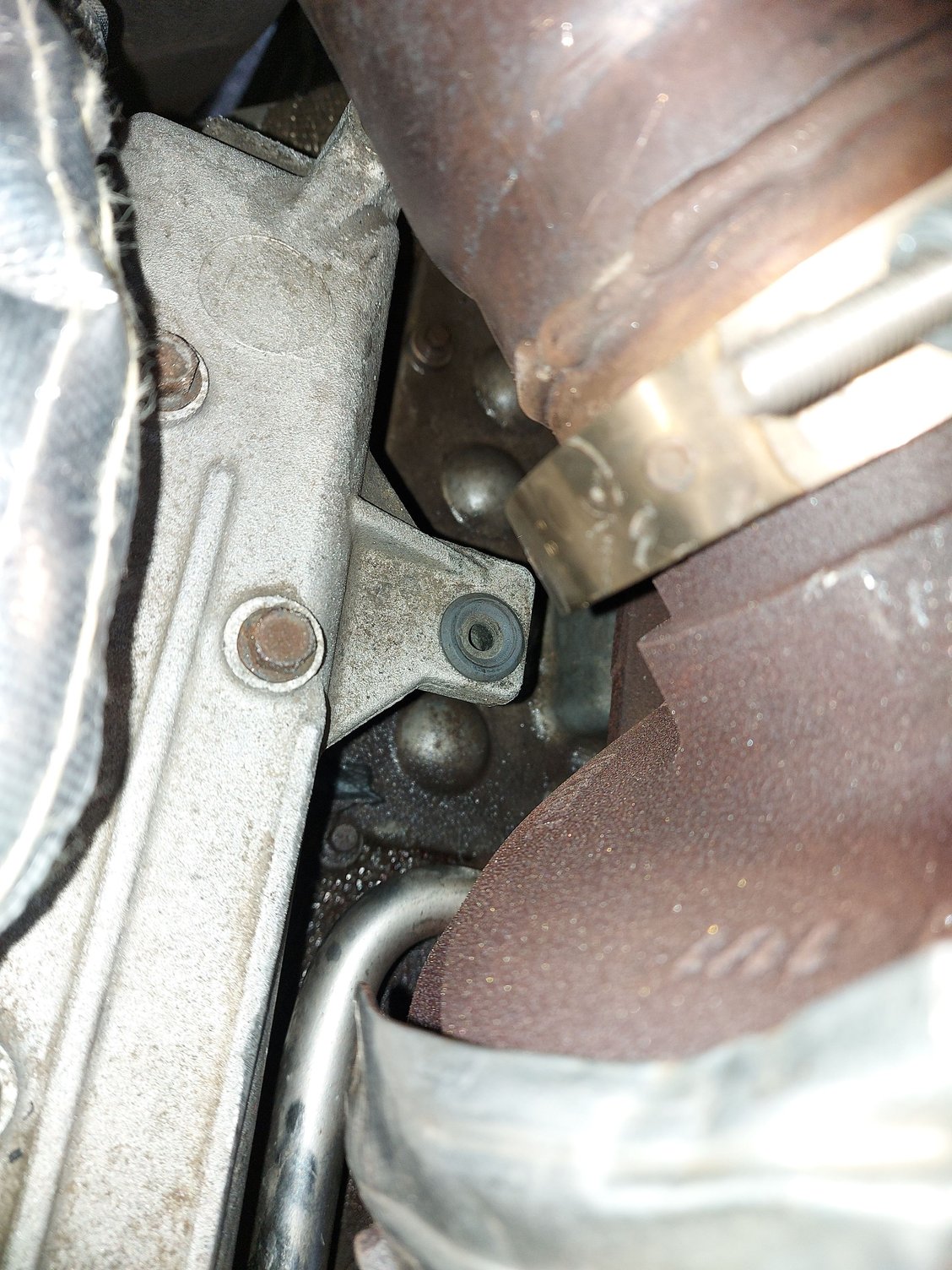

Well I'm tired of not being able to use the truck and it's fairly nice out today so I'm going to rip into the engine again and get as far as I can get and finish it another day if need be. Looking at older pics I noticed that my intake manifold has the tab in place still so I guess that means the turbo has to come out and if so whatever lol.

You can get one of these small handheld hacksaw’s at most hardware stores or big box stores for about $10-$20 US. That would allow you to cut off the soft aluminum tab on the intake so you don’t have to pull the turbo.
And do not use oil on a coolant ring.
Looks like i don't have to worry about that tab after all.
Here's where I'm at right now:
The passenger side manifold bolts will be easy, but the bolts on the drivers side will be a bit of a pain so will the rtv I put on last week to try and stop the leak. I'll scrape as much off as possible and hopefully I don't get any pieces into the coolant when swapping out the O ring.
Also my air compressor is kaput for some reason so crossing my fingers and saying a prayer that i don't get any crud into the intake ports when I lift up the manifold. I'll just try my best to not move the manifold around and cross my fingers.

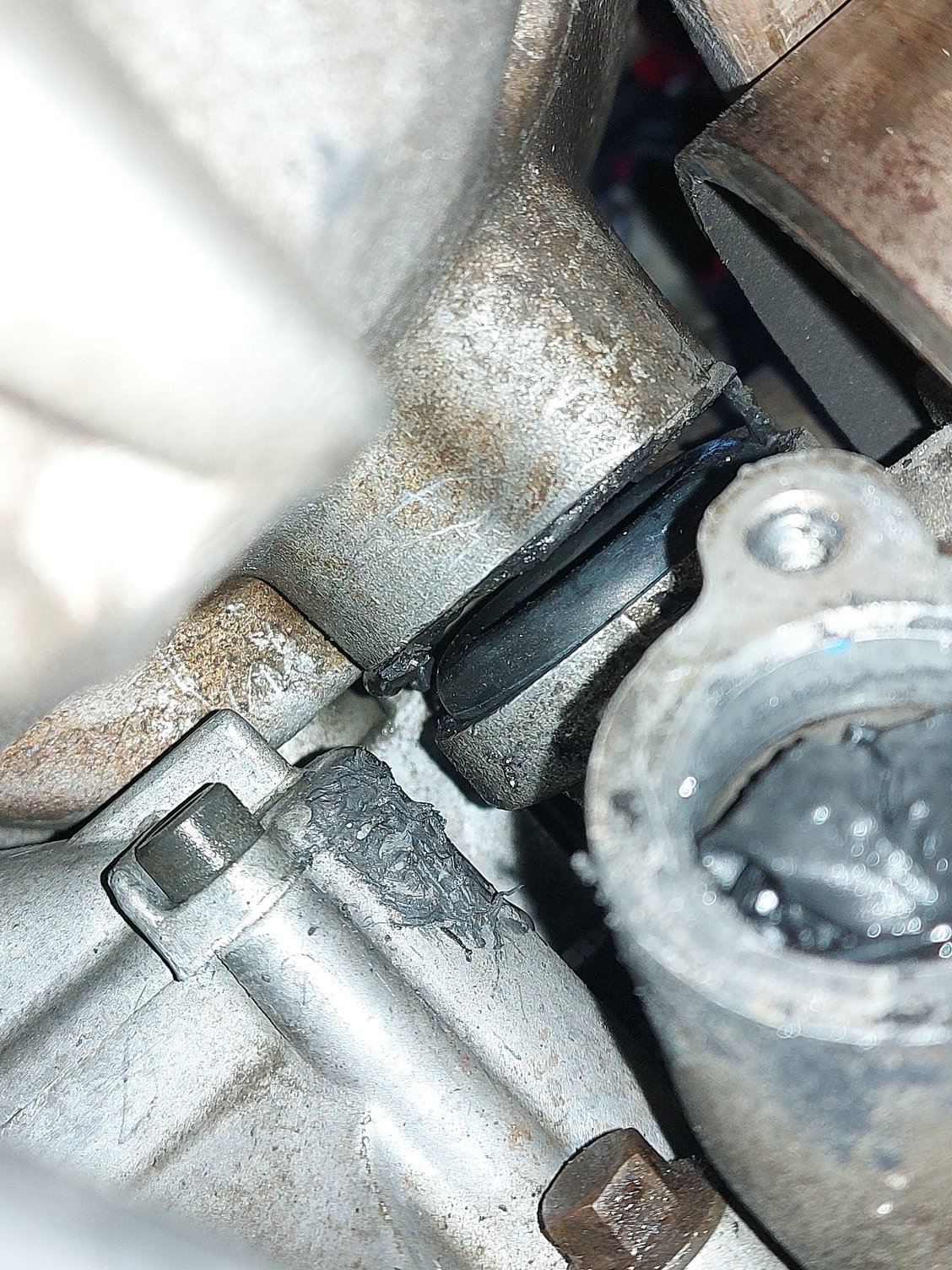

I had to remove the degas bottle and FICM to get at the drivers side bolts, but manifold is up now and will replace the O ring then start putting everything back together.
Old Dec 15, 2024 | 03:57 PM
  #114
wpg_250's Avatar
wpg_250
Joined: Feb 2023
Posts: 1,924
Likes: 817
Old one out:
New one in:
Now to torque the manifold in sequence and to 8 foot pounds then put everything back together tomorrow hopefully.
What a battle this has been 😵‍💫
