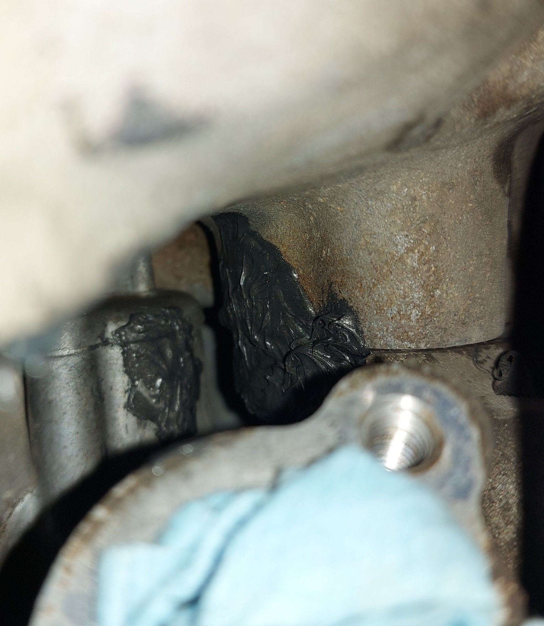

Well today didn't go to plan at all, but I have it all put back together now minus the coolant. There was no way I'd get it all done today and 15cm worth of snow tomorrow then back down to -20c temps so this is something that will have to wait till spring. I cleaned the area where the leak was coming out with brake klean and a rag then rubbed RTV into the gap as best I could for a few minutes and rubbed a thick layer on top to finish it off and I'll wait till tomorrow to refill the coolant and see if she still leaks. I put some RTV on the rigid black coolant pipe as well just for good measure and cleaned it really good as well, but it wasn't dirty really and came out easily so that was nice lol.
I also figured why not check the intake manifold bolts to see if any were loose and sure enough I had to snug a few up a 1/4 turn so maybe that and the RTV will stop the leaking when cold and if not so be it. Also noticed the bottom end of the egr valve is pretty darn coked with soot or whatever, but egr is just there for show so not sure if that matters or not? Either way come spring I'll redo it all and put in an updated O Dog (or whatever it's called) intake manifold and all new seals etc.

There's coolant under the truck again this morning so my efforts were unsuccessful sadly. I'm either going to have to just wait till spring to fix it myself or find a shop that has a large enough bay to accommodate the camper, but I'd much rather do it myself and know 100% that no dirt or debris gets dropped down into the cylinders.
