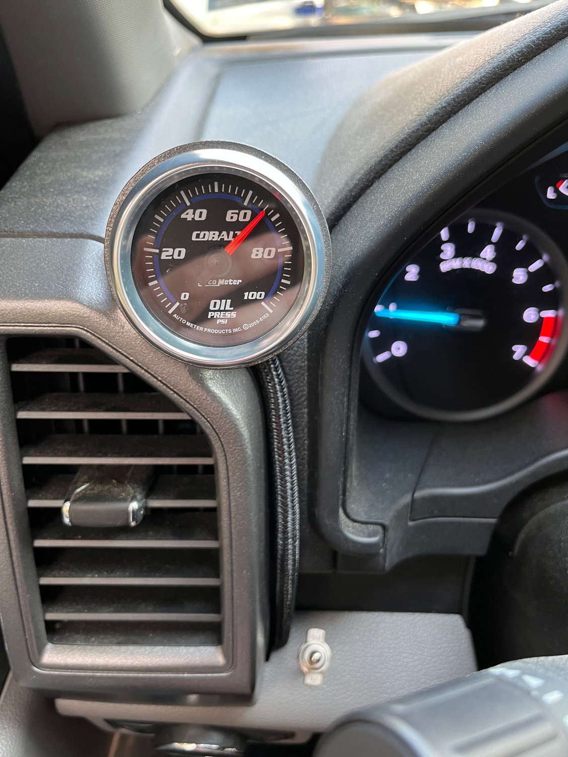

Originally Posted by FishOnOne
Is this one of those "Real" nuggets you were referring too?
The screen shots posted by @saratoga2011, would have been one of those "nuggets", as it appears Forscan is measuring oil pressure.
Now you have called that data into question. If you can provide "actual" support for your "almost guarantee" that the data is not as posted.....
(instead of an opinion) That would be a "real nugget" of value. The prevailing view on FTE is that oil pressure can't be monitored electronically.
Well, now we have a screen shot of oil pressure on the 7.3L and an opinion that it's an algorithm....Hmmm which is it?

I can positively without a doubt 100% almost guarantee that somehow the engine managment system knows what the oil pressure is.

Some people on this forum are amazing. Someone finds a way to get oil pressure on this 7.3 which doesn’t require an old school sensor and gets debated as to if its real or not. I appreciate the time and effort put in by saratoga2011 to figure this out and post his findings. It has long been questioned whether this cam and lifter issue is due to the variable oil pump or not and correct me If I am wrong but this is the first time someone has actually posted the oil pressure numbers. If you don’t believe Forscan and his findings then don’t read or go hook up an old school analog gauge yourself and come back with some data of your own. Forscan has proven to be very capable at many things so no clue why anyone would question the data. Ford has stated there is a way through programming to alter pressure, Forscan proved it works by disconnecting a wire. To me thats proof it is in fact reading pressure.

I owned a 6.0 and monitored PIDs religiously. That being said, I'm not convinced these are REAL readings and not a computer or algorithm projecting numbers. When you blow an IPR screen or a stand pipe O-ring on a 6.0 and get a crank no start the computer defaults to reading under 100psi or 1400psi oil pressure. That isn't an actual reading it is the computer telling whatever you are monitoring with what to display. Without a manual gauge hooked up I would be very skeptical of those being real world oil pressure numbers.

Where is the oil pressure sending unit switch located on a 2022 7.3?
I’d like to connect an electronic oil pressure sending unit and gauge to that same port. Sense the factory gauge is nothing more than an idiot light with a needle instead of a light bulb.

Ford has used a dummy switch for 40 years now. Excuse me if I’m a little skeptical that they just now start using a real sensor. Even the 6.2L used a dummy switch. Factory service manual said to hook up a manual gage if you want to know what the pressure is.
Perhaps you shouldn’t just fall for the first bit of information posted in a flashy graph, and question if it’s actually real based on Ford’s history…
And some people are just as amazing to blindly believe a flashy graph and ignore 40 years of history.
Im not saying saratoga’s findings can’t be true, but I want a manual gauge to verify it before I will trust the data.
There’s a reason no aftermarket scan gauge (same data Forscan reads) can’t read oil pressure (Banks idash and such…)
Aside from the sarcasm, I agree. But absent evidence (data) to support "opinions" to the contrary.........I don't recall any previous posts supporting an electronically measured oil pressure reading. A manual gauge reading comparing the Forscan reading would absolutely confirm or dismiss the "flashy graph". (Someone will get that done eventually) I find just as amazing that opinions, rumors and hearsay cited as fact, and you tube videos cited as supporting evidence, ie I read or saw it on the web so it must be true....... are just as blindly believed.
IF - it turns out that the Forscan reading is "the real thing", it is not surprising that the gauge mfrs have not included it yet, but they will.....IMO

I doubt it. To many customers will not understand why it is lower at a warm idle and the service department is already full.
Now it is possible ford could run a transducer to send pressure readings to the ecm and then just trigger the dash gauge to read good at say 12.5 psi. But I highly doubt you will ever see variable readings in the dash again.

I really would like the idea of a true mechanical pressure guage in this case.
Need to get an adapter like this…
https://www.dakotadigital.com/index....od/prd1255.htm
https://www.google.com/search?q=fat+...6MkAP7HUY,st:0
