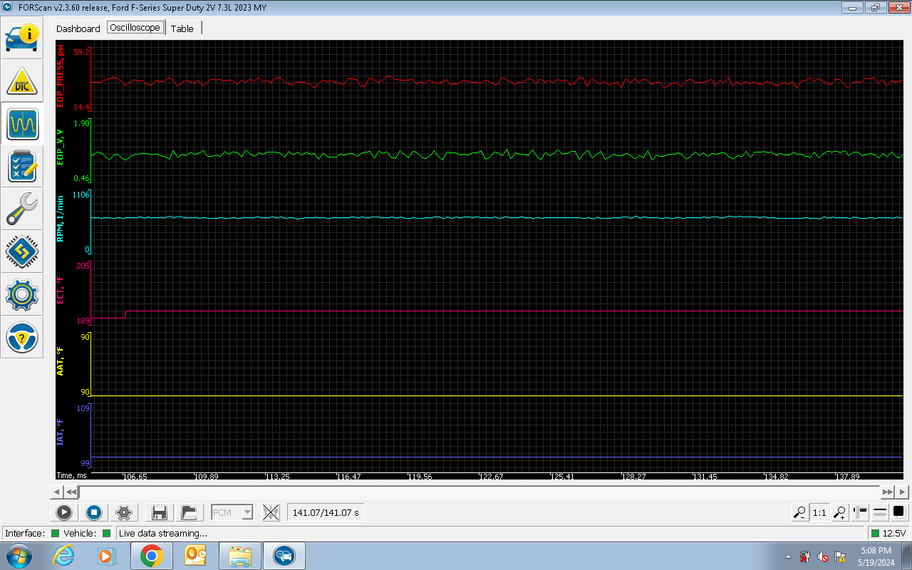

I did some reading through the service manual this morning and played around with ForScan for some live data logging. It was interesting. According to the manual, if you unplug the solenoid and start the engine, you should see a minimum 40psi rise in oil pressure and yes it will set PO6DD. That to me says you can defeat the variable displacement functionality.
Cold startup, the oil pressure was right at 95 and stayed there for about 20 seconds then it went down to 28ish and held there independent of RPM. Note the oil pressure is abs.

That video shows how the oil pump varies its output. The pump cannot do that on its own.
What it does not go into is the hydraulic control circuit which varies the displacement. It does however confirm that it defaults to maximum displacement when no control is applied.

Very interesting, wasn’t aware Forscan had that capability. Would be interesting to see the stock oil pressure once the engine is fully warmed up (assuming that it wasn’t) with oil temp around 190 degrees. If it is still in the upper 20 psi range wouldn’t that be sufficient to lubricate the engine? Only asking because I have no clue and have seen people saying on the forums that it is probably around 8 or 10 psi at idle.

Ran the same data log again right after I ran some errands with a bit of 70mph driving so everything was hot. Coolant was like 195, oil and trans were both 200 if memory serves. Looks like oil pressure was steady around 20-21 psi. Didn't matter whether it was in park or in gear idling. Pressure did come up to around 50 when I raised the RPM up to about 2,000 in drive.
I'll have to try the same data log while driving.

I found a DTC for variable oil pressure on some other more mainstream Ford vehicle, looked that up in service data for the 2023 F250 and found the procedure to test the oil pressure control solenoid which gave the PID to monitor.
Setup the same PID in Forscan and monitored live data.
