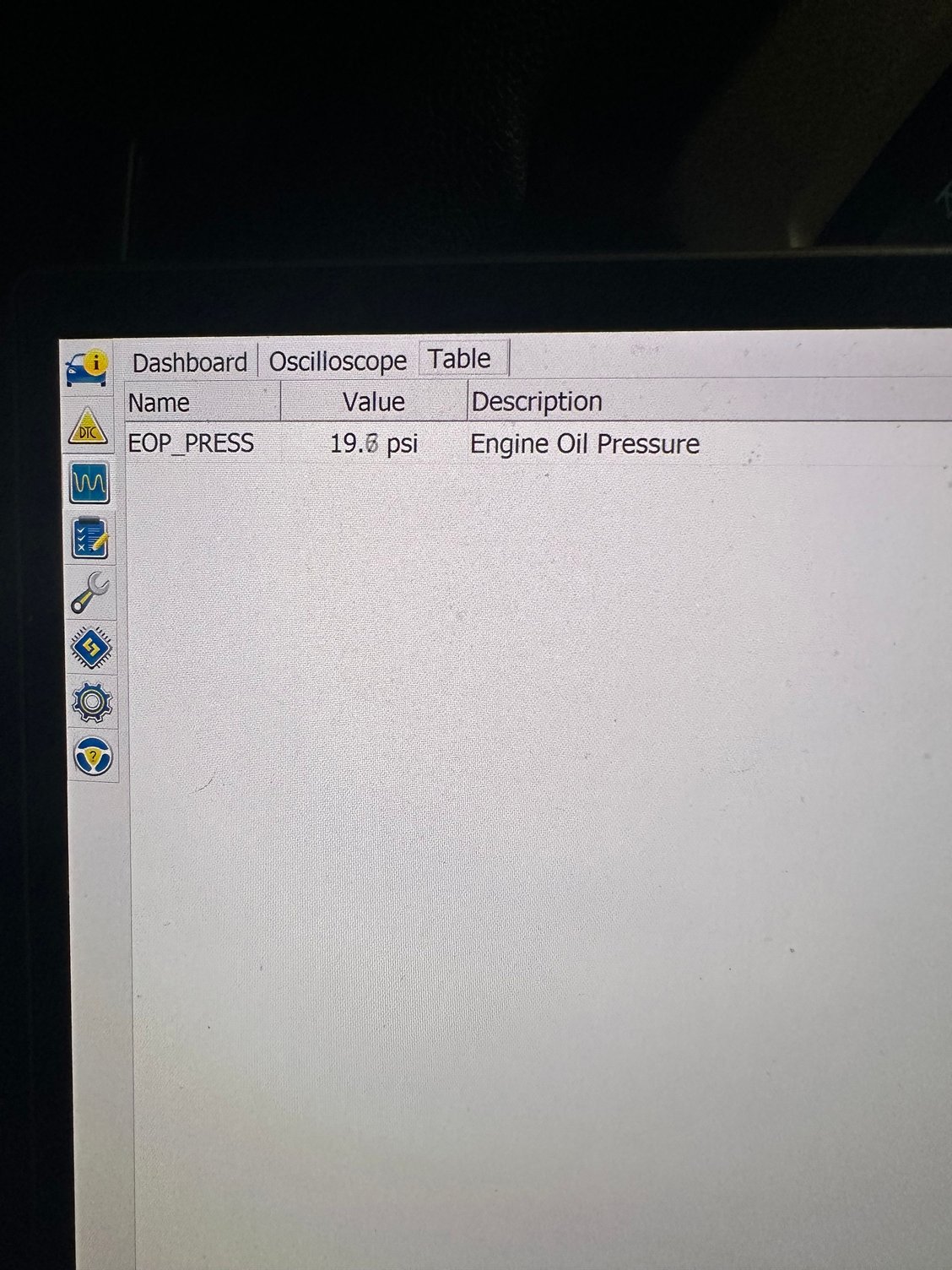

Decided to check oil pressure on my 22 with forscan after reading, I let the truck warm up about 15 minutes and dead idle pressure was bouncing between 19.6 - 20.8 psi. Was very easy to do
Hey there can you confirm a few things?
Looks like non phone version of forcan and you have a 2022 7.3. What ob2 adapter are you using?
I am only able to see voltage in the android version and not the actual value you are seeing. Also using nonsupprted ob2 adapter and wondering if I need additional protocols to see that value.
