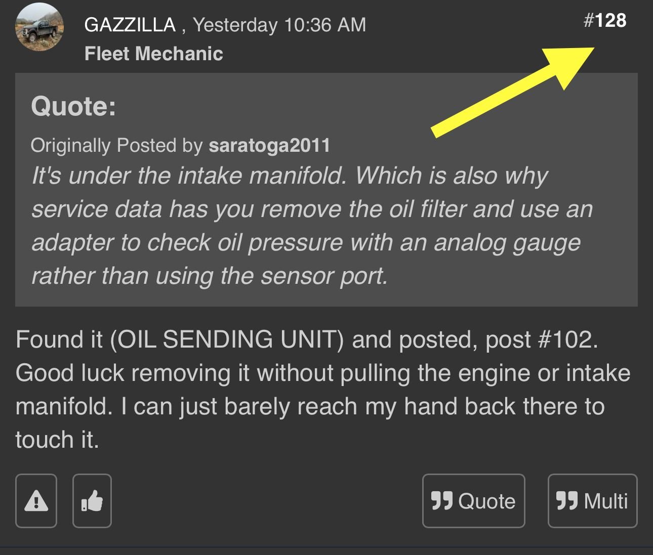

Originally Posted by Member No. 1
Sorry... Post #128
That post talks about the location of the oil pressure sending unit?
What am I missing?
What am I missing?
I think you have the oil pressure sending unit and the the oil pump pressure control solenoid mixed up perhaps?
Post #128 states Oil Sending Unit - That's what I was going by.
Post #102 looks to be an adapter you add under the oil filter as a place to get a mechanical reading with a gage.
Right, I was inquiring about the location of the control solenoid, not the pressure sending unit.
saratoga2011 has since stated it by the starter so we are good now.
