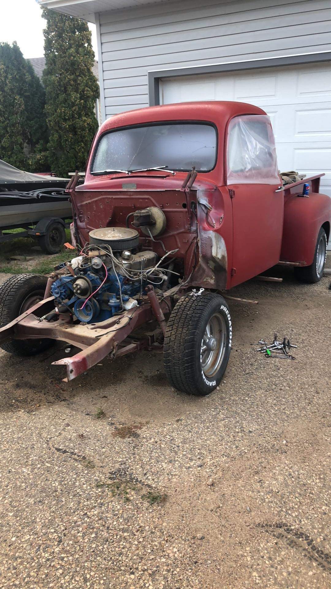

Returning to stock ride height using a donor frame from 1951. Want to get back to original wheels, and suspension for stock height.
I will retain the 5.0L power plant and AOD, or possibly use a different trans that will bolt up to my bell housing, 1990 Ford.engine.
I may have to start search for a 9" rear axle, since I would like to cruise at 60-65 mph.
I know some will consider this a backward step but my front frame horn clearance is 7 3/4", which kisses most curbs where I drive.
Really would like to retain same stock wheels front to back I am currently using a 2001 Explorer 8.8 rear.

Almost all of the above
Originally Posted by Old F1
Sober up, you drinking again, or taking bad drugs, or did you forget to take your Rx ?
Ha, too late, the deal is done. My donor :

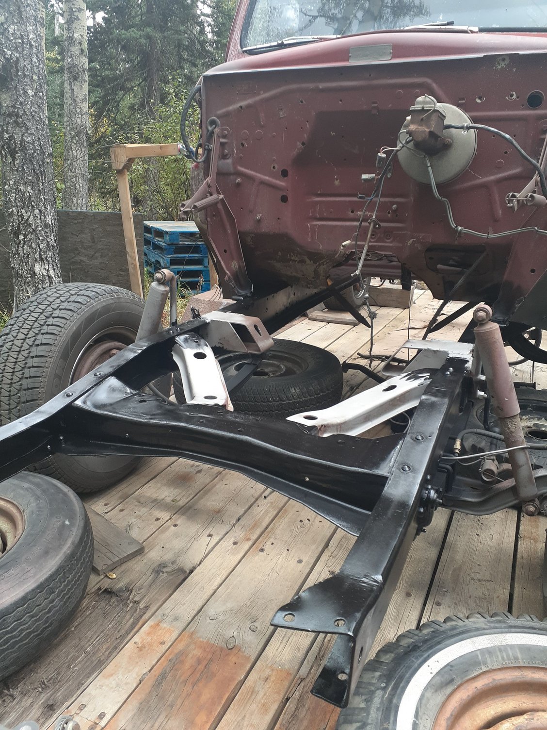

I sandblasted the frame today with cab on as I need help to remove it. Took me about 45 minutes. I will paint the frame rails with POR15 once the cab is removed. I etch primed the springs, diff and steering box for now until I can remove them.
Not completely blasted but better than wire wheeling.
Primed parts
So satisfying to see pristine metal. I will unbolt whatever is attached to the rails before painting them.

My original plan was to spray the frame with POR15 but since the cab is still on, I decided to paint it by hand, to protect the bare metal.
I left the bits unpainted that need removing or moving.
Forward movememt.

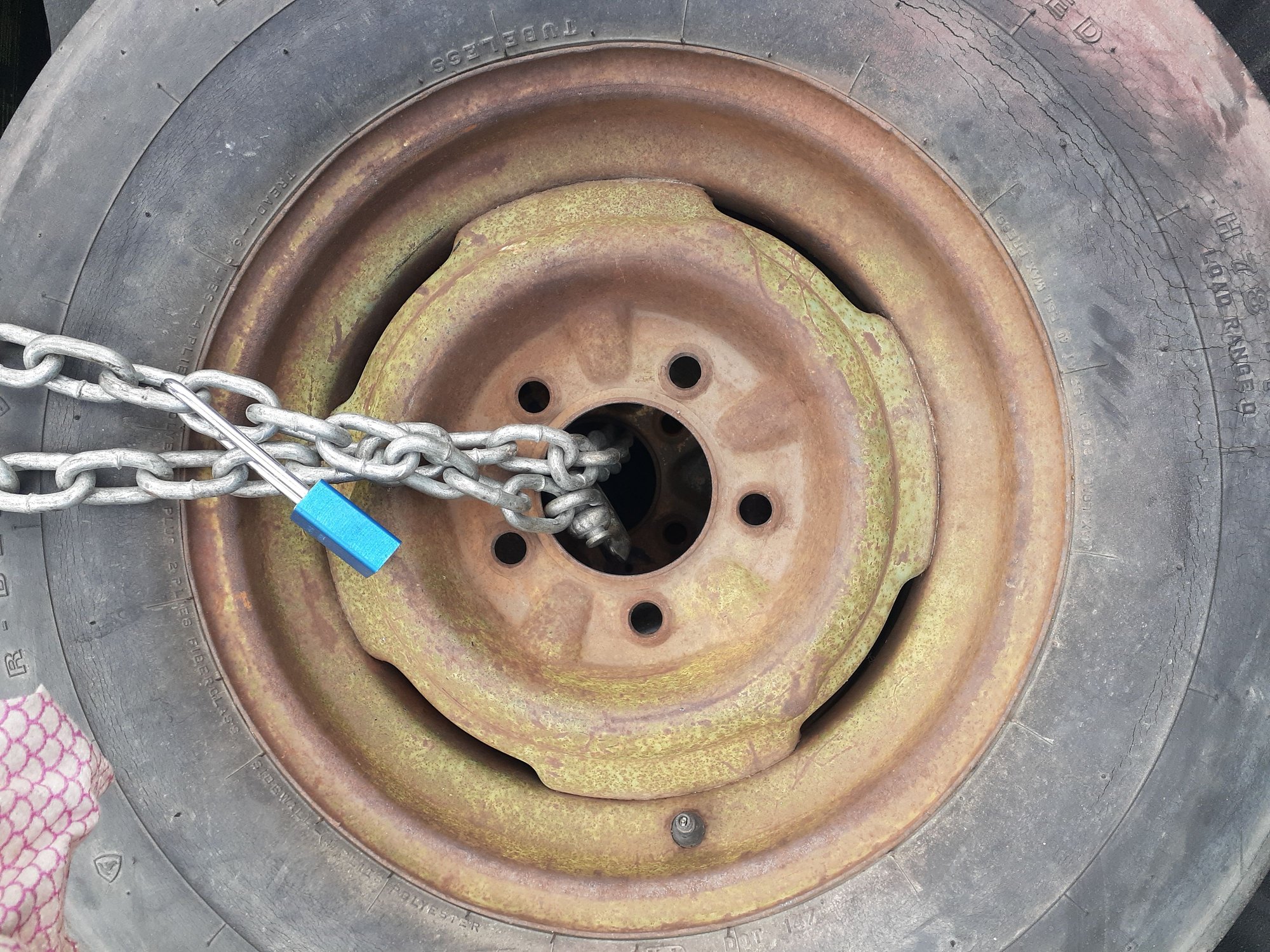

I had a successfull day finding 4 more 6"x15" rims to match two I already had. That gives me the option of choosing the best 5 for sandblasting.
i also found a truck 9" rear axle circa 1968-70 that is bound up but I will tear it down to see what parts are required other than bearings and seals. Happy days.
