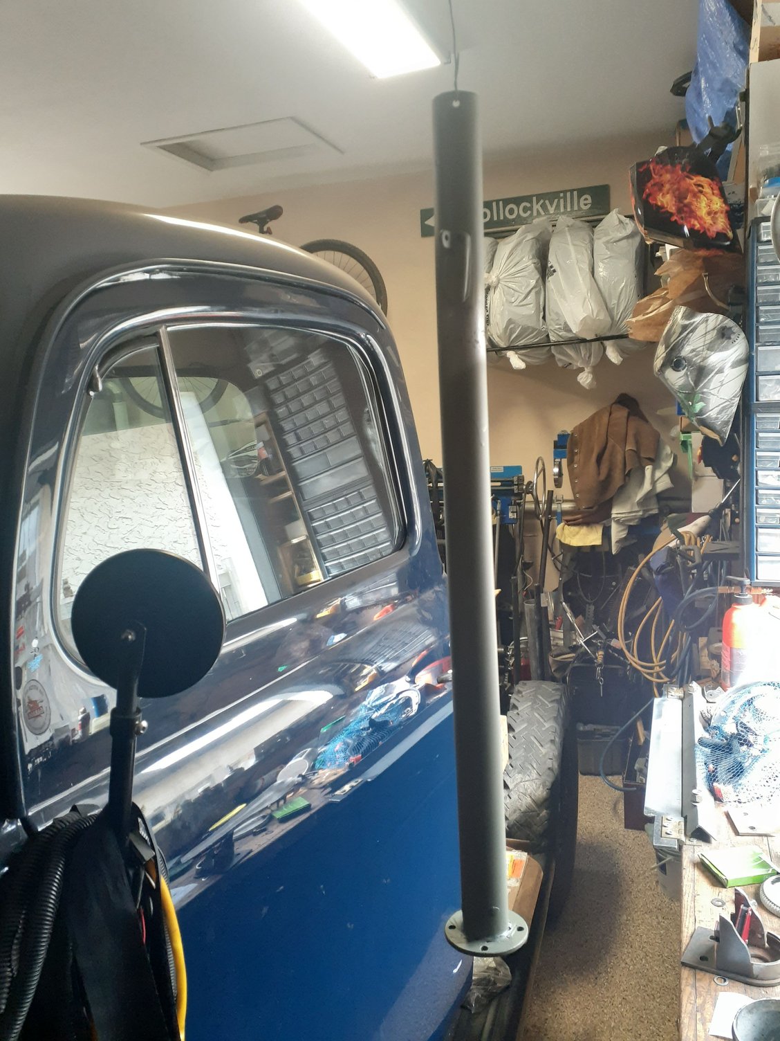

Steering column ready for paint.
Motor mounts tomorrows project.

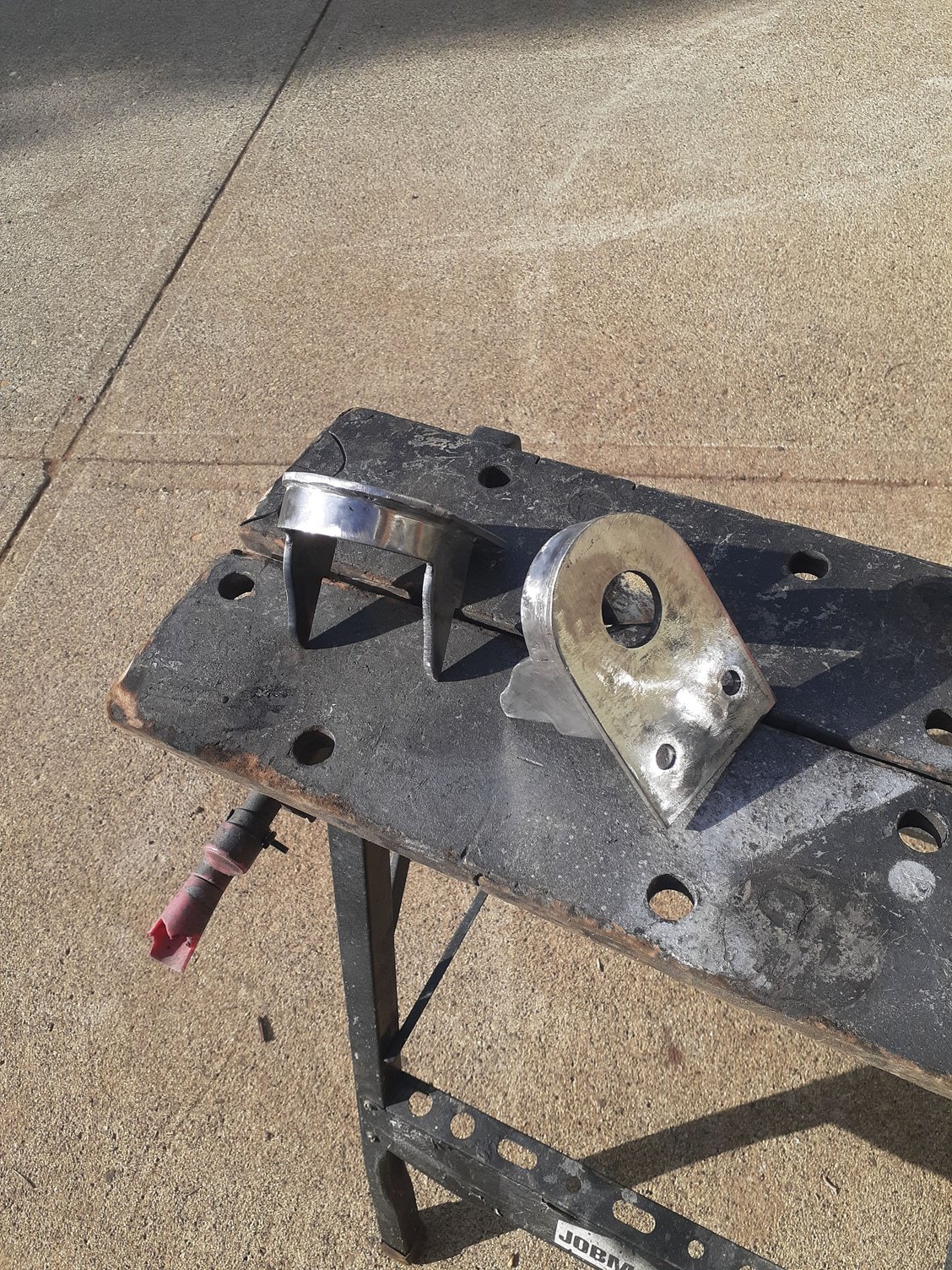

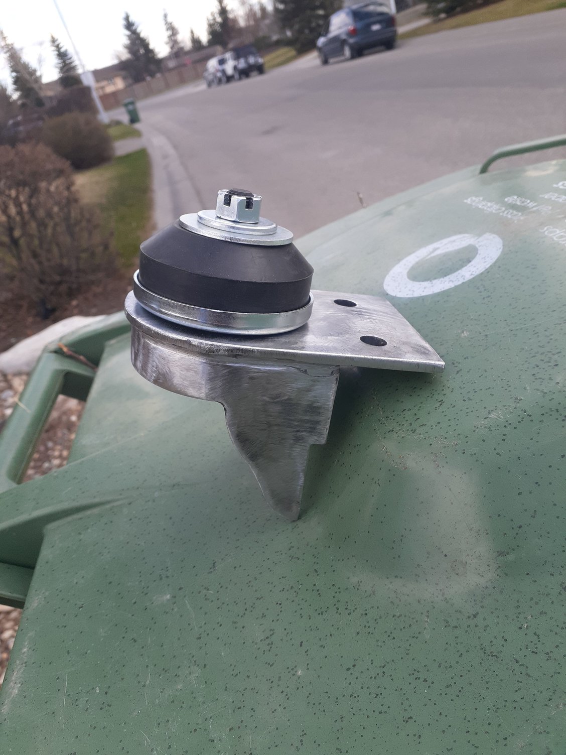

Motor mounts welded
A little more progress small steps. My plan is to bolt these to the boxed front frame rails.
Old May 12, 2022 | 09:57 PM
  #100
bobbytnm's Avatar
bobbytnm
Roast em' if you got 'em
Joined: Mar 2005
Posts: 21,997
Likes: 9,885
From: Rio Rancho, NM
Sweet
I got some similar biscuit style mounts like that for my roadster project. I think my Packard engine might be a bit heavy for them. It seems like they are "squashing" a bit. Mine are the style that have the nifty chrome cover over the rubber.
The biscuits are not solid rubber. I think I might have to refab the rubber bits out of a more solid source as my chrome cap is almost touching the lower bit of the mount.
Old May 13, 2022 | 07:57 AM
  #101
tip49's Avatar
tip49
Joined: Sep 2004
Posts: 2,757
Likes: 138
From: Alberta Canada
Originally Posted by bobbytnm
Sweet
I am sure you will find a suitable material to cut out to replace the rubber bits , hockey pucks or aftermatket bushings? Maybe an additional mount front or back ?

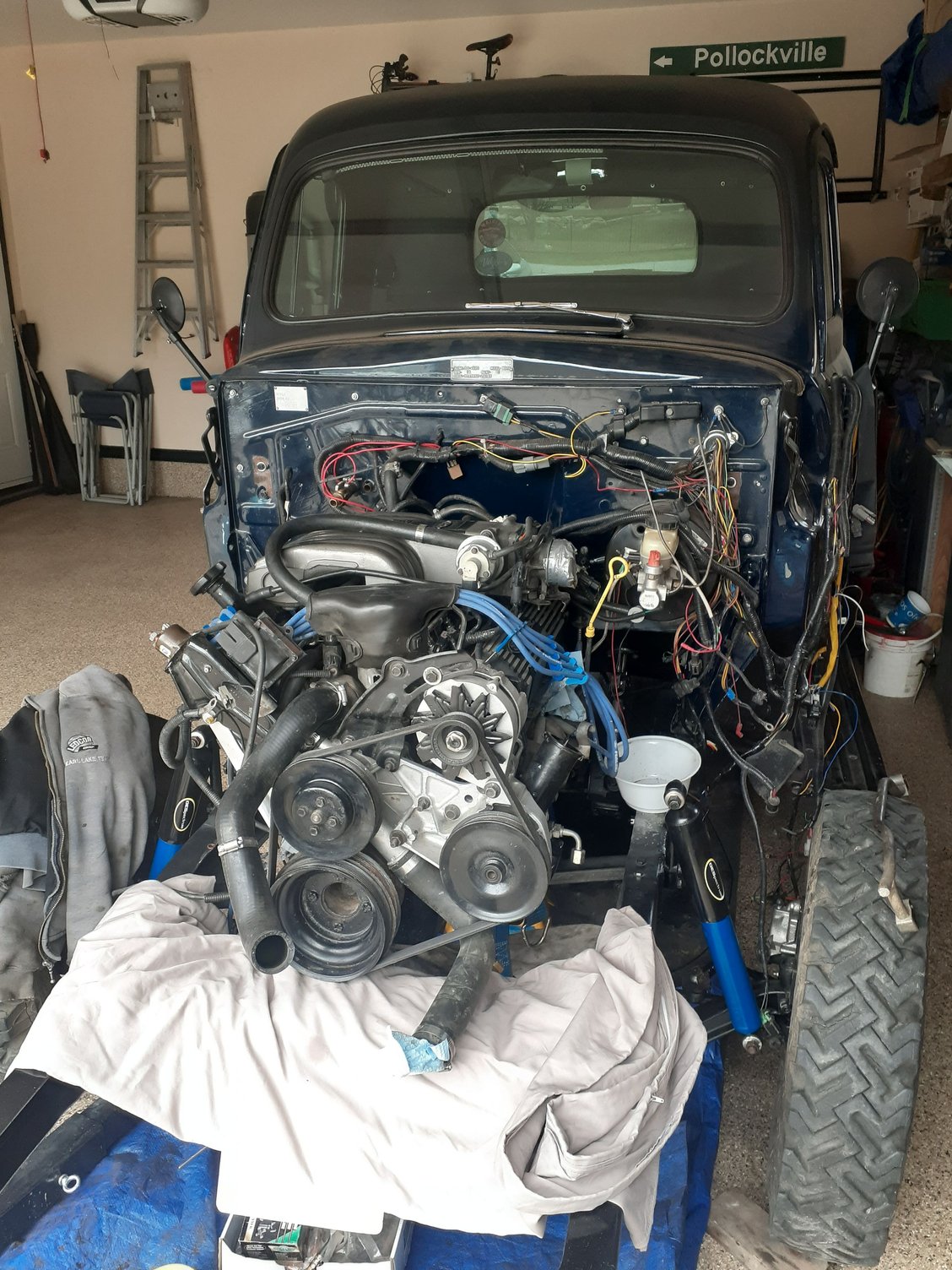

Motor/ transmission rough in
I got my motor and transmission home yesterday from storage.
Today I cleaned them up and started to get them into place so I can measure up for motor mounr placement and transmission cross member. I need to remove the exhaust manifolds so I can shoe horn things into place.
