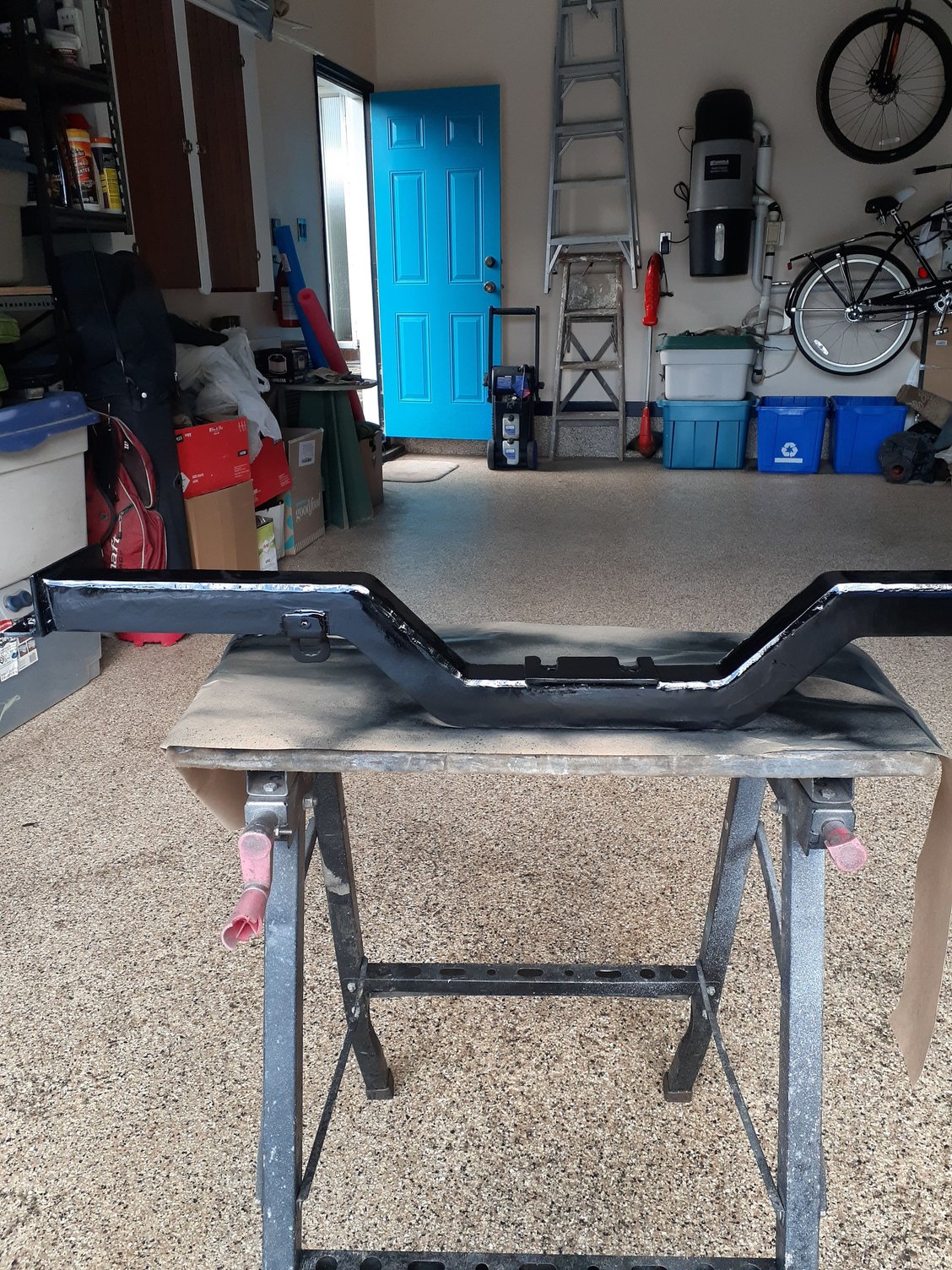

I dropped the driveshaft off this morning to be shortened and a 1310 yoke put on it.
I am waiting for the machine shop to brake some metal for the transmission crossmember. After that I can reinstall the exhaust pipes and sheetmetal.

More progress
While waiting for my metal to be cut for the crossmember I have been chasing and ordering fittings to complete my brake and fuel lines. I made a decision to use AN and braided flex for both fuel and brakes but have had some delivery challenges. I will shift gears and finish plumbing this weekend.
i welded up my transmission crossmember today so tomorrow I will install the driveshaft.

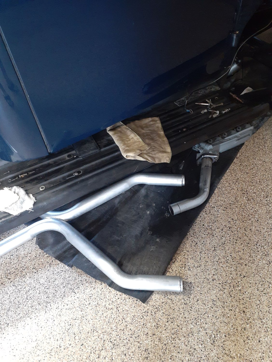

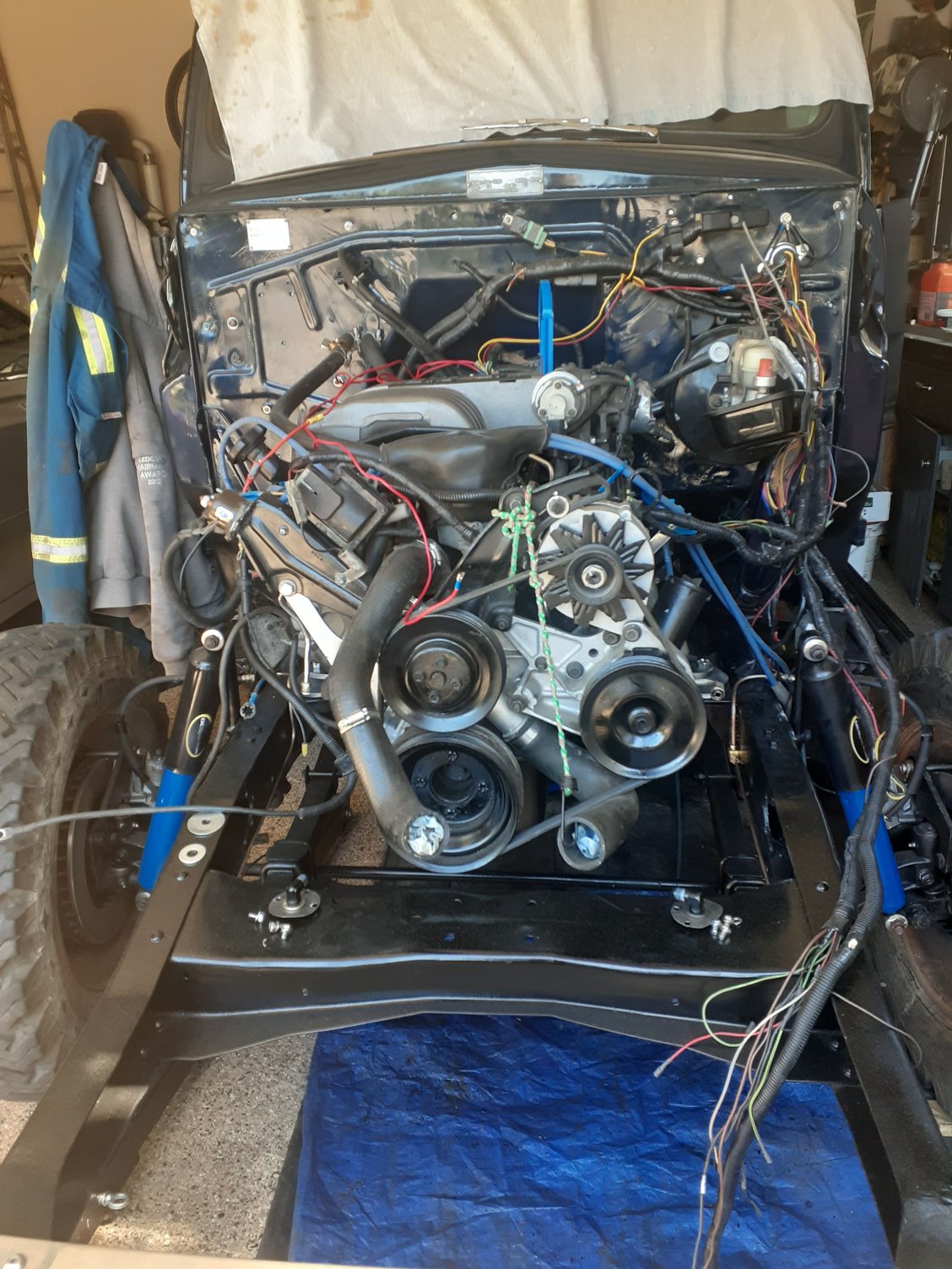

I deleted the power steering pump yesterday; back to the original steering box.
I started installing the exhaust today. I am going to section just behind the mufflers and route it over the axle if I have room.

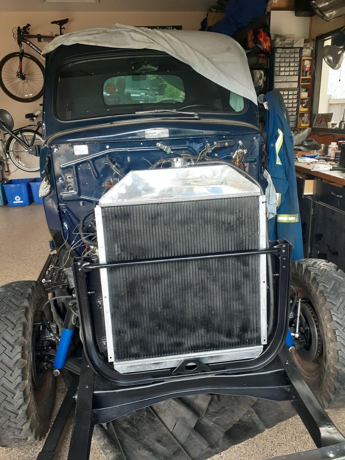

Forward movement
Today I did a bunch of measuring for the exhaust connections. While I am waiting on exhaust fittings I installed the radiator, and bent up the coolant lines.
Slow progress but forward movement.

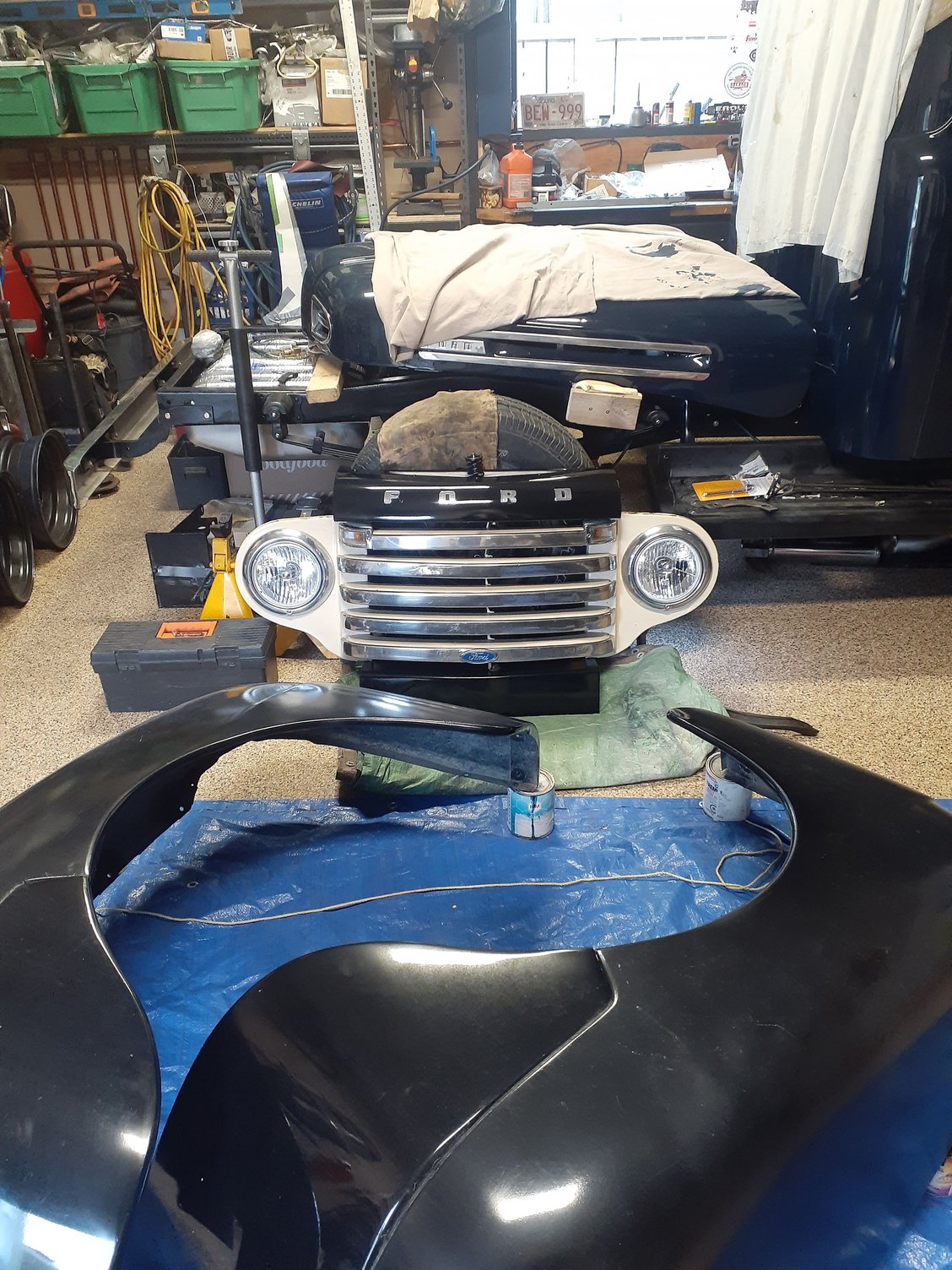

Dismantle front clip
Today I dismantled the front clip. It has been sitting under a tarp on my driveway for 5 weeks. I have one area that I need to address some bubbling paint on the driver side lower fender. Might as well tackle it now and the assembly will be easier for one set of hands.

Rattle can paint repairs
The grill top and bottom got painted body colour 15 years ago. Rattle can black now.
I need to concentrate on reassembly, to put some miles on, and look at repairs over the Winter.

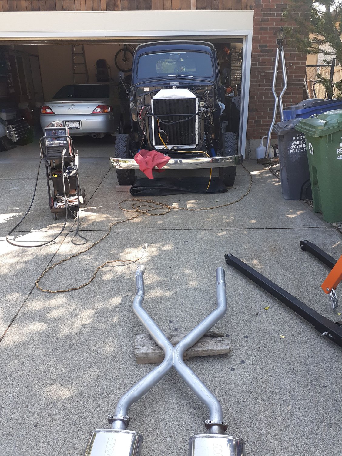

First fire since October
https://youtube.com/shorts/1t7FDwEpBZc?
Getting closer to taking the truck for a cruise. I have been finishing off plumbing, and exhaust system. Once I have brakes I will put sheetmetal back on.

Thanks Bobby,, progress is slower than I'd prefer. I am finding and fixing leaks in the brake plumbing and still getting the cross pipe in the exhaust to fit. The passenger side muffler interferes with the driveshaft. I hope to drive it before Winter.
