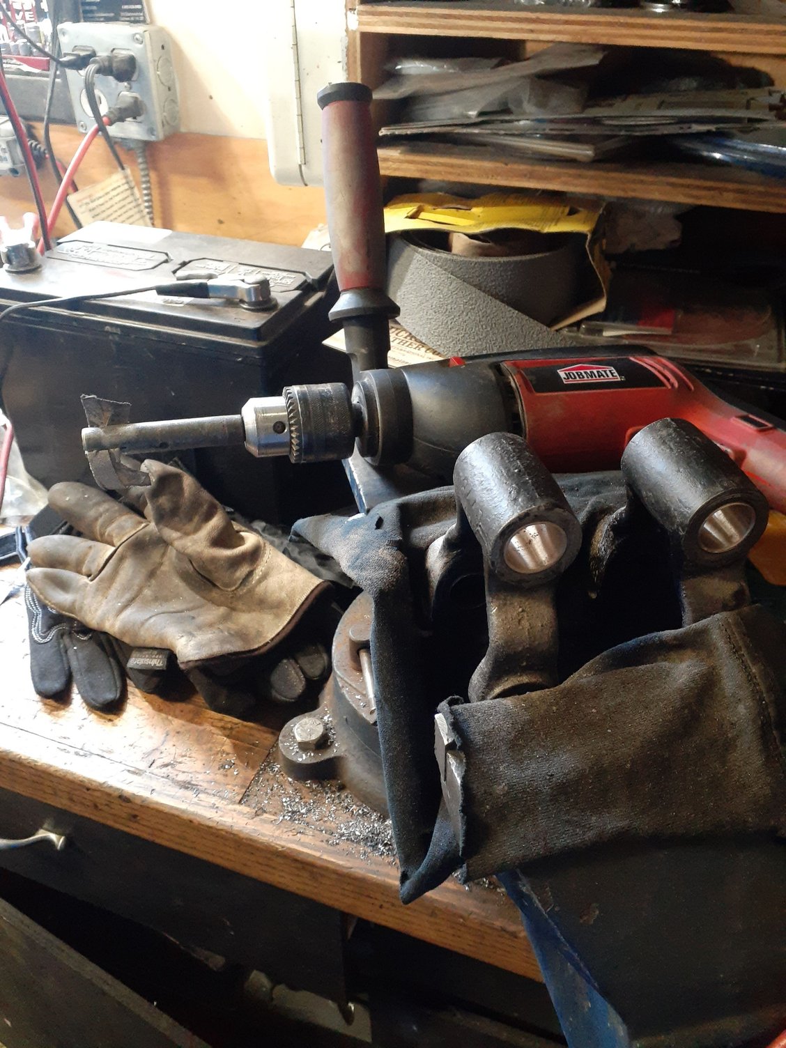

I had a couple hrs of time today to start the leaf spring reinstallation. I had to spend a bit of time to familiarize myself with the shackle hardware for both front and rear. The DC kits are not quite the same as the exploded drawings I have. An example would be the front pins 6 in total two of which are longer than the other four. I think they may go to the back on front spring but drawing shows all being the same part number. That burns up some time. I needed to hone the bushings so I thought I'd use the brake hones I have nope too big. I phoned around to tool suppliers but no luck. I happened to have a conversation with an older gentleman who suggested I make my own using a cut off bolt. I modified his advice a bit by using one of the old pins cut it off, and slotted the end. You then insert sand paper or emory cloth depending how aggressive you need to be. Great hack, works a treat!
I need to make one for the front bushings tomorrow, same proceedure.

Nice hack on the hone!! I did something similar awhile back with a wooden dowel. It worked all right but wouldn't have held up for this task.

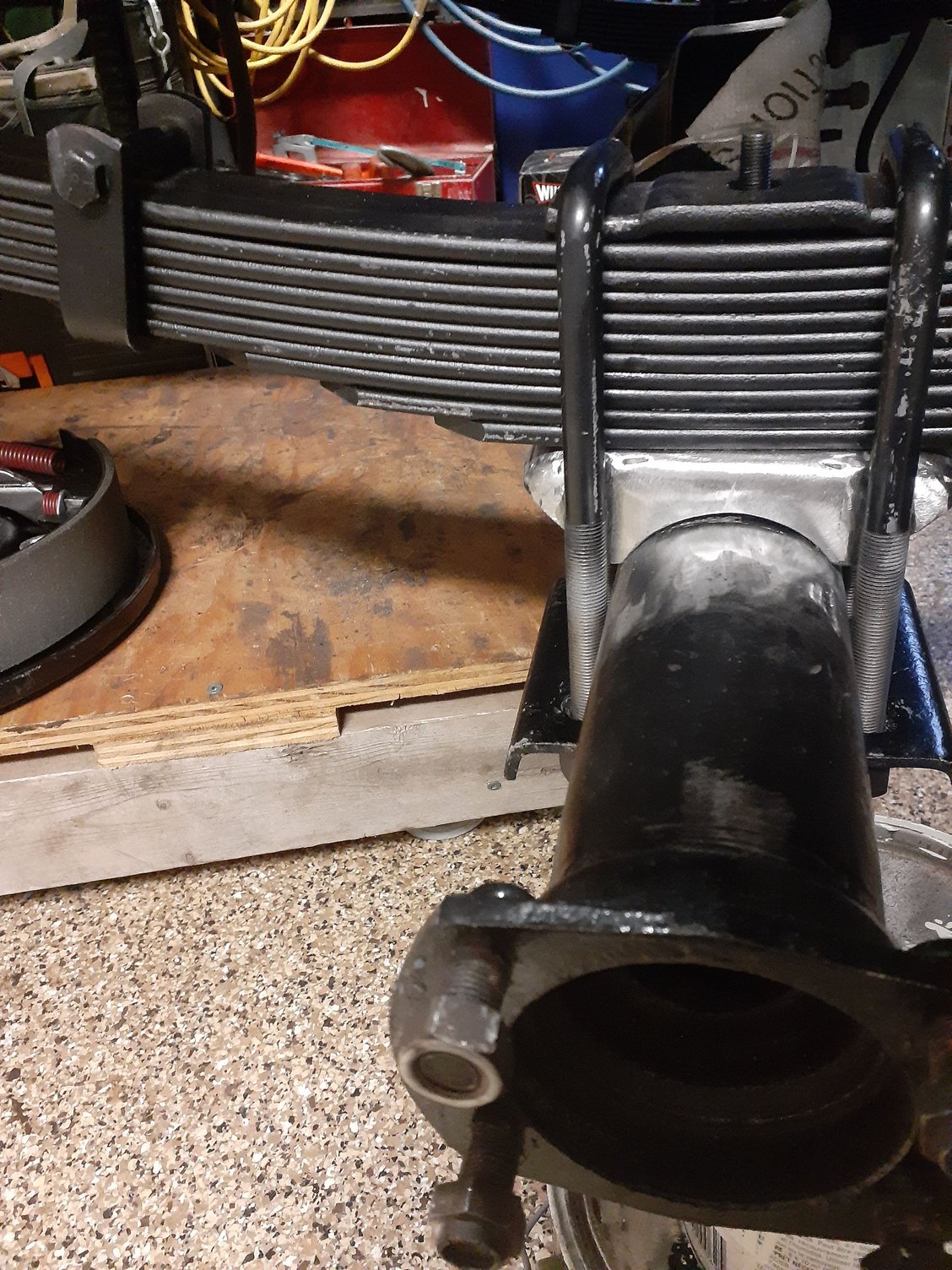

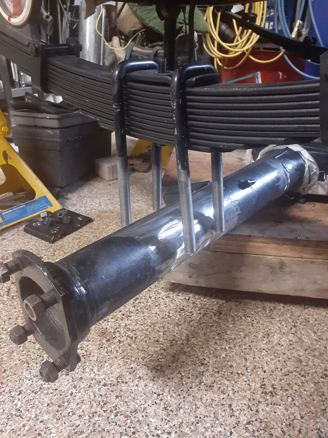

Got a little time today to work on the truck. I have been redoing the rear brakes and parking brake this week. I have a back order on a brake cable, so started prepping the rear axle by cutting off the spring perches.
I bought new perches and they are slightly wider than the originals. I will have to modify them so my U-bolts will clearance them. I hope to be ready to set the pinion angle before end of April.
Ready for fit and bolt up.
