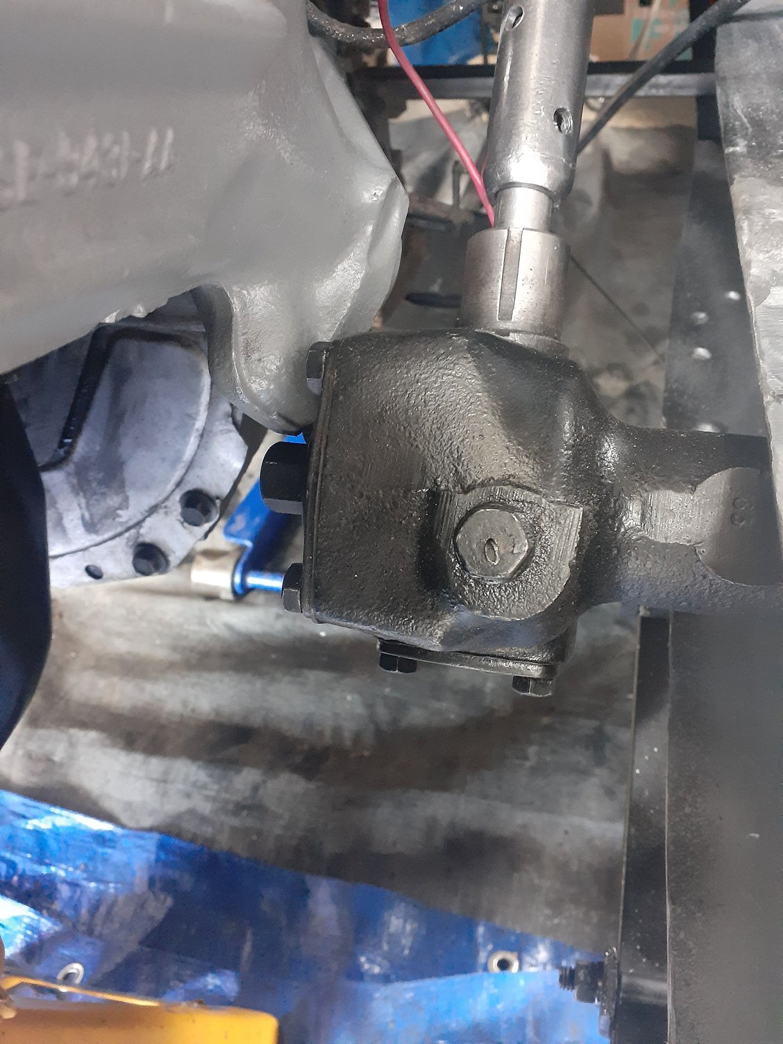

From: Alberta Canada
Small steps
I finished the steering box rebuild and installed it and the steering shaft today. I also roughed in the front brakes to location. Going to get the motor and trans set in in the next couple days. Hauled my scrap metal to recycle to clean up the garage a bit.

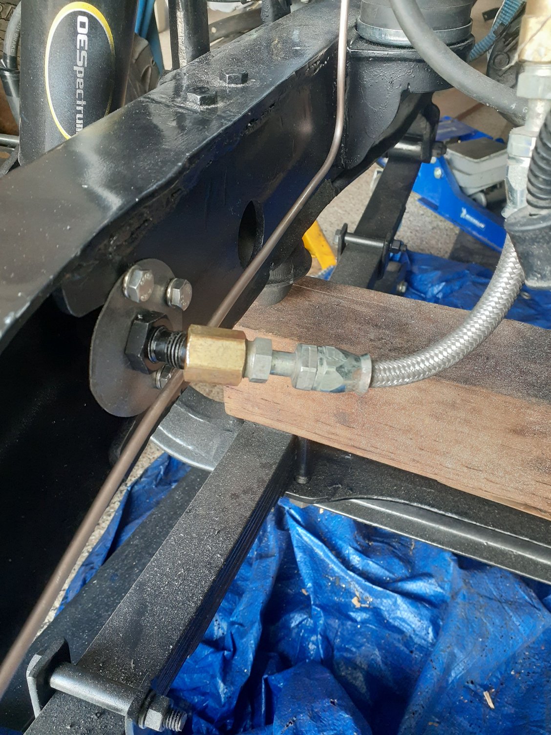

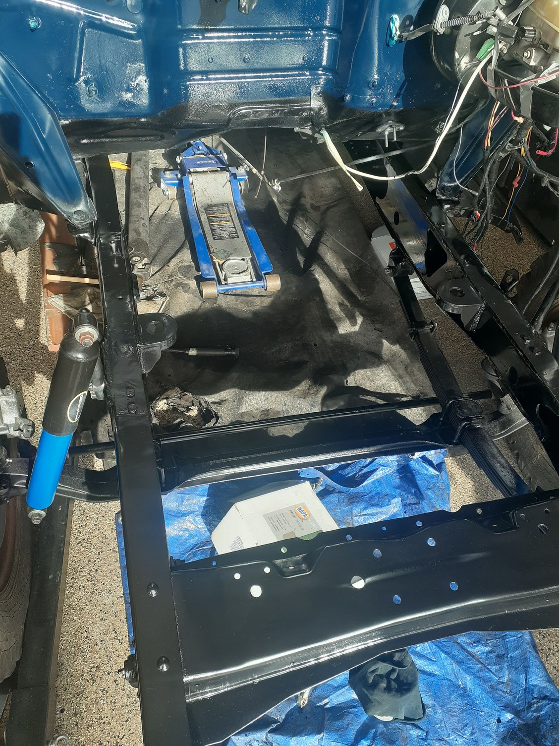

Mounting gas tank
I had to install.a crossmember to reinstall my gas tank on this original frame. It is welded in to support the belly straps I used to hold my tank in.
I will be roughing in my fuel lines this week.

Upper motor mounts
I picked up my upper motor mounts today from the metal shop. I had them plasma cut out of 3/8 steel from a template I made.
The driver side clears the steering box by about 1/2".
The passenger side exhaust manifold lines up with the frame notch I made. My endless measuring paid off as they fit good, and no clearance issues that I can see.
I may have to gusset the drivers side as it is longer than the passenger side mount, but I'm happy with the overall look.
I received my AN fittings so I also started plumbing the fuel lines today.
