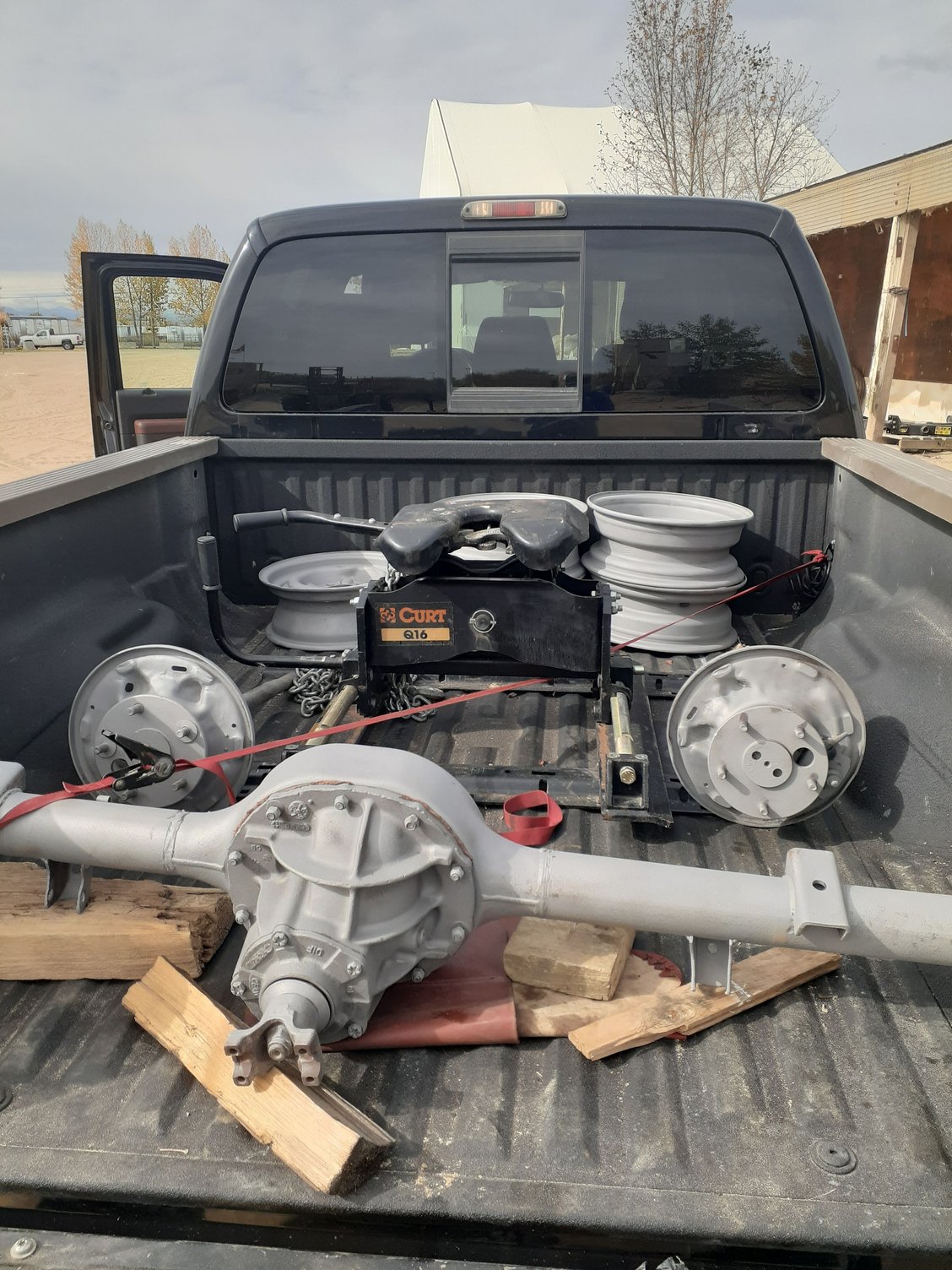

i managed to sandblast the rims I found along with the 9" rear today. The centre section was bone dry, probably for a considerable length of time. I have it basting in WD-40 to see if I can get it to turn.
I hope to salvage it but am prepared to replace parts if required. It is 28 spline, so may think about converting to 31 spline if pinion, ring and side gears are compromised.

Hit that diff with a pressure washer to start. You'd be surprised at how clean it will get. I also use Klean Strip paint & concrete prep (phosphoric acid) in a spray bottle or pan to soak rusty parts. Will not hurt the steel like muriatic (pool) acid will. I got the inside of my engine looking like new using it. I also just restored an old milling machine from 1948 using it. Looks new again.

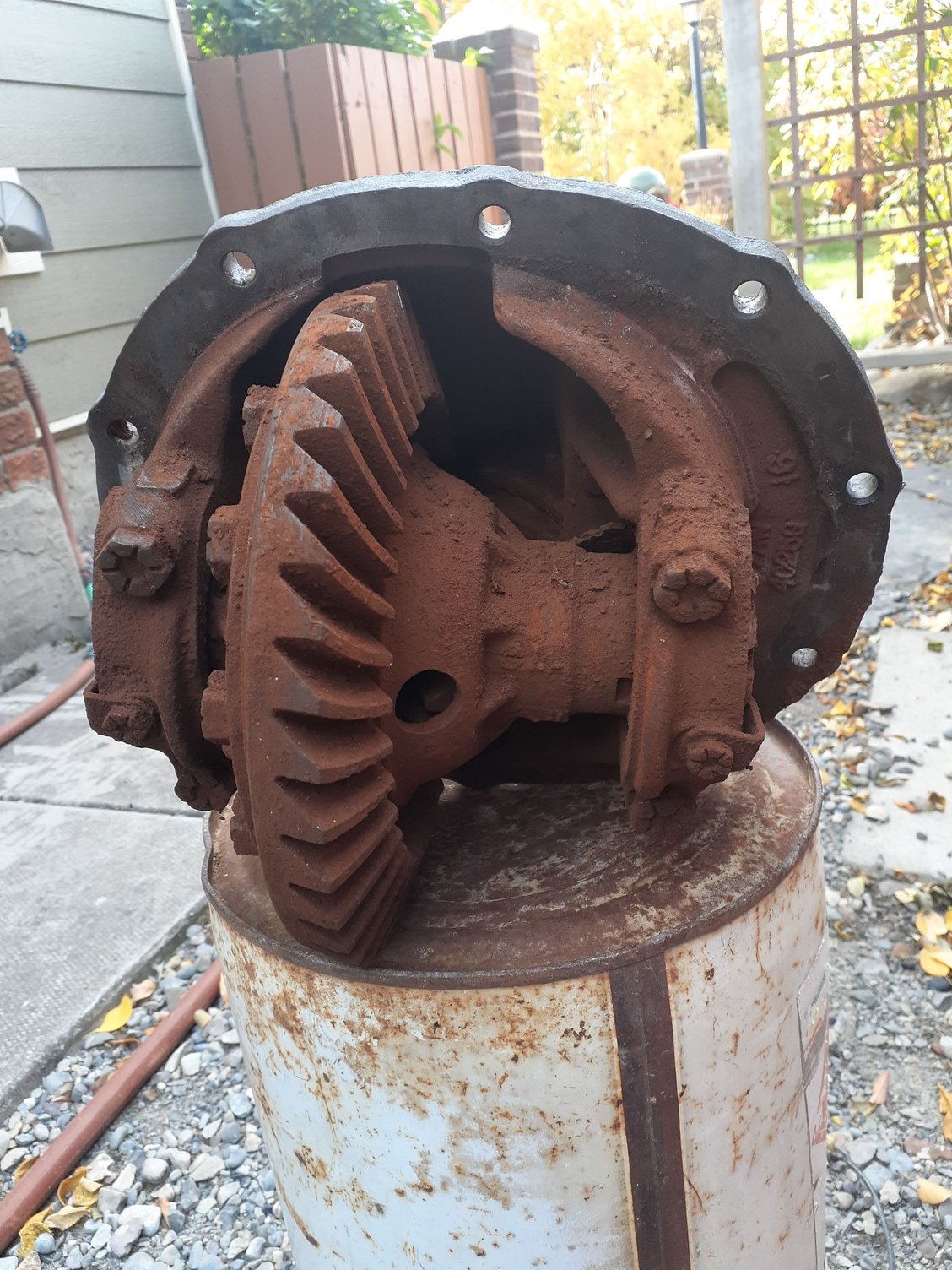

i did power wash the innards, then air and then WD40. I think I will use Rust Mort on the stubborn areas. I removed the pinion and ring gears and was able to free up the ring gear bearings. The ratio seems to be 39 teeth/,13 teeth, so 3:00 ? I will continue on the pinion tomorrow.
I asked Mr Google for answers on identifying the year and make of the case markings but this resulted in a circular trip. There is stamping of C7AW on the case it has 28 spline, axles 61 1/4" width flange,to flange on 5x 5 1/2 bolt pattern. I was told it came out of a 69-70 F100 . I want to order bearing and seal kit once model is confirmed. I may have to reach out to Number Dummy.

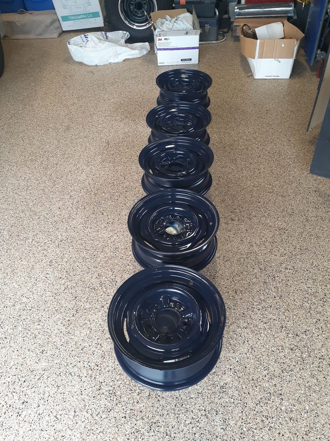

I did manage to paint my rims today.

Looks a LITTLE cleaner than your last pic.
Ha yes a little better. Did I mention the drain plug is seized in the case? So far oil and heat with an easy out have failed. It may require drilling and tapping.

The C7AW is a very common carrier, used for years. If you got the whole axle assembly with the truck axles and housing, it's likely the diff is original to that. On the 3rd member you should be able to find the casting date code, which will narrow down the year for you. The little metal tag that was once attached to the 3rd member attaching studs/nuts is the only accurate way to decode application.

I found this but not sure if it is the manf date. Reads 7B8, 1967 Feb 08?

That's it, the casting date of the pumpkin. 8 Feb, '67. Most likely then from a '67 F100.

Thanks Wayne. I tore the pinion assembly apart today removed the bearings. The ring and pinion gears have pitting due to rusting. I am going to take them into a gear shop for forensics this week. At this point it may be more cost effective to order a drop in 3rd member with different gear ratio and limited slip, retaining the 28 spline axles and case. I have 5.0L with AOD and 15" rims so thinking 3:50 or 3:73 ratio.

Actually, that sounds like a good plan. If you're buying bearings, gears, a LS carrier, and any other miscellaneous parts necessary, plus labor if you need to farm it out, it probably isn't that much more to order one done with your choice of ratio and be good to go.
