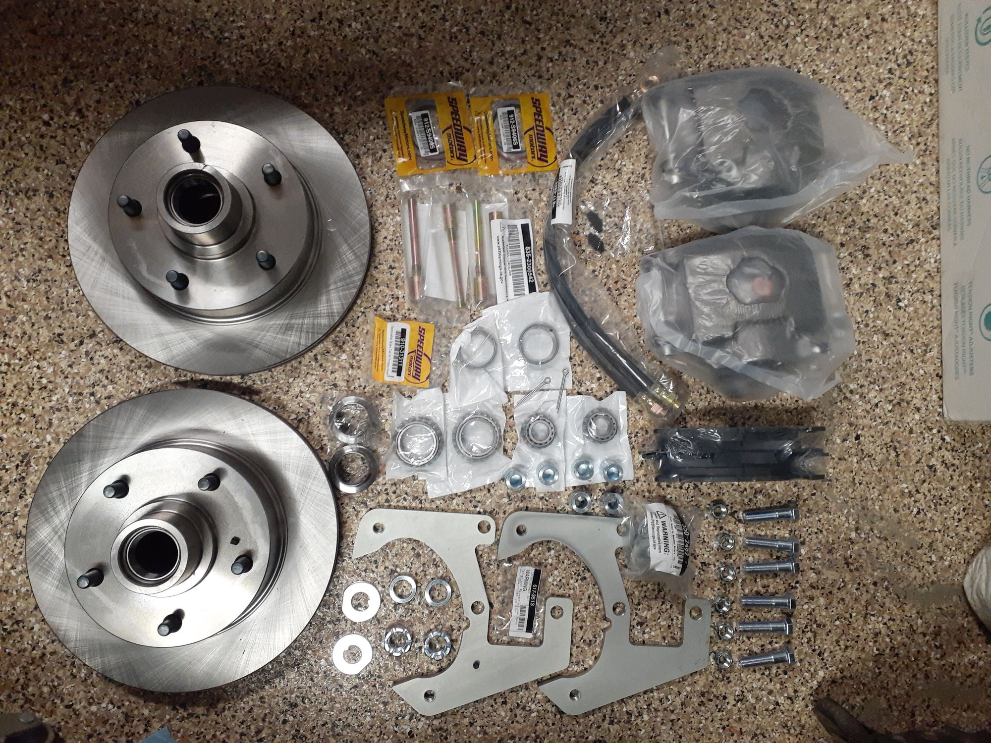

I received my conversion kit today from Speedway.The shipment boxes were damaged but I don't see any part damage.
Edit: looking at the photo I noticed what appears to be a dent on one of the rotor hubs.
I won't be installing the kit for a couple months. I am ordering new front springs tomorrow.

Kudos to Speedway
The shipment boxes were damaged but I don't see any part damage. Edit: looking at the photo I noticed what appears to be a dent
I contacted Speedway to make them aware of the damaged shipment, with pictures.
By end of day today they shipped me a replacement rotor. You can't ask for more than that. Only wish they offered better shipping to Canada, thats twice within the last 6 months my order has arrived damaged.

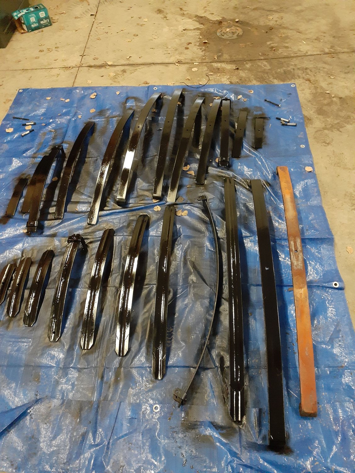

I picked up my new front springs a couple days ago. Yesterday i finished dismantling the rear springs and painted them all.
Today I will loose assemble them and take the rears in for some repair to the brackets that are riveted to some of the leaves.
They are shiney and look good. One of the rear springs has a fractured leaf so I will delete it on both sides. Time will tell how they will resist rust.

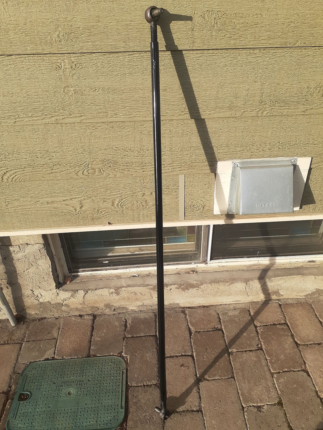

i straightened the steering rod today. There was a bend 16" from one end that gave it a 11/4" kick up. I used my press and a jig I welded up, to straighten it.
I hope to make some progress on suspension install next week.
