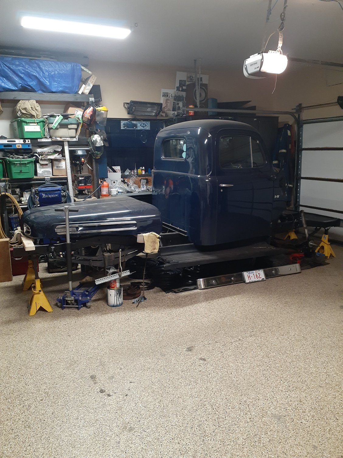

I hear that Jim . At 72 I seem to take longer to get things done. That said in 2 days I had the body parts off and removed the motor and trans. Today I finished with mounting my cab on it's "new" chassis. I am now 3" higher in ride height.
My goal was to transfer both cabs over to their respective "new" homes. Mission accomplished. I may start on installing new motor mounts and trans crossmember, if the weather stays warm.

Hauled chassis and cab home today
I hauled my nephew's cab and chassis to him this weekend past. I hauled my truck home today, for winter storage.
i looked into 239 flathead motors on the weekend, $300;-800 depending on froze or turning. Going to ruminate on that over the winter. I have 400 miles on my rebuilt 5.0L so may sell it for a flathead build.
In the spirit of restoration I have decided to open up the Dana 44 diff to check the gear ratio, and its condition. To keep costs down I would leave it open carrier. I can always have the 9" rebuilt down the road.
Parts for front suspension are on order.

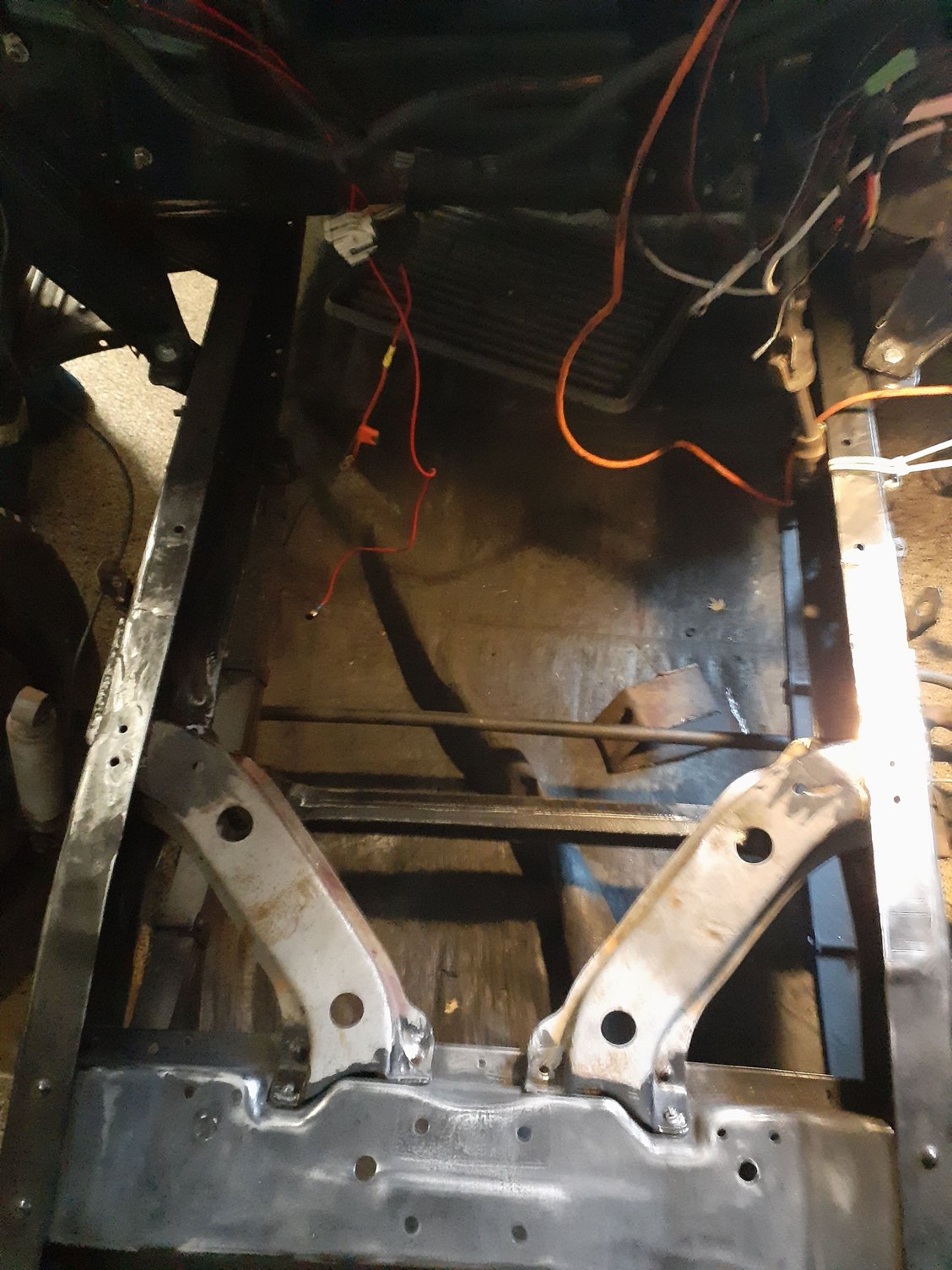

Engine mounts removed
I removed the engine mounts yesterday from my frame. The PO had welded across the top of rails so I have some concerns about the effect on the structural integrity.
I may have to plug weld some flat bar inside the top of the rail before I box the sides. I also will have work around the shock mounts and steering box. I'll clean up the old welds first then start plumbing the fuel and brake lines.

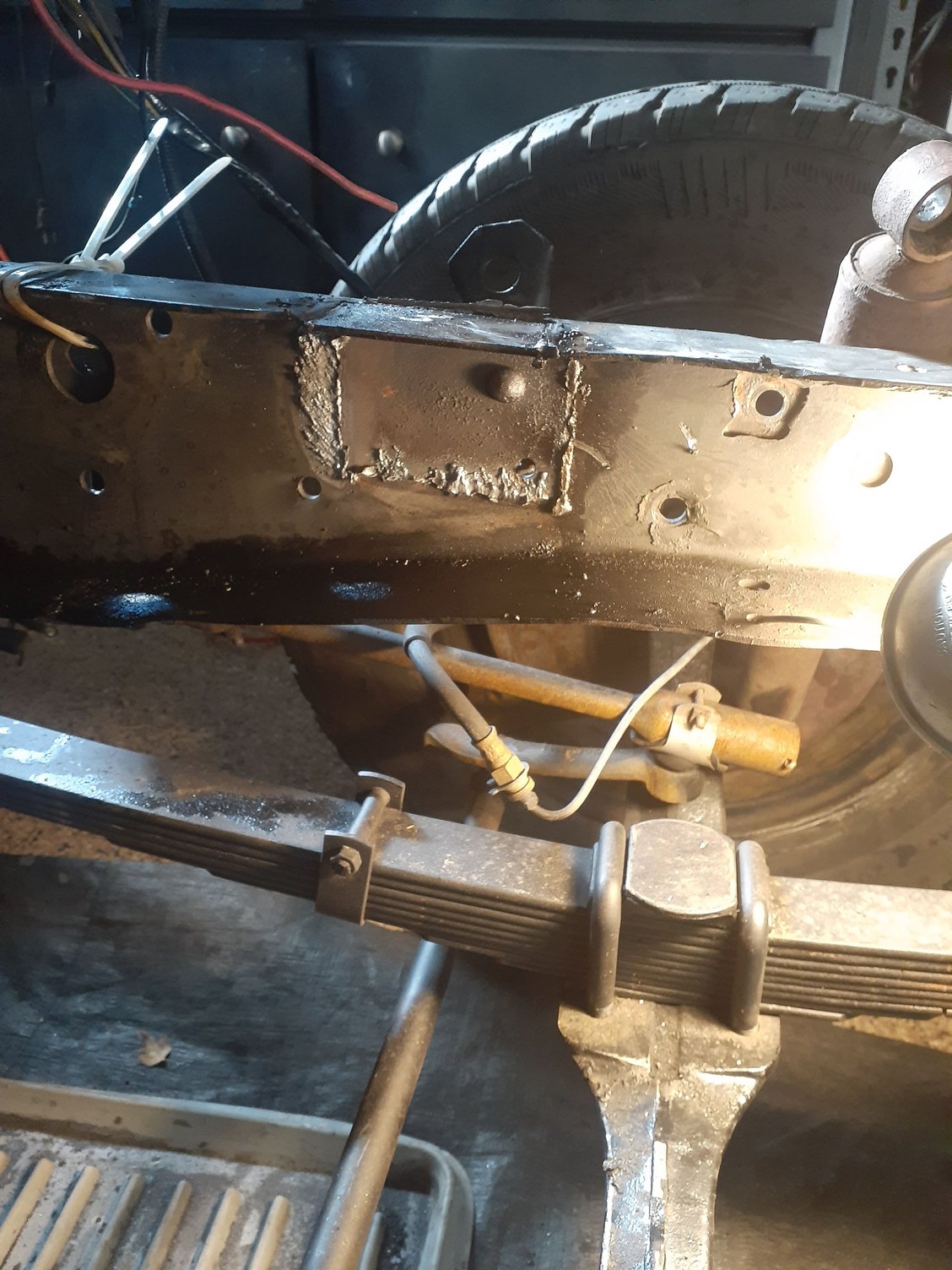

The weather was 2 C today so was able to get out in the garage and start cutting off rivets and a rear hitch the PO had welded in. This will facilitate moving the rear cross member to the back of the rear frame rails.There is more repair required in this area too. Going to pick up the metal for reinforcement and boxing this week.

I started repairing and boxing the front section of the frame today. Plug weilded a fish plate on the inside of the top rail. Will then box that section to reinforce the area.

I have the front fish plate installed both sides of the front frame and welded nuts on the inner frame for shock towers, battery tray, etc. I also repaired the driver rear where the PO had "grafted" a tow hitch.
I am going to make templates for both sides to box a 3 ft section from front crossmember to cab. I'm going to cut a "triangular" shape access for the steering box then start plumbing fuel and brake lines. Once that is done I'll clamp the plates in place and locate bolt on motor mounts.We are still having above freezing days so some progress being made.
