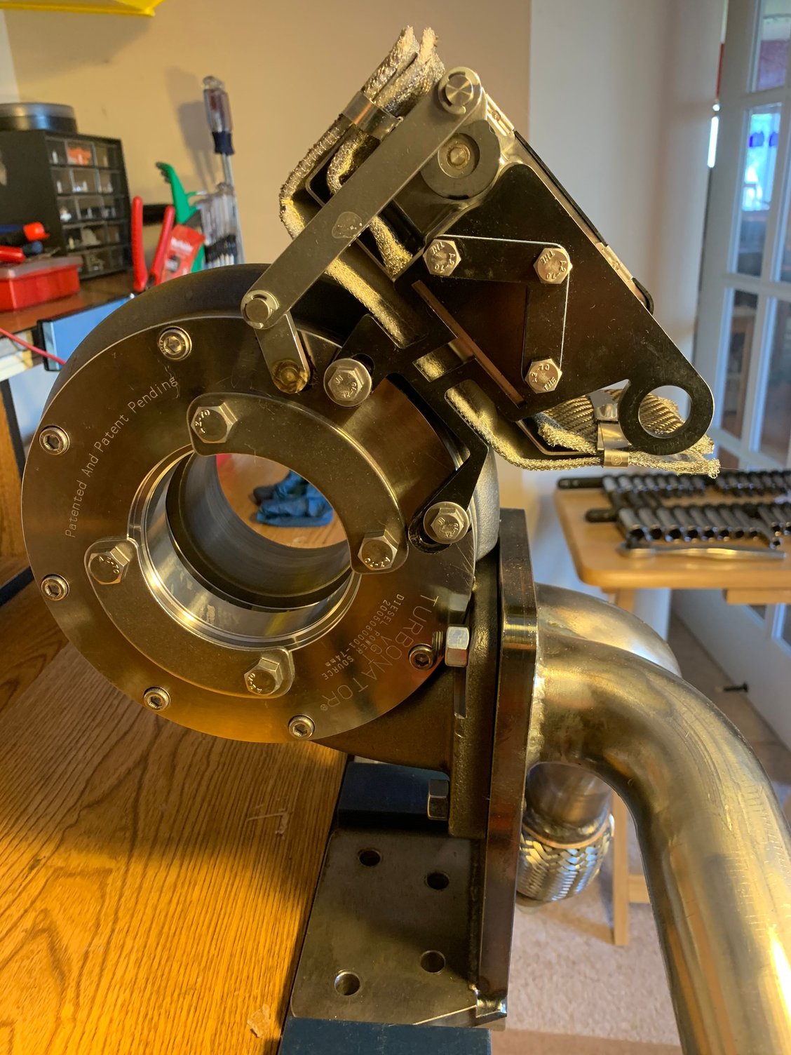

Performed a quick, uncalibrated reclocking for another mockup today.

I don't see that orientation fitting under the cowl.
