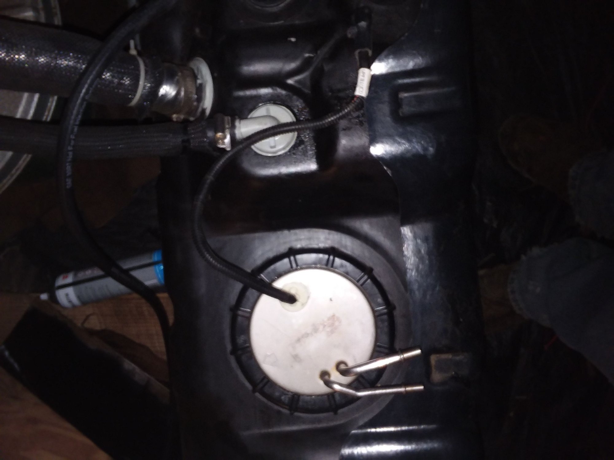

Does this look right? I doesn't seem right to me. I'm thinking the fuel lines are facing the wrong way. I noticed when I put it back together that there was a slot in the neck of the threads and a little tab on the sending unit with a arrow. I figured the tab went into the slot. after a bit of aligning the big nut everything went right together. Sliding the tank under the truck it looks like the lines are too short or facing the right way.

The lines on tank should face the frame/away from center of truck.
