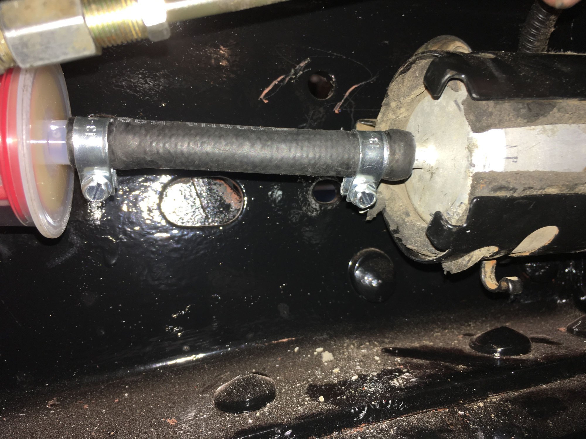

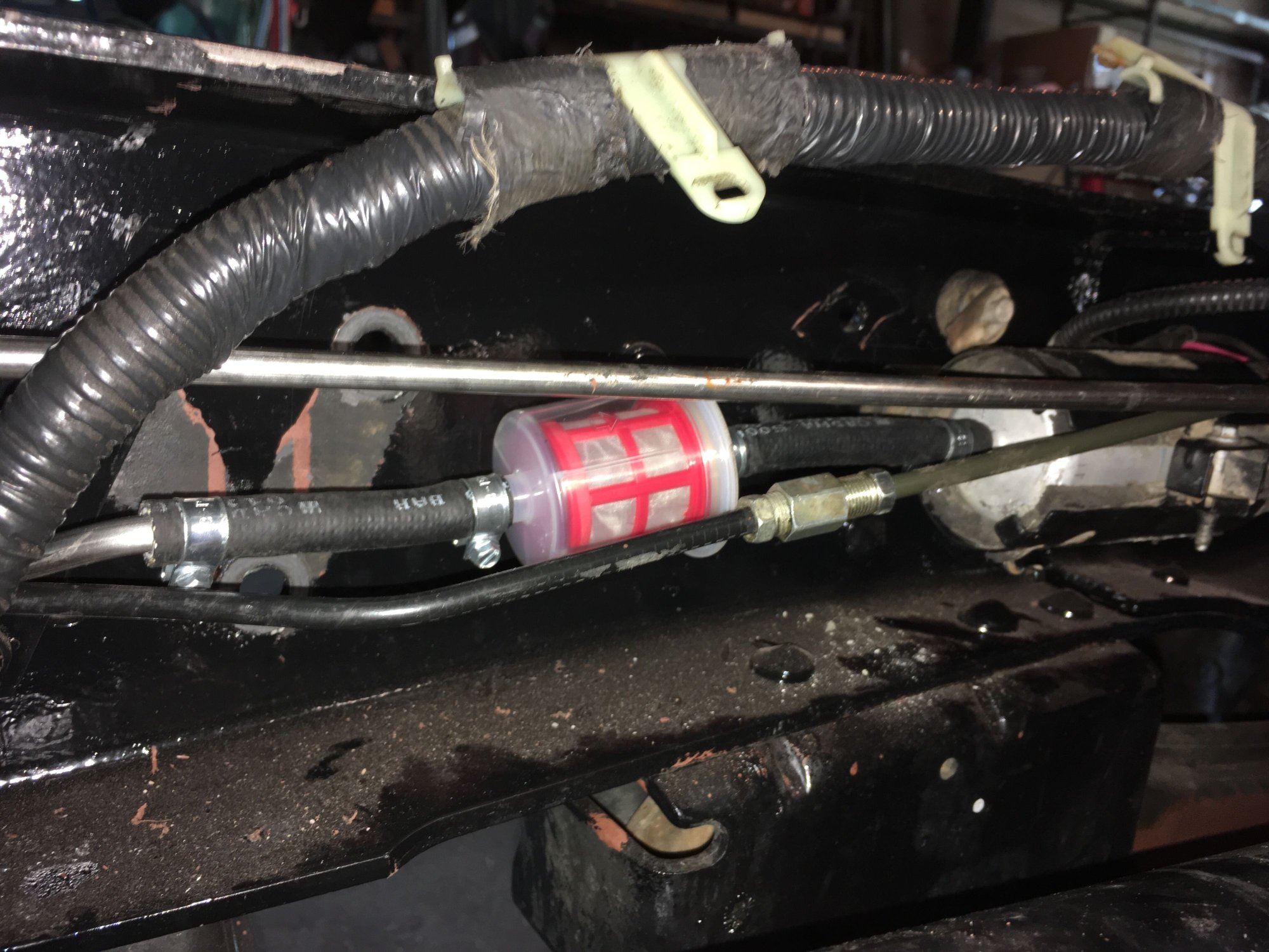

I got the filter and clamps and the tank is done and thoroughly cleaned. Now there is a barb on the filter ends but how did you form one on the metal lines? Also took the time while the tank was out to lightly blast the rusty crusty stuff and paint the underside and inside the frame.

The only metal line you should have left is on top of the tank where you attach the rubber fuel line too. You will not need a barb, just clamp your line and run it to the filter.

For the metal lines near the filter I heated the hose to slip over the flange at the pump and other side. I then double clamped the hard lines on the outer side of the flange.

I don’t do it that way.
If you cut the flex hose hose off the hard line behind the pump, there is a ‘barb’ on the hard line. You’ll only need <1ft of 30R9 and the 33972 filter goes in that.
You MUST use ‘fuel injection’ hose clamps.
I do heat the hose to push it over the ‘barb’ on fuel pump.

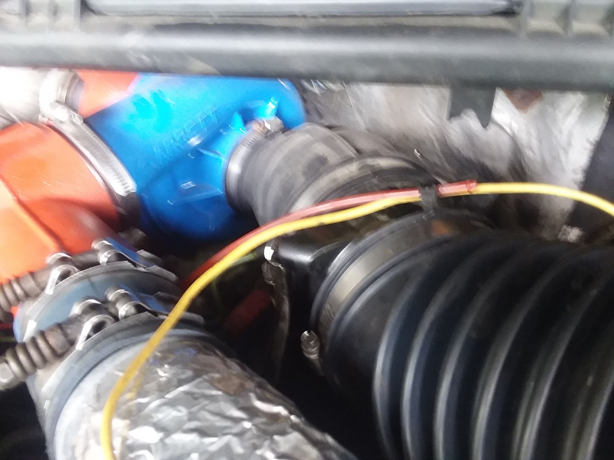

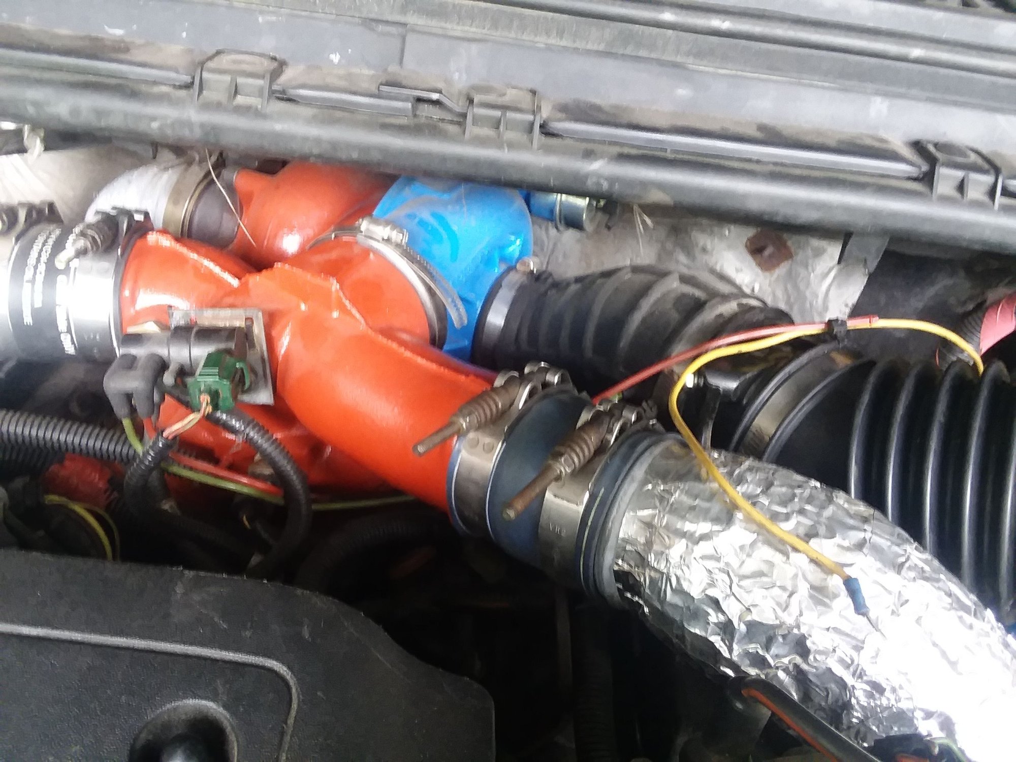

The pics shows the red hose and for the life of me I don't remember what it goes to. looked through all my before disassembly pics and covered up in the pics. Can you help please? I do want to hook it up too and not eliminate it for now.
My goal was to get this thing started this weekend. No tank installed yet and I first want to turn over the engine to get oil pressure before I start it. Couldn't find the fuel pump relay and seems like no info anywhere however I discovered that the #40 fuse is for the fuel pump so I'll pull that.
Old Sep 13, 2020 | 04:13 PM
  #160
RacinJasonWV's Avatar
RacinJasonWV
Joined: Jul 2017
Posts: 6,855
Likes: 2,332
From: WV
Red hose goes to the wastegate controller. Red arrow in photo below. Looks like the 90* boot has came off the hose and is still connected to the controller.

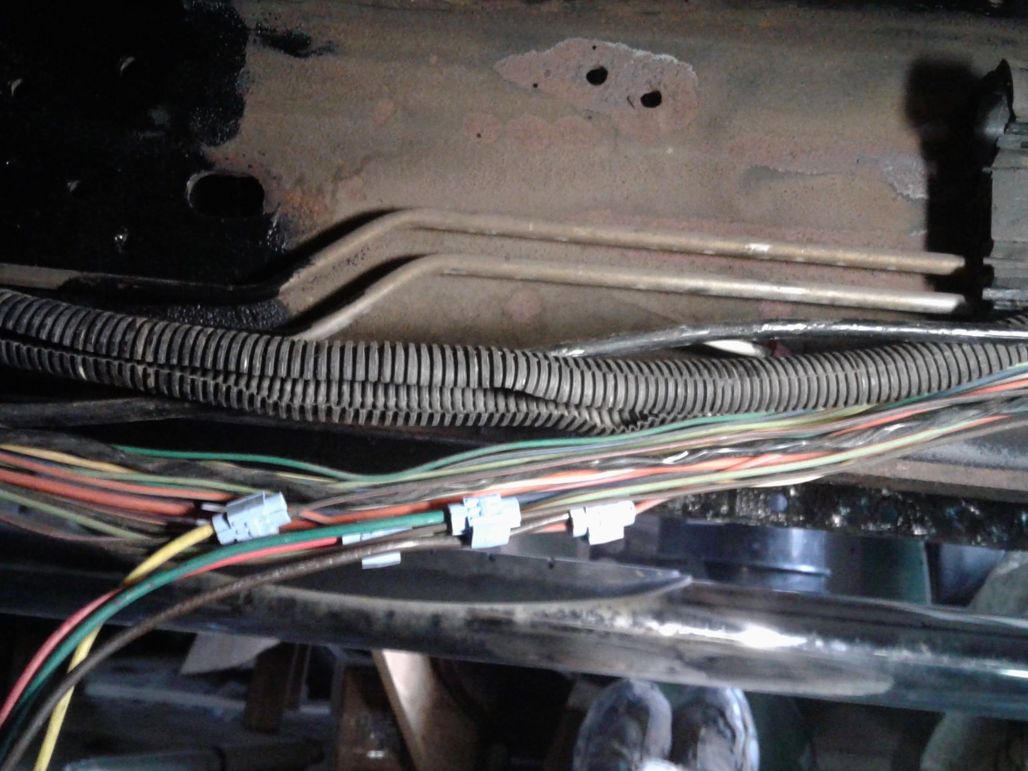

There were some wire splices in the main harness going to the back of the truck. Don't know what this was spliced in for but a poor job using Scotch Locks. I removed them and some of the wires had a bit of green corrosion on them. Used a contact cleaner to remove corrosion and then used a brushable electrical tape to seal them. Then a good tape job on top of that. Found other wires where someone was probing and didn't bother to seal the insulation with anything. One larger red wire was corroded in half inside the insulation. I noticed a little green dot and the wire was a little fatter around the dot. Sliced some of the insulation back and saw what I thought I was going to see.
pic # 2. I have no clue what this device is for. There "was" a wire about 12 gauge from the + side of the battery to a relay then to the canister (pictured) back out the other side and followed the harness back and taped into that new harness. What ever it was used for ether wasn't needed anymore or it failed because it was cut off 2 feet past those splices. Any ideas?
