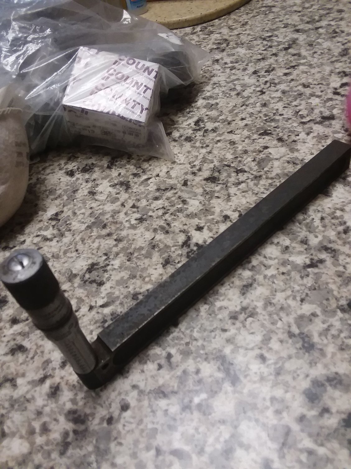

Did a quick check today between rains. The manifold is completely flat. The wobble is in the head. Used my tool in the pic and placing it between 1&2 no wobble. (actually don't know Fords cylinder order) Between 2&3 and doing it backwards 3&2 I get between 4 & 6 thousands. 3&4 are fine. Don't have a straight edge yet to place between all 4.
