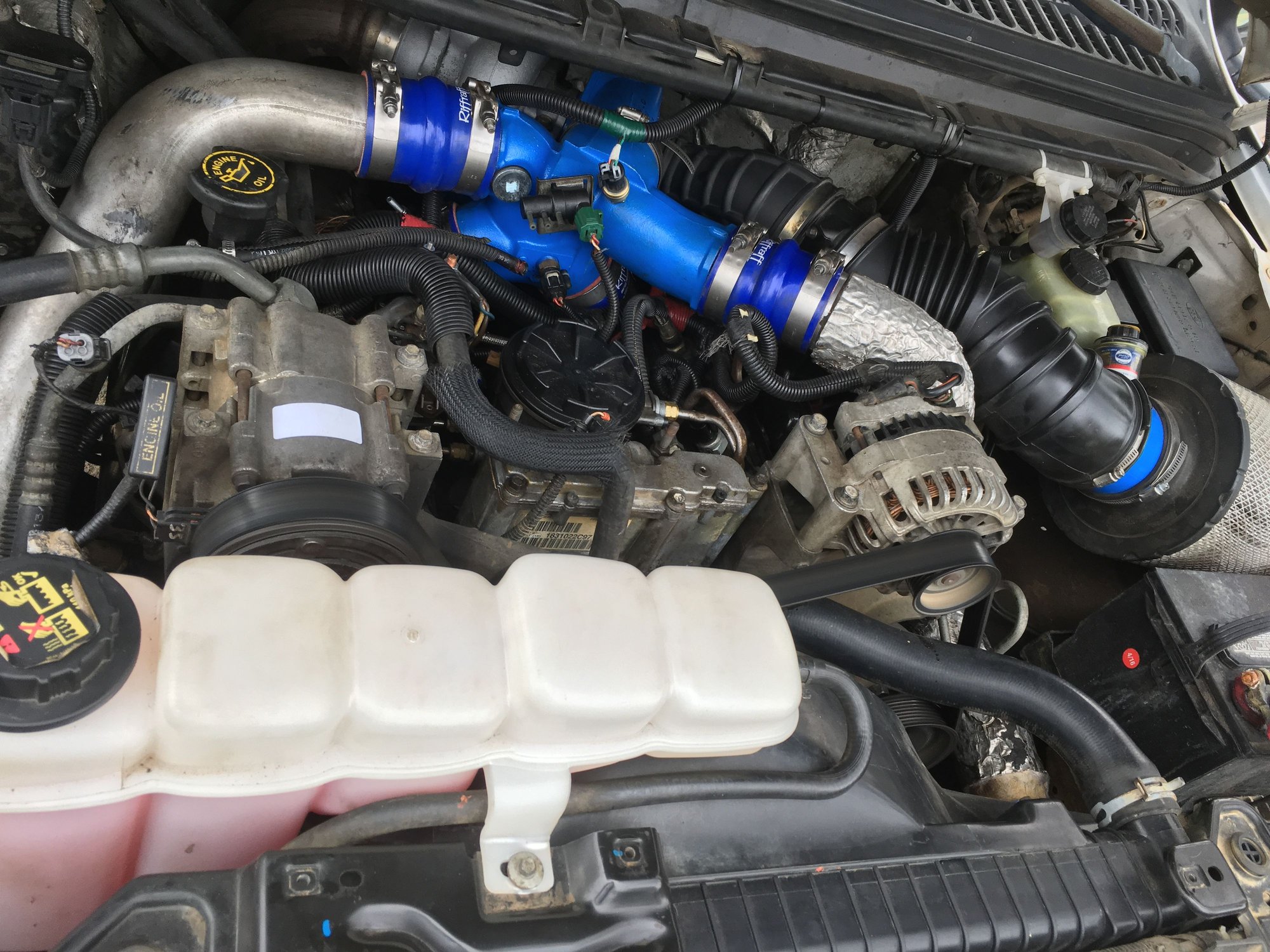

The clamp can wear through the fuel line. He’s saying you should remove the clamp circled below. There’s also one on the driver’s side front that should be removed.
