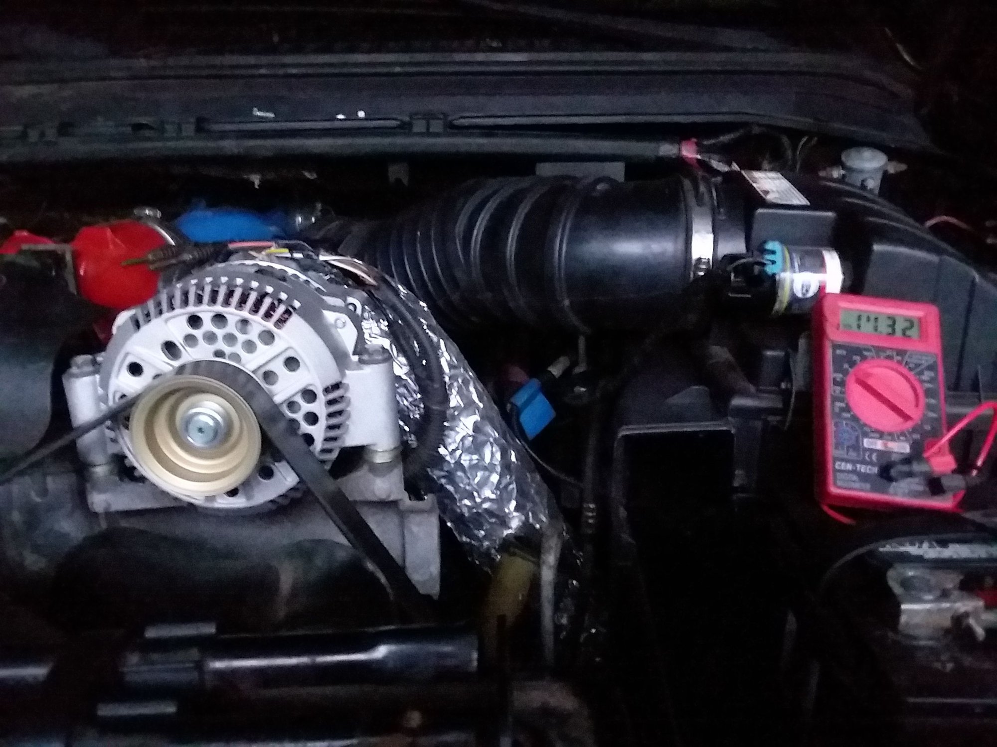

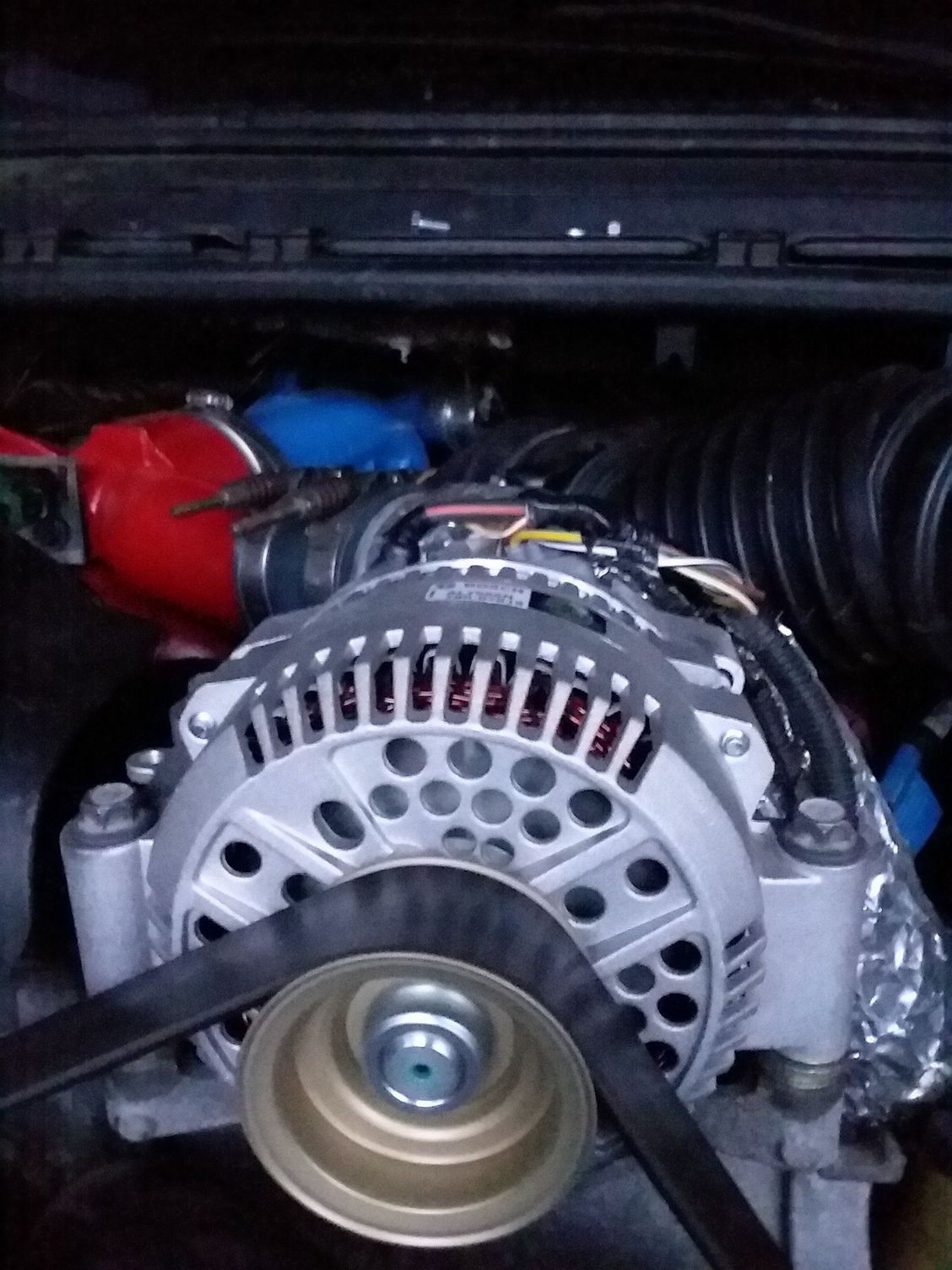

Alternator upgrade is done. Gen 3 and 130 amps. Brand new Bosch from Rock auto around $180 to my front door and no exchange. Had to change the pulley to my old one. Charging nicely now. 14.3 to 14.3 volts. My company had the main pig tail plug and got the stator plug on ebay. The only way we sell them is by 2s so I have an extra. Used 3 extra thick washers to raise the alt from hitting the mount. Soldered the green red wire to the original plug and taped them up good. Left the original plug in in case I'm stuck somewhere and need an alternator fast. All have to to is untape the harness remove the alternator and install a new 110 amp.
Just listed another post that I need the filler piece between the fender and door post on the passenger. Some call it an insulator or silencer. Not available from Ford. Looked all over the net and no luck.

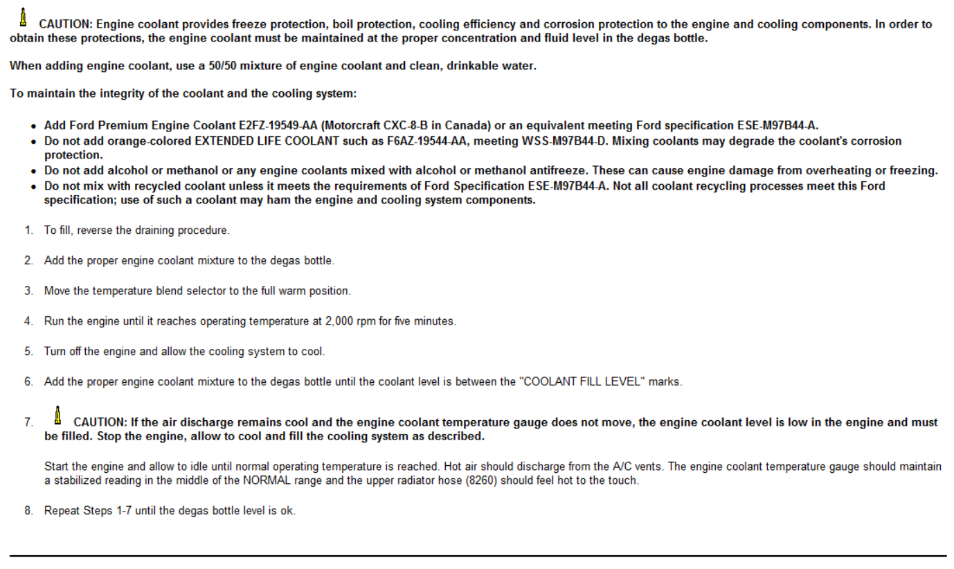

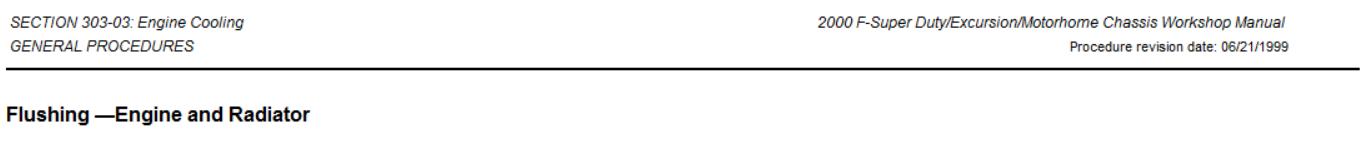

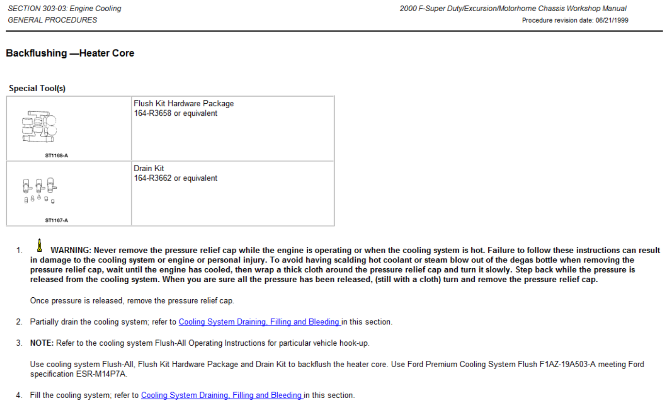

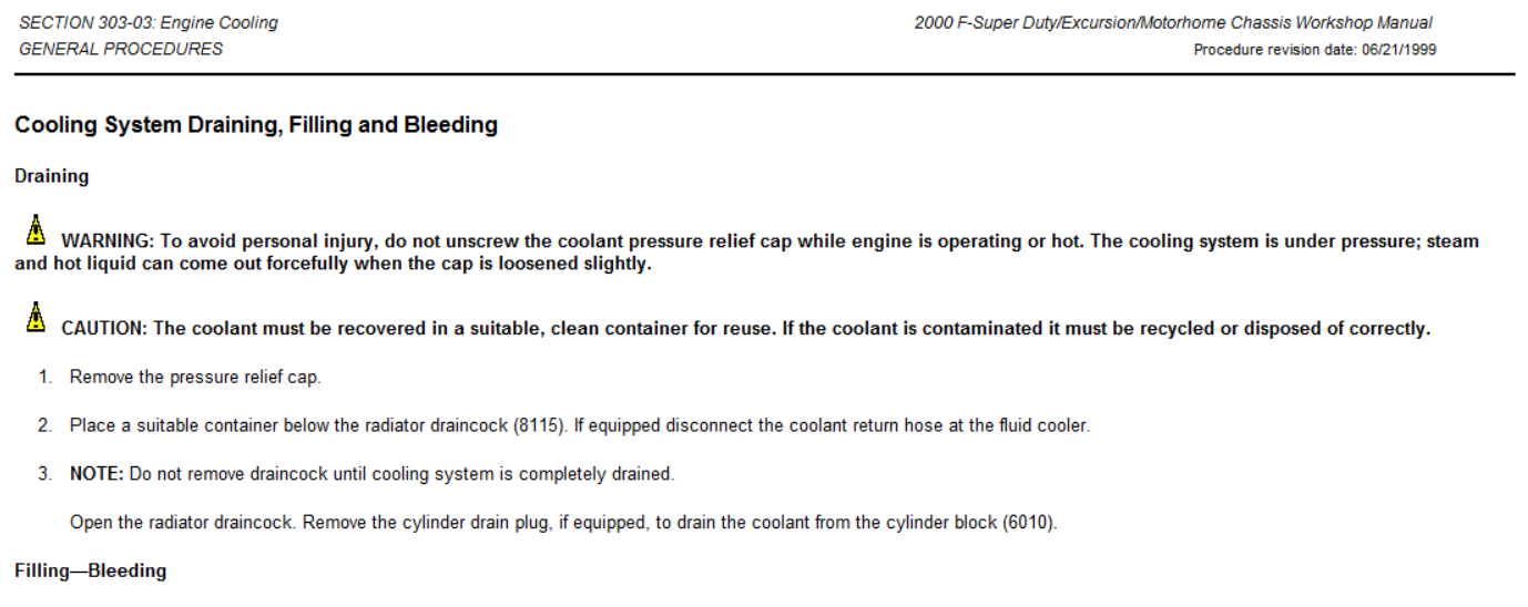

For future reference...
Section 303-03 Engine Cooling in the Ford Service Manual:
